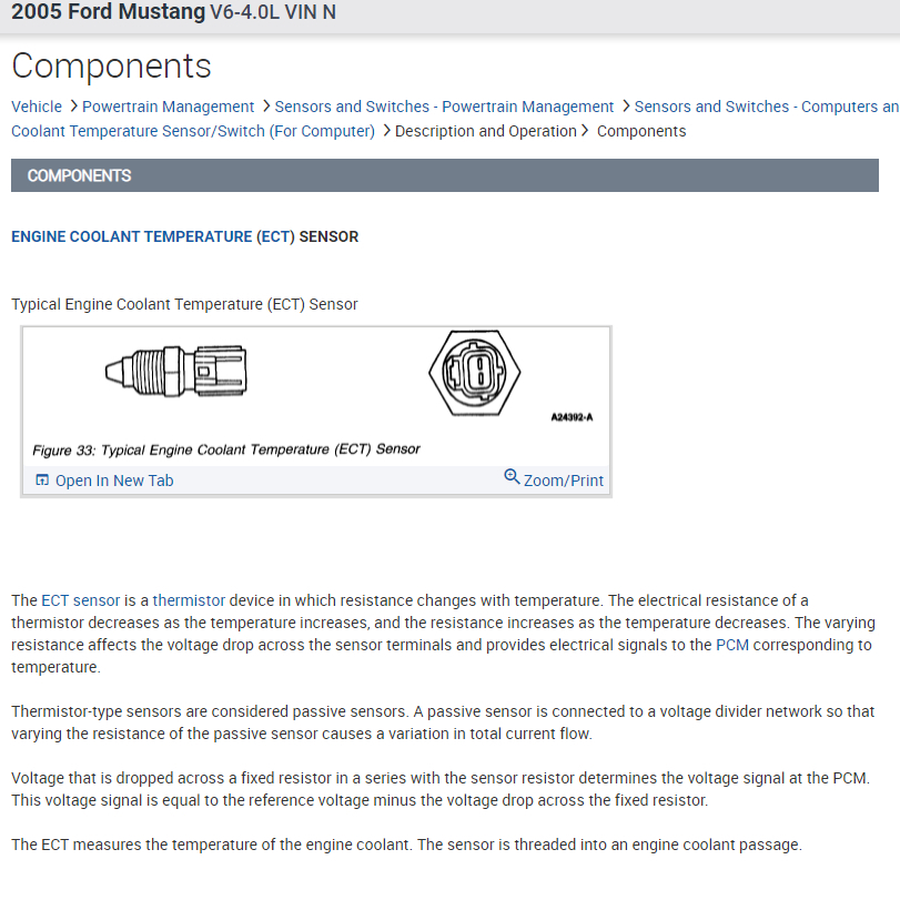

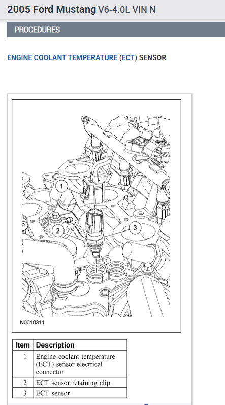

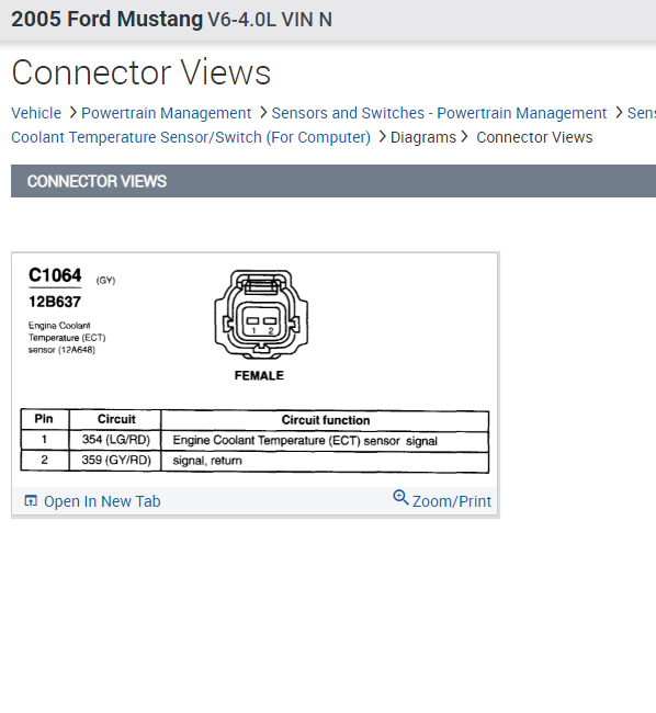

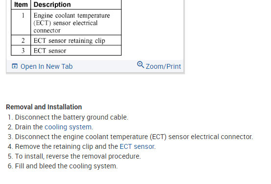

My engine temp gauge does not seem to work where is the sender?
Jul 22, 2010 at 6:35 AM
SQM
CERTIFIED EXPERT
6,383 POSTS
The coolant temperature sensor is located on the top front part of the engine, next to the thermostat housing.
