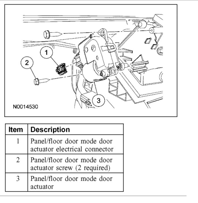

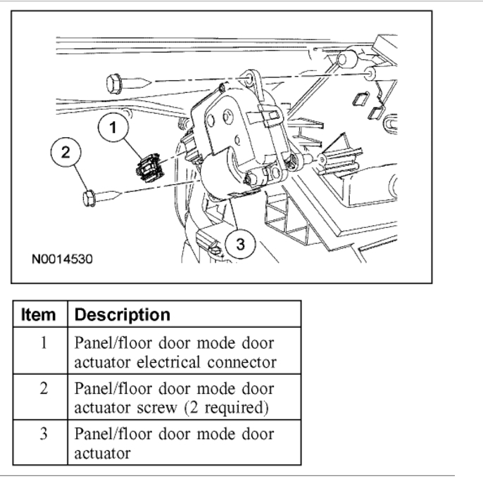

It sounds like you have a blend door actuator that has gone out that controls the mode. Here is a guide the give you an idea of what you are in for when doing the repair.
Here are some diagrams (below) of what it like on your car.
Please let us know what happens so it will help others.
