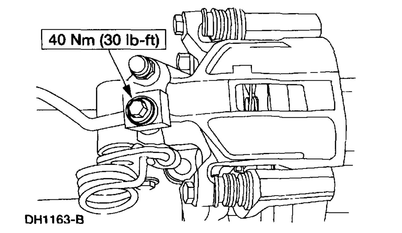

I would suspect the brake hoses may be collapsed. The fluid is not returning to the line and keeping the caliper applied.
Release the banjo bolt at the caliper and the hose where it connects to the steel line.
