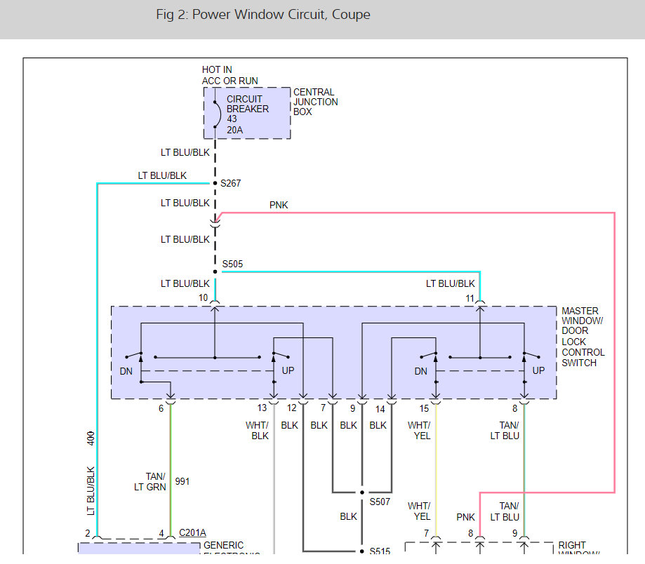

need a diagram for electrical windows for mustang please.

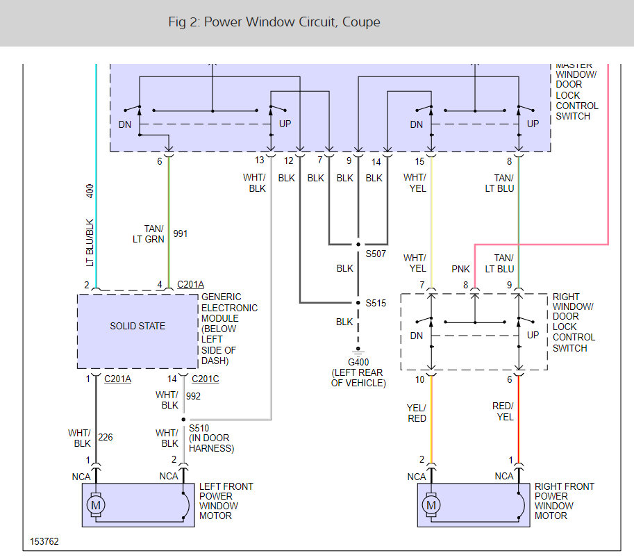

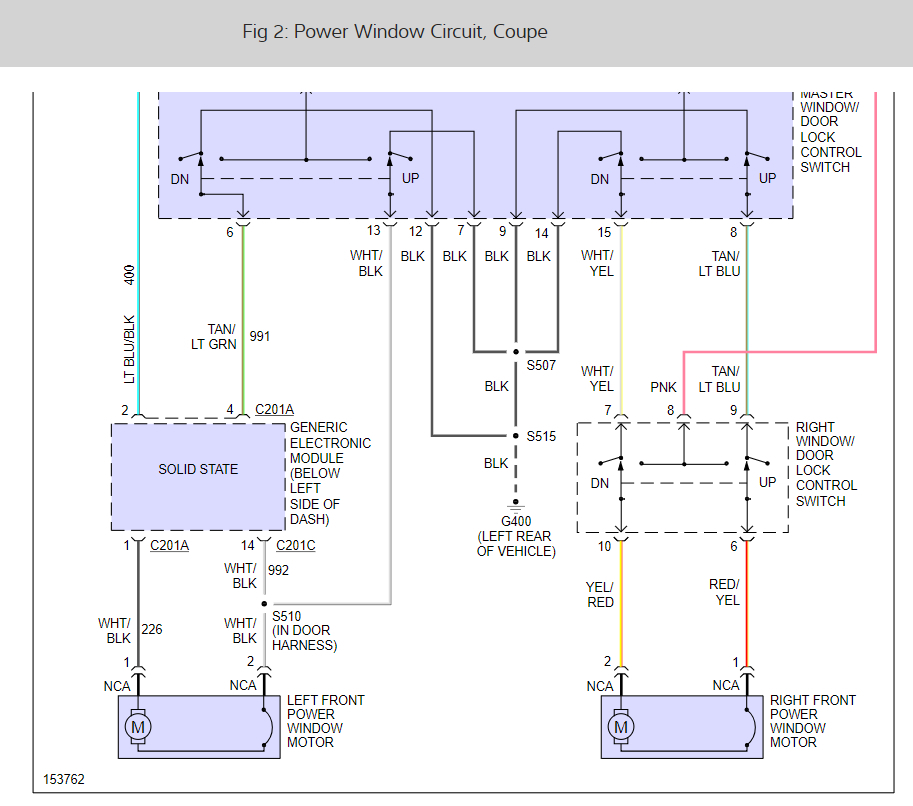

Here is the window wiring diagrams (below) and a guide to help you test the connections.
