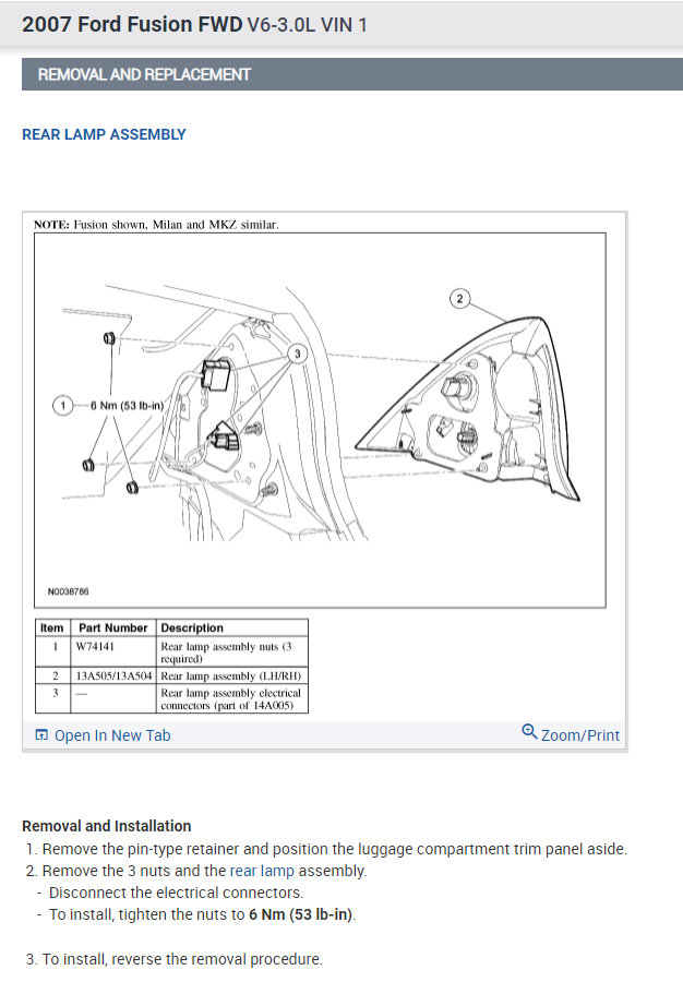

In order to replace the turn signal light on your vehicle you will have to remove the tail lamp assembly.
To remove the taillamp you will have to open the trunk, then remove the carpeting that is behind the taillight.
You will see there are three screws that is holding the light assembly.
Remove those screws to pull out the light assembly.
Turn socket and replace the light.
