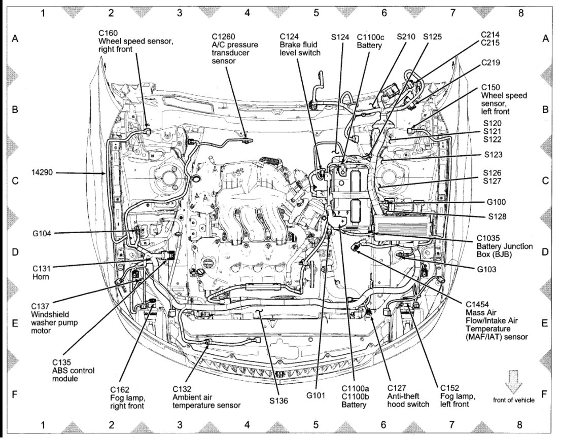

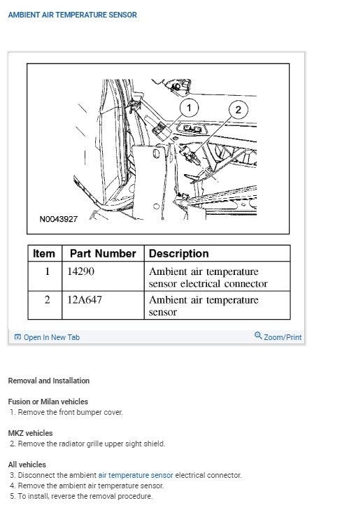

My ambient air temperature sensor is bad and i need to locate it in order to replace it
