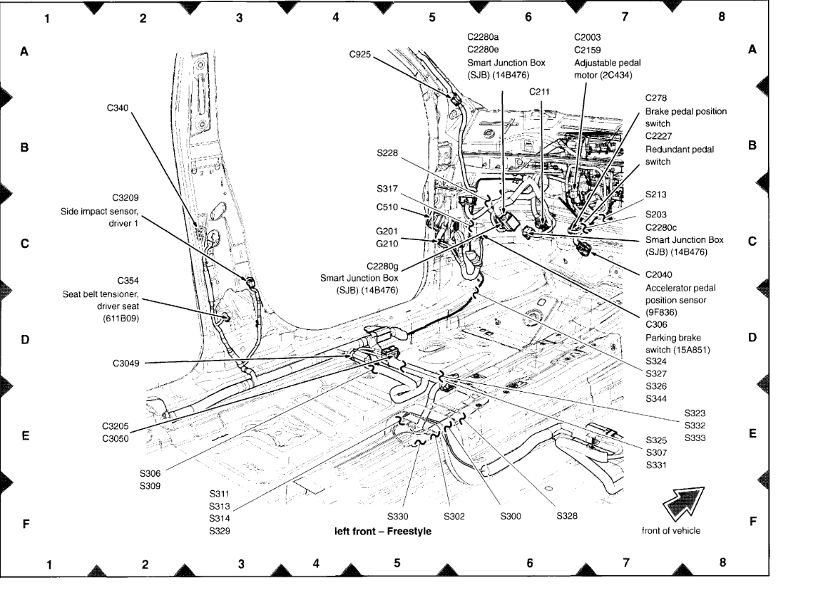

We are getting a code message of P2106....which is showing up as the throttle position sensor but we don't know where that is. Do you know where that is located?

accelerator pedal position sensor is located on the left kick panel, below driver side dash. But that cods up when the throttle bore is dirty puts the car into limp mode here is a guide to help you fix it
https://www.2carpros.com/articles/reduced-power-limp-mode
