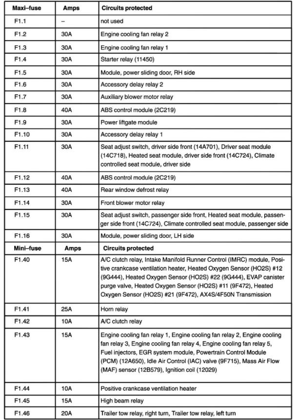

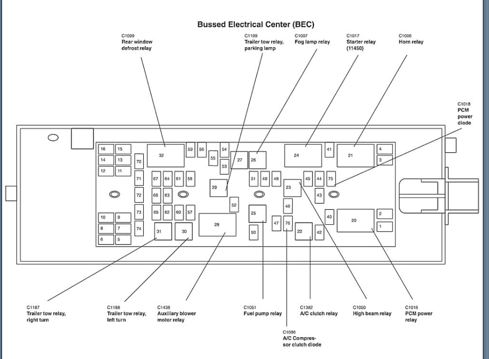

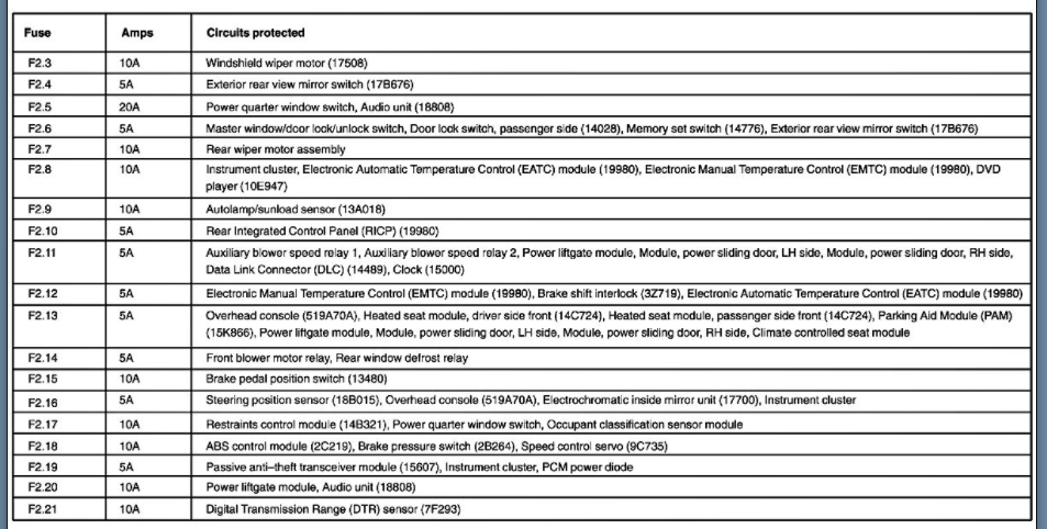

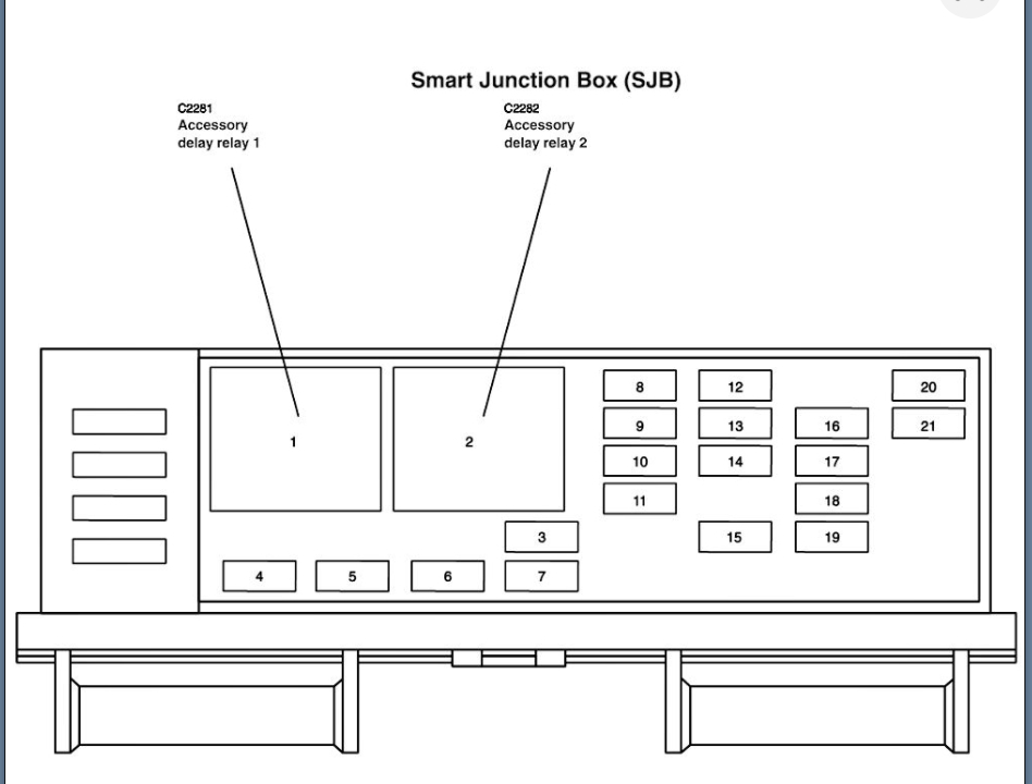

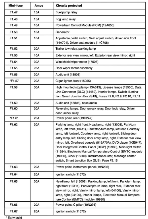

Sure. Here are some guides that will help with the testing of these fuses and relays:
Please see the attached info below for the fuses. Please run through this detail and let us know what you find. Thanks
