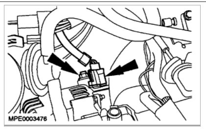

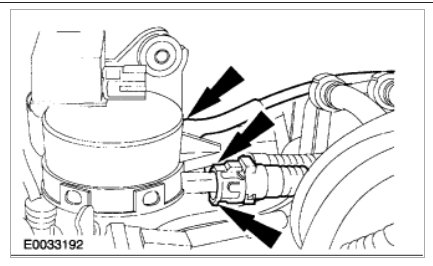

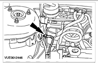

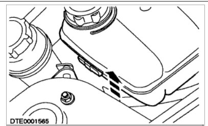

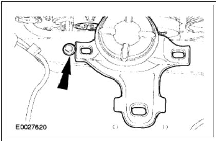

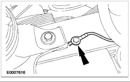

Great addition to this thread! Please feel free to help out whenever you are on the site :)
Here is a guide that gives you an idea of what you are in for when doing the job.
https://www.2carpros.com/articles/how-to-replace-an-alternator
Test the alternator once you are done.
Here are some diagrams below that shows what replacing the alternator is like on your car

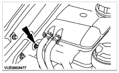

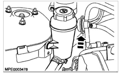

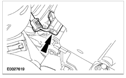

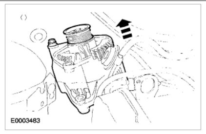

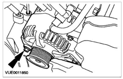

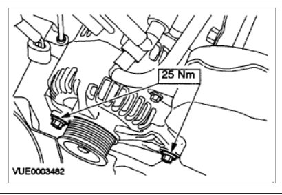

FULLEROPAL
Engine Mechanical problem
2001 Ford Focus 4 cyl Front Wheel Drive Automatic 100000 miles

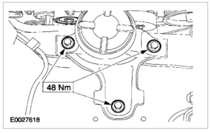

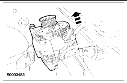

I can't get the old alternator out. Do I have to take the motor out to be able to replace the alternator?
Dec 2, 2017 at 4:12 PM (Merged)
BLUELIGHTNIN6
  • 16,542 POSTS

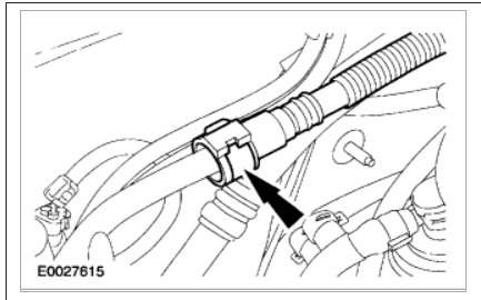

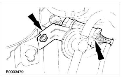

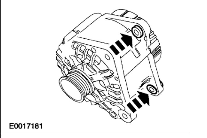

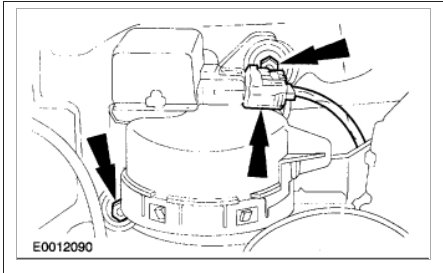

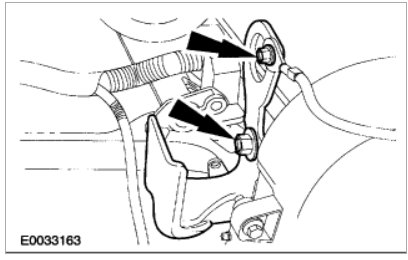

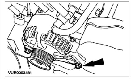

Try these procedures below, also disconnect the right motor mount at the right strut tower to allow extra motor movement, then pull the engine forward enough to allow room to remove the alternator from the top.
https://www.2carpros.com/forum/automotive_pictures/261618_Noname_671.jpg
https://www.2carpros.com/forum/automotive_pictures/261618_Noname2_170.jpg
https://www.2carpros.com/forum/automotive_pictures/261618_Noname3_64.jpg
