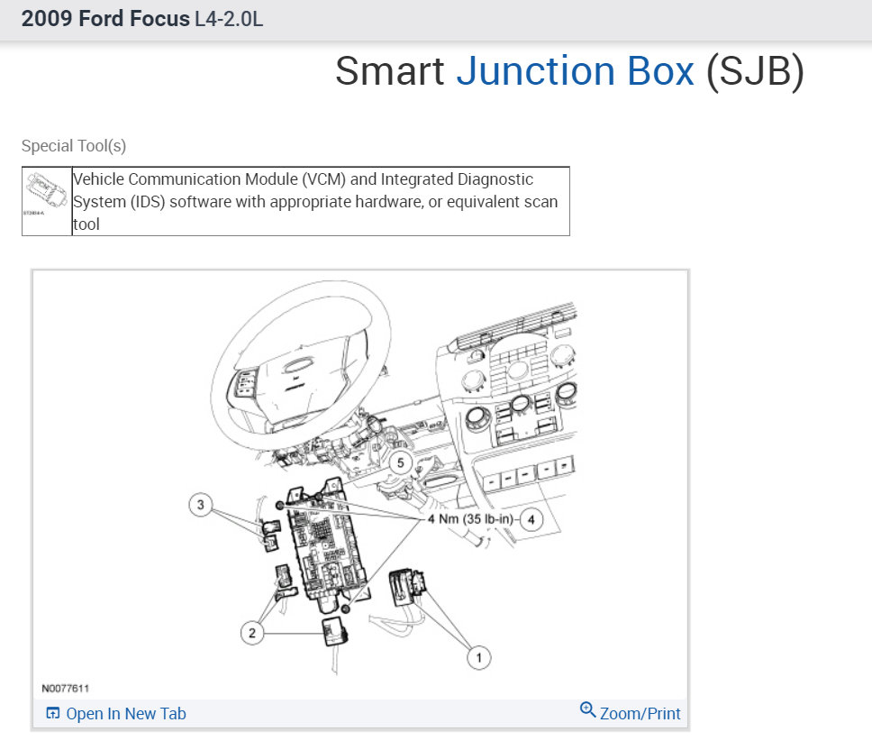

This is common when the smart junction box goes out, it supplies power to the accessories that are not working. To confirm the issues, use a test light to see if the fuses are getting power. This guide can help:
Here are the location and instructions on how to change it out. Check out the diagrams (below). Let us know what happens and please upload pictures or videos of the problem.

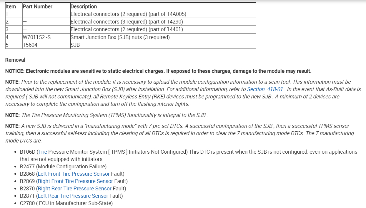

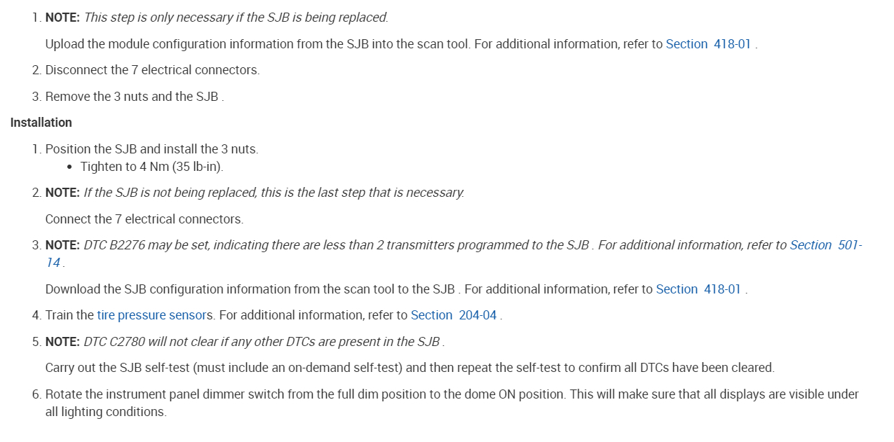

Thank you. Does the smart module need to be programmed to the car or are they universal? thank you.
May 9, 2022 at 6:51 PM
When looking at the diagrams above it says you need to reprogram it.
