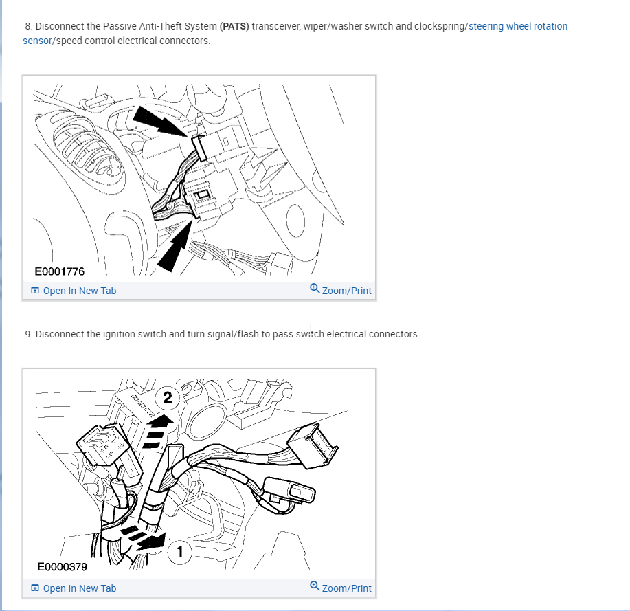

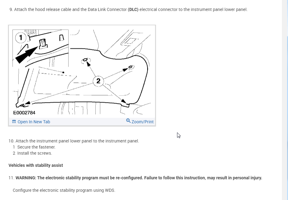

I have the car listed above SE model. there's a clicking noise every now and it sounds like it's coming from the steering column. Every now and then the car will shut off at a red light or it will hesitate to accelerate. Check engine light is on and I've had it tested at O'Reilly's and they're saying it's an air leak somewhere that is the only code is giving off
