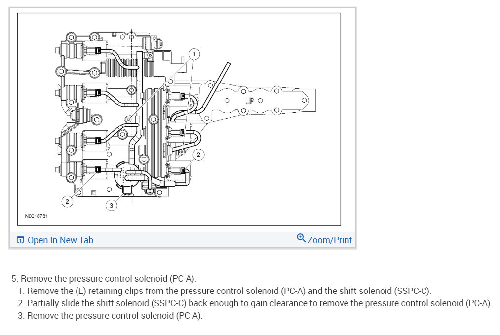

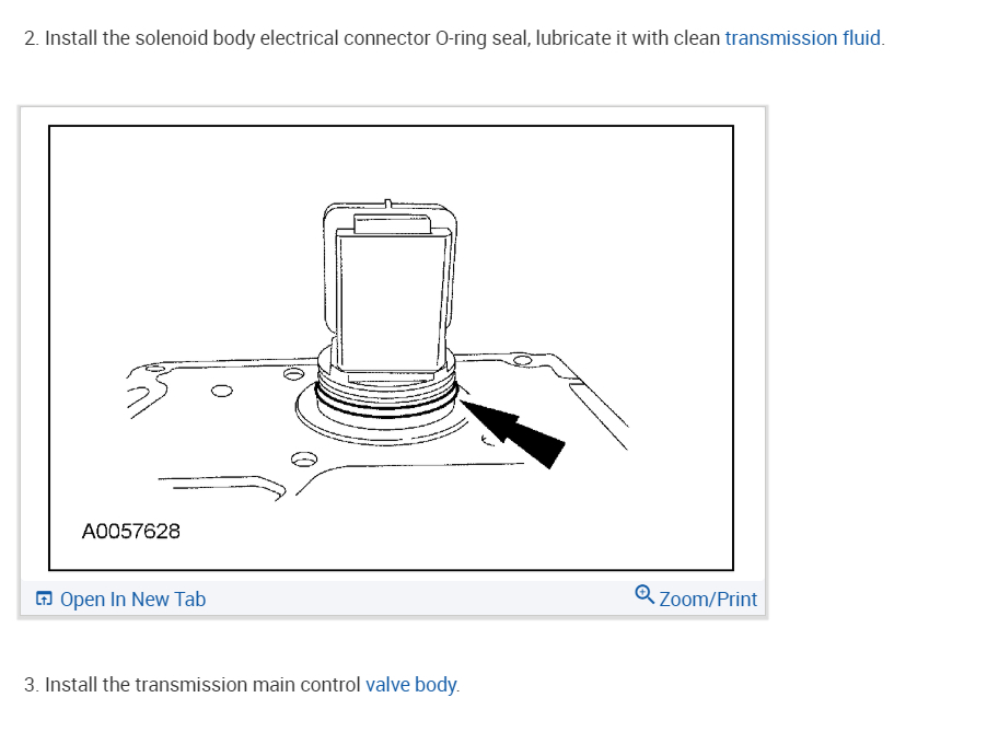

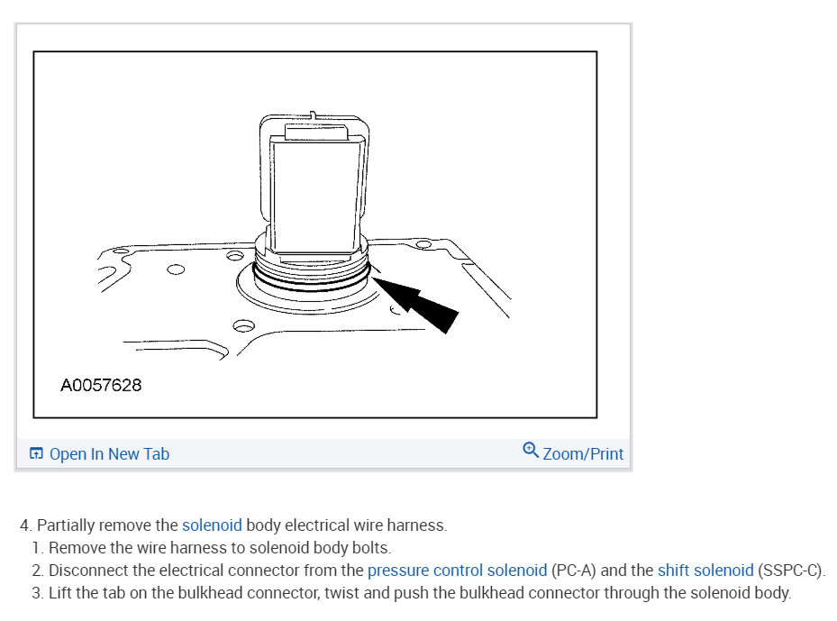

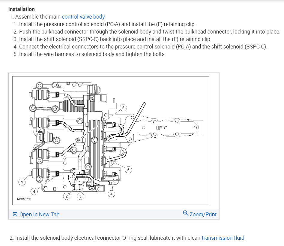

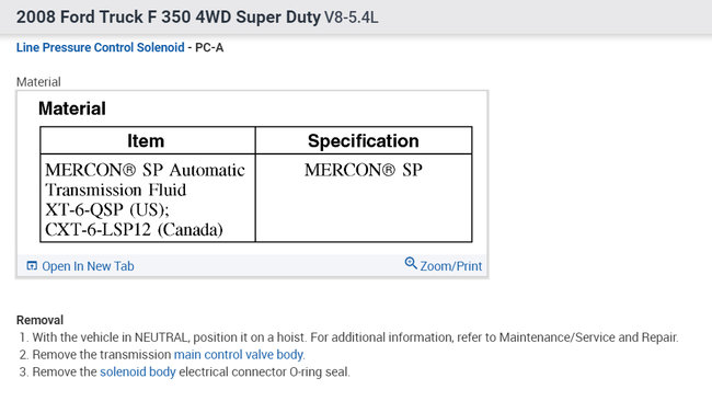

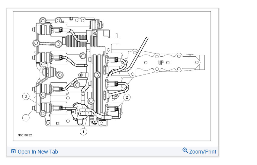

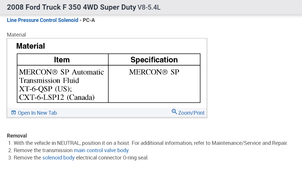

If you put the truck in gear does it even try to move, what about reverse. If it moves forward a little bit but you have to rev it high than most likely the trans is shot, Is the fluid dark and smell burnt.If it doesn't do anything make sure it is not something disconnected like the linkage or t-case in neutral. It sounds like the line pressure control solenoid is out or not connected here is the location so you can check it out. Check out the diagrams (Below). Please let us know what you find. We are interested to see what it is.

The truck doesn't move at all, even if rev it up and the fluid is not dark it looks almost new. I dropped the pan to check for metal and didn't see any. So I removed line solenoid and it looked okay, so I got a new one and put it back together and it worked! thanks for the suggestion, can I give you some money somehow?
