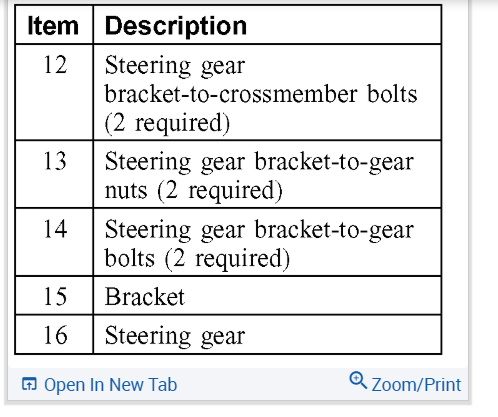

I really don't know what to say on this I have gone over tsb's prior to answering your question only thing I can say is to have a pro look for binding or maybe scan for codes see if something comes up on it. If it is the original gear box i'd have to say something with the hydraulic valve in it but not really sure.the only thing I can suggest now is to check the items in the pic as well as mesh preload which whoever rebuilt this will know what that is. If it still doesn't cure it replace the box. Unless it was replaced when it was rebuilt as it may be one of the items in pic causing the problem.

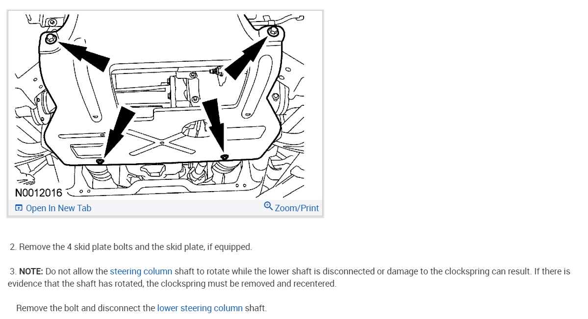

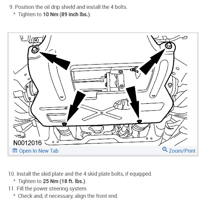

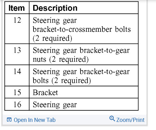

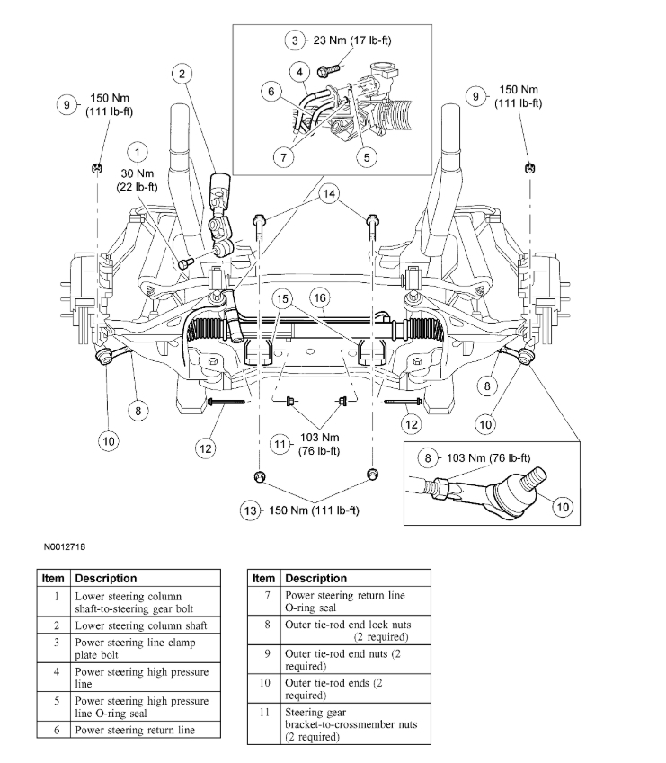

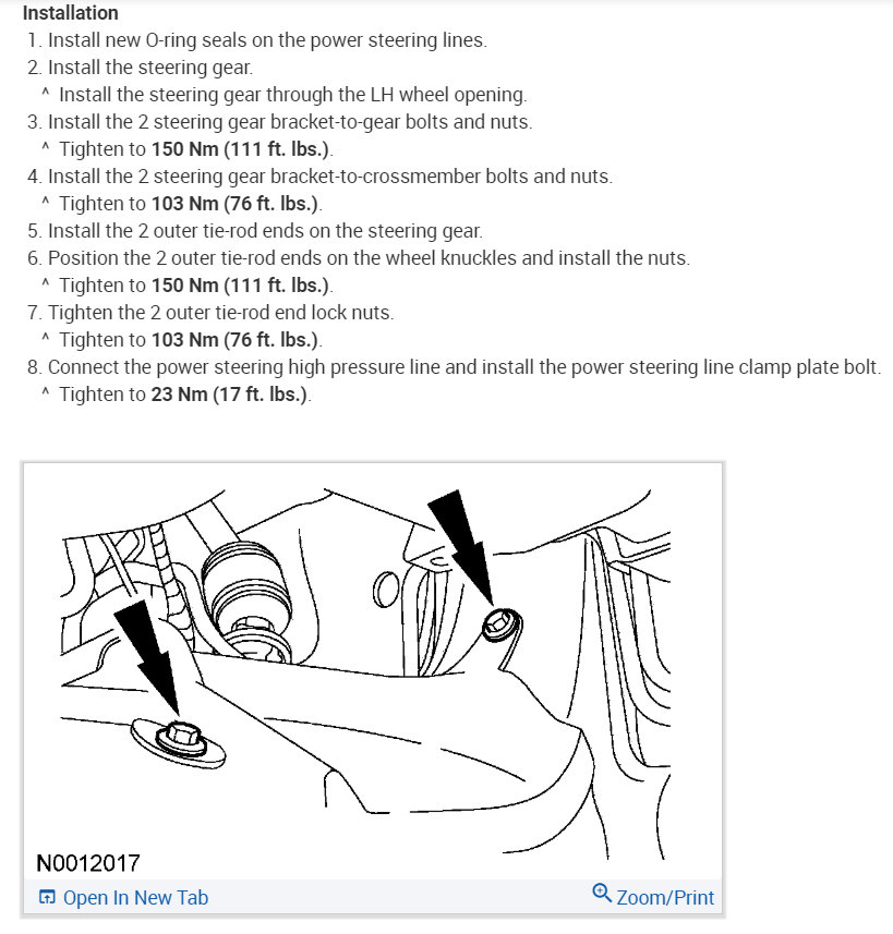

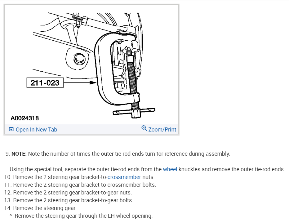

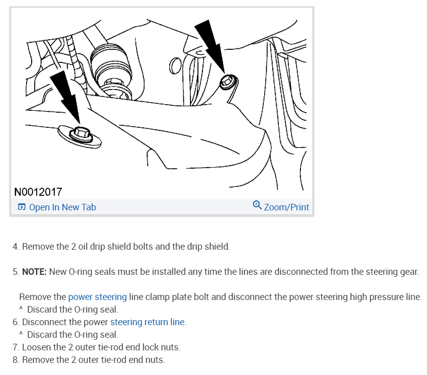

This can be either a ball joint going out or the steering rack, I would disconnect the tie rods from the spindles and move the steering by hand to see if you can feel the resistance if all checks out replace the rack here is how in the diagrams below with a guide to show you how to remove the tie rods from the spindles.
https://www.2carpros.com/articles/tie-rod-end-replacement
Check out the diagrams (Below). Please let us know what you find. We are interested to see what it is. Lube the front end if zirks are present.
