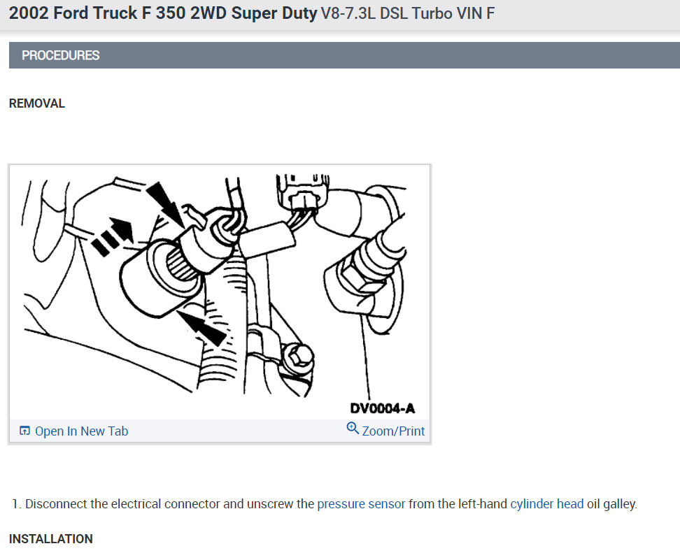

where do I find the oil pressure switch on the truck listed above 7.2 diesel engine?

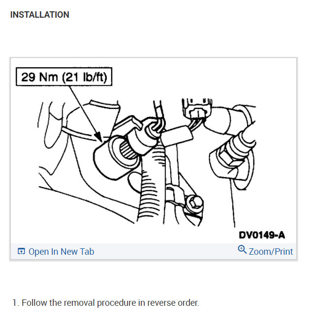

the oil pressure sensor is located on the left cylinder head oil galley. Here are the instructions and location so you can replace it. Check out the diagrams (below). Please let us know if you need anything else to get the problem fixed.
