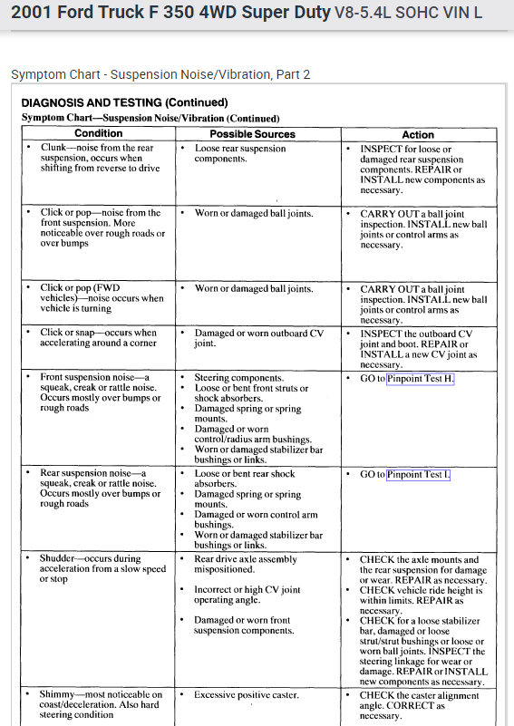

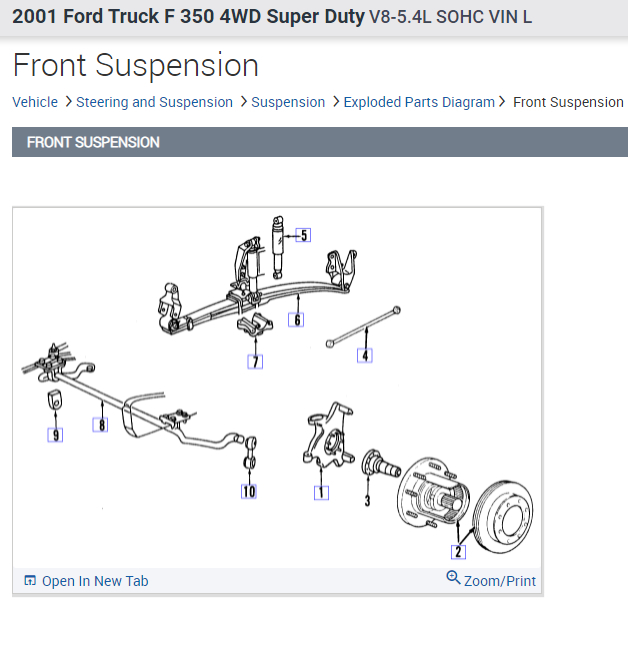

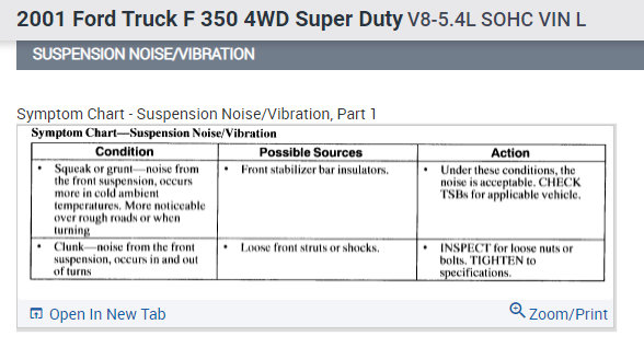

The noise can be from number to different components of the suspension.
The best course of action would be to do a thorough inspection of the suspension components as well as the front drivetrain.
Look for any excessive wear or broken parts. This noise could be due to a worn-out control arm or a damaged busing.
Here is a helpful article that covers the basics:
https://www.2carpros.com/articles/popping-noise
