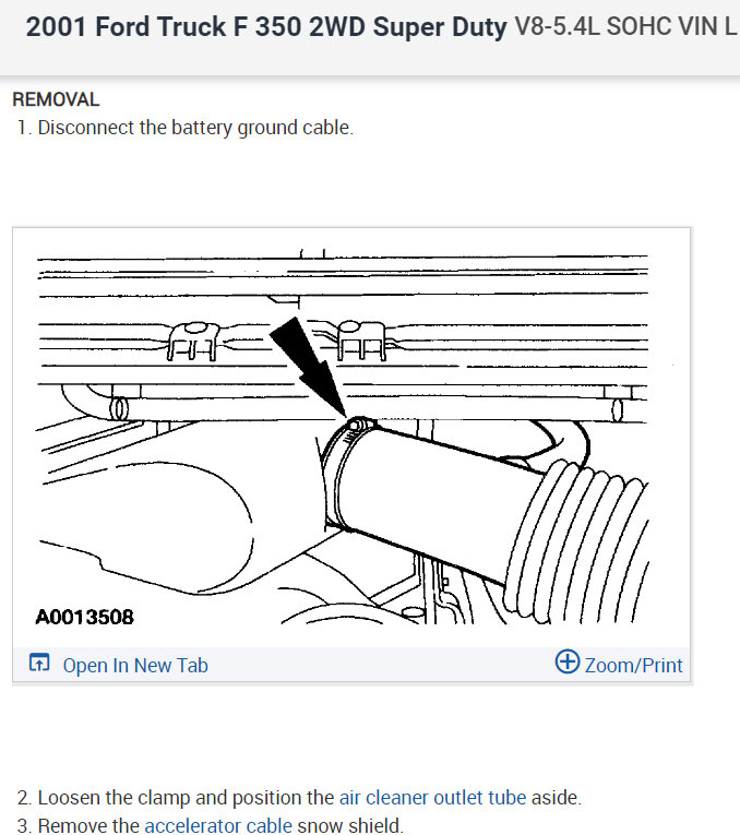

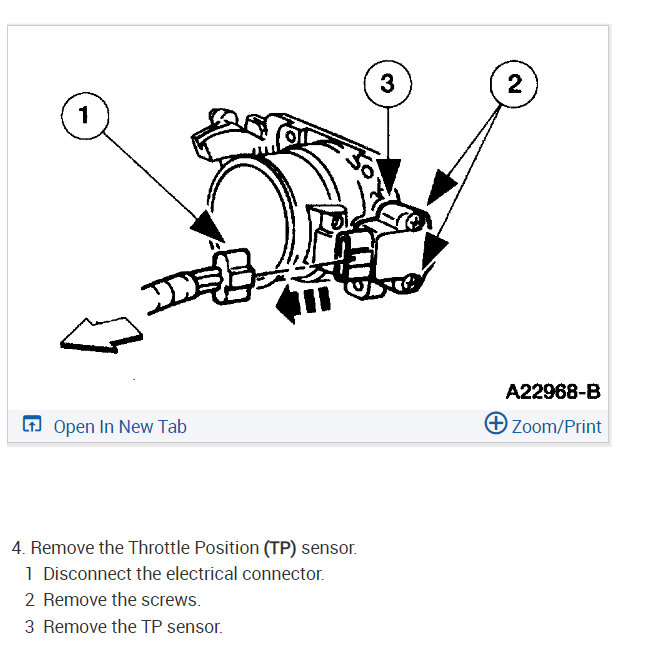

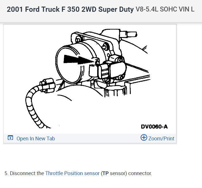

Yep, the TPS needs to be replaced because the truck is in limp mode, we should run the codes first though. here is a guide to help to make sure we are on the right track:
Here is a guide on limp mode which can help as well:
https://www.2carpros.com/articles/reduced-power-limp-mode
