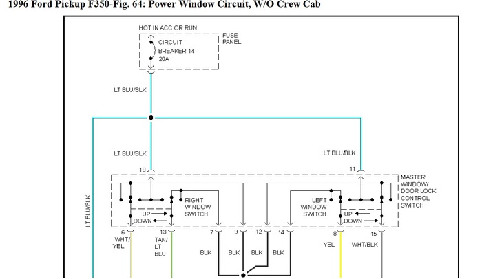

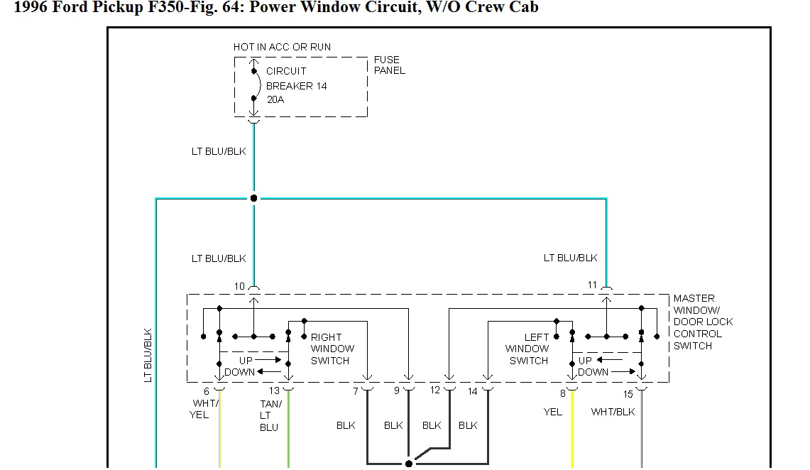

The windows do not roll down and windshield wipers do not work and dashboard does not work how much would it be to fix it.
Dec 31, 2016 at 5:12 PM (Merged)
do not even know what is wrong.
i would start with checking all fuses. use a test light and check for power on both sides with key on.
start there.
JDL
  • 16,098 POSTS
I agree with Roy. Just take one system at a time and check voltage and ground.
The diagram is for power windows without crew-cab. Do not mean to butt in, I had already copied the diagram, might as well post it.
