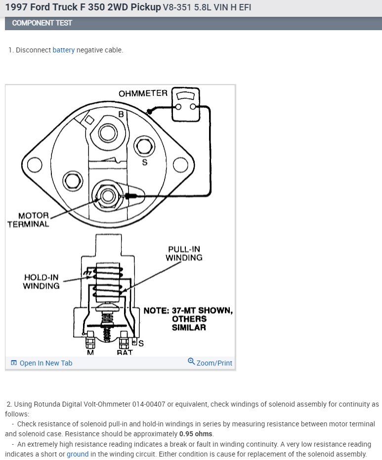

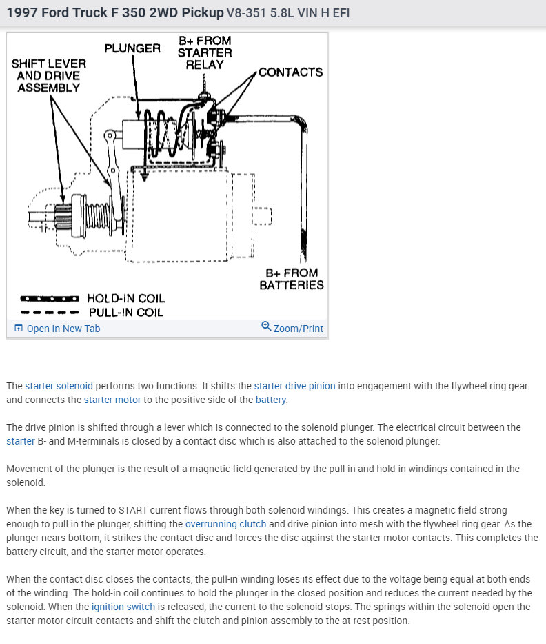

It sounds like the starting issue is due to a faulty starter solenoid. As you are able to start it by crossing the solenoid posts, it means there is a malfunction within the solenoid.
https://www.2carpros.com/articles/how-a-starter-and-solenoid-works
