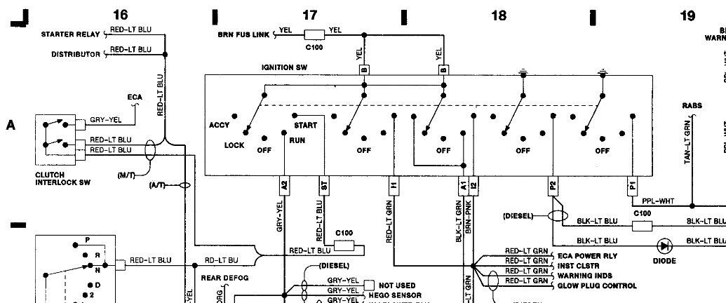

KEY LOCK CYLINDER WAS SLOPPY WHEN I BOUGHT THE TRUCK LAST MONTH.
YESTERDAY,I TURNED THE KEY & NOTHING HAPPENED. I CHECKED THE IGNITION SWITCH & CONNECTOR,FUSES & KEY LOCK CYLINDER. I REPLACED THE ABOVE WITH NEW PARTS...AND...IT'S STILL DEAD. THE TRUCK WILL CRANK BUT OUTSIDE SOLENOID BUT WON'T STAY STARTED DUE TO NO POWER TO IGNITION.
THE HEADLIGHTS, EMRG FLASHERS,AND BRAKES LIGHTS ALL HAVE POWER... BUT...NO POWER TO THE IGNITION SWITCH. TESTED WITH TEST LIGHT. MY OWNER'S GUIDE NOTES AN 18 GA. FUSE LINK THAT PROTECTS THE IGNITION SWITCH & PANEL FEED BUT IT DOESN'T GIVE A LOCATION. THE TRUCK HAD BEEN RUNNING AND STARTING FINE BUT NOW NOTHING IS HAPPENING..NO STARING DASH LIGHTS, NO BUZZERS, NO CLICKING, NOTHING......PLEASE HELP!!
also,looks like this same question has been posted once before...and i'm wondering is this is a common problem with this model??
THANKS IN ADVANCE
