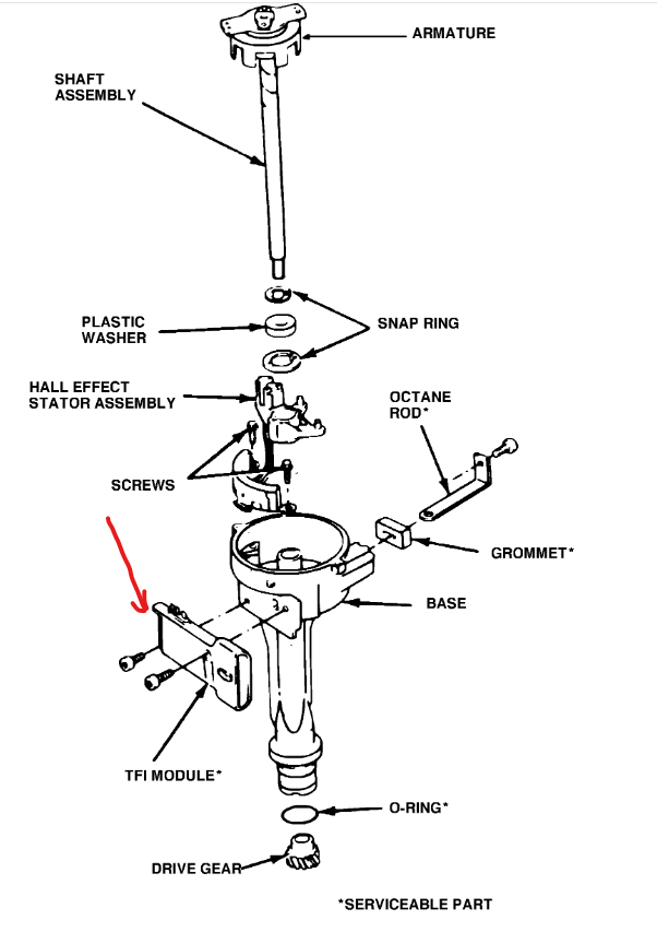

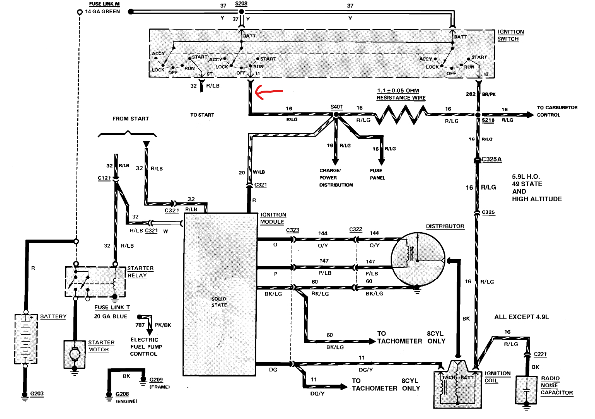

You have a problem with the wiring at the ignition switch,the red/green wire must be broken, or the ignition module needs to be replaced, here is the ignition switch wiring diagrams so you can see what I am talking about and the location of the ignition module so you can swap it out. This guide can help test the wiring.
Check out the images (below). Let us know how it goes
