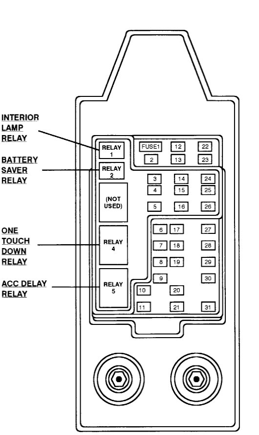

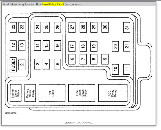

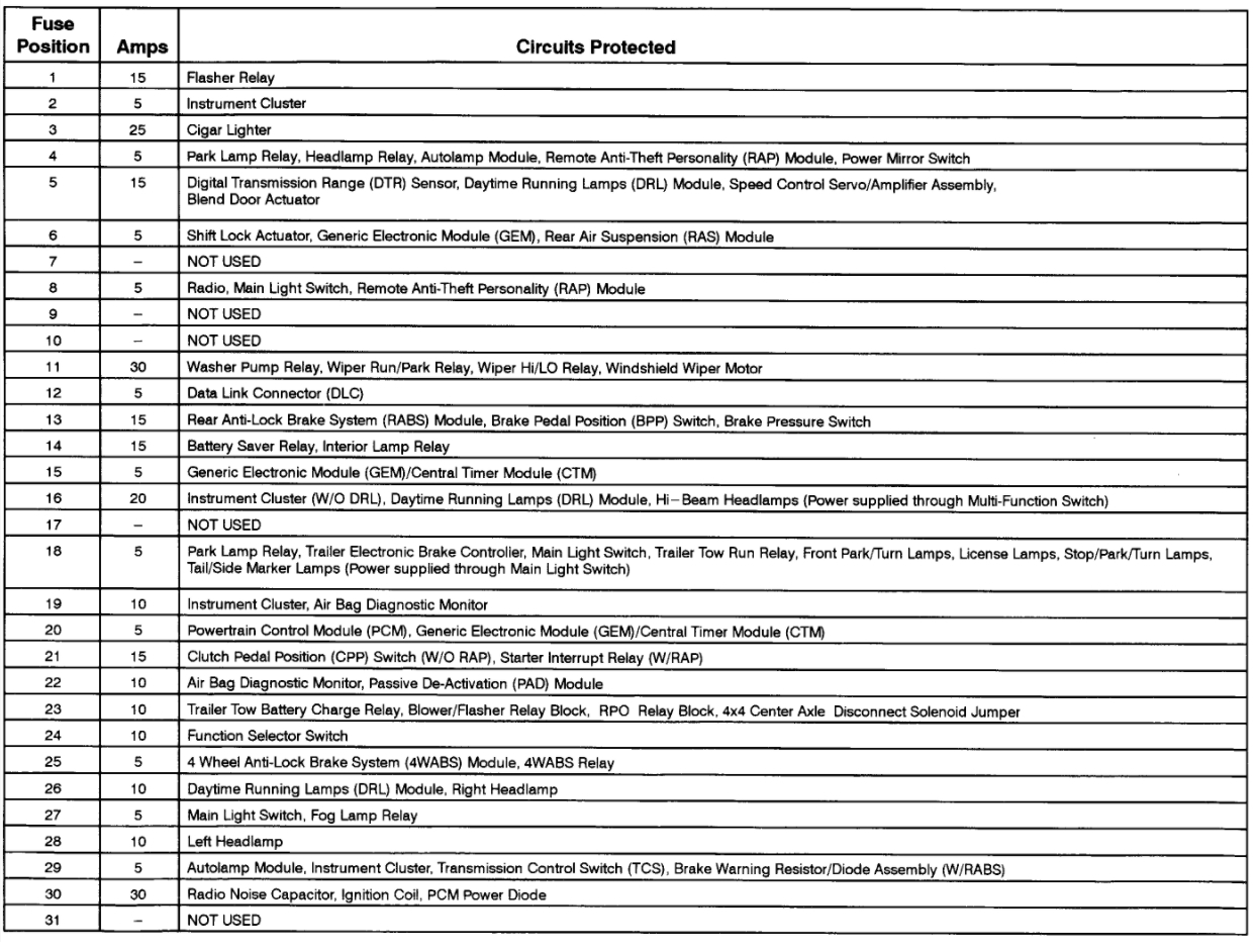

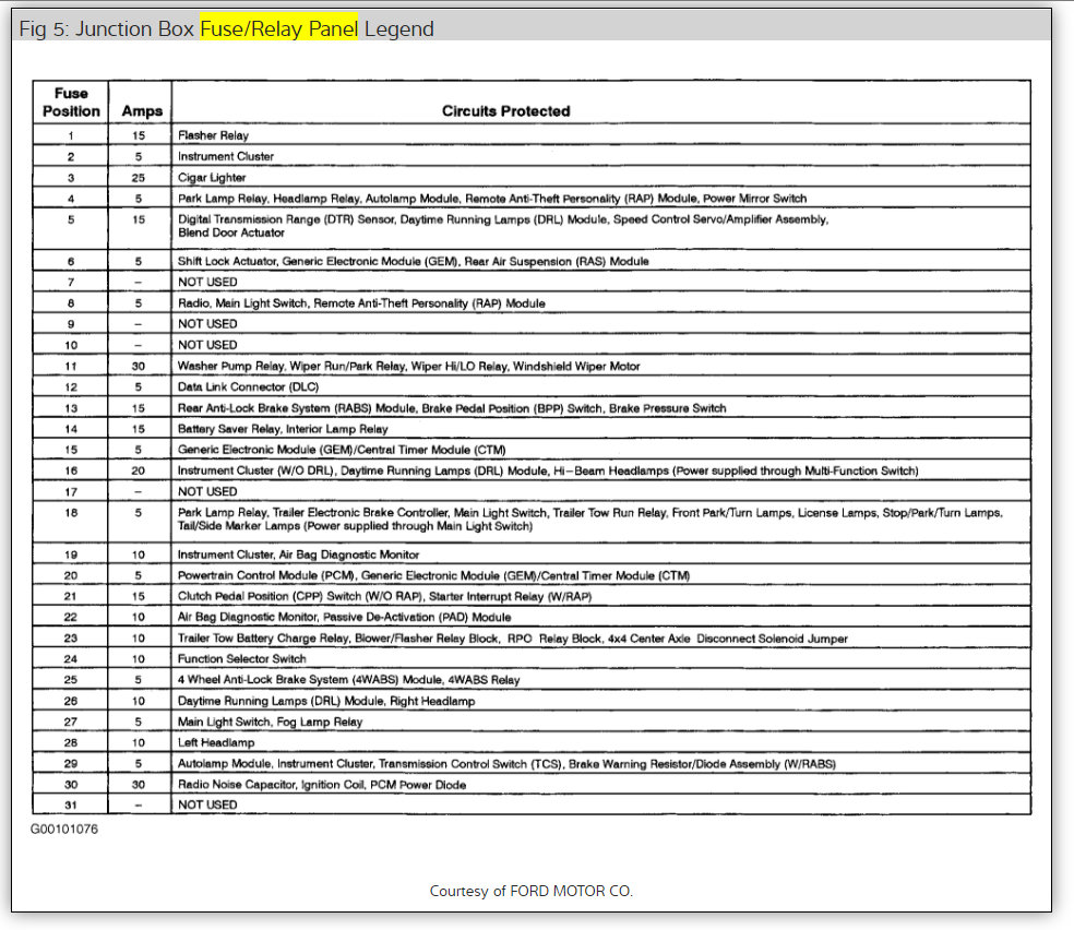

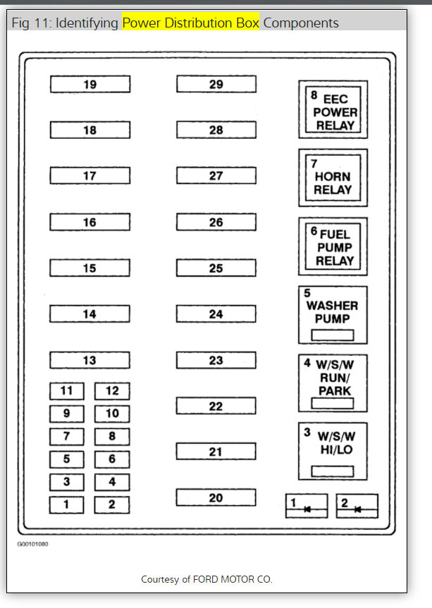

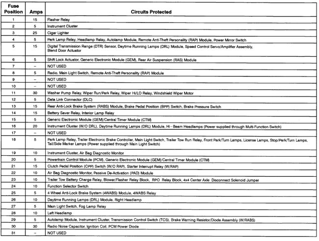

Yep you should start with the fuses, here is a guide to help you see what to do.
Jan 30, 2018 at 4:28 PM
REDJESS
Thank you it was fuse #2 15 amp. This site is the best!
