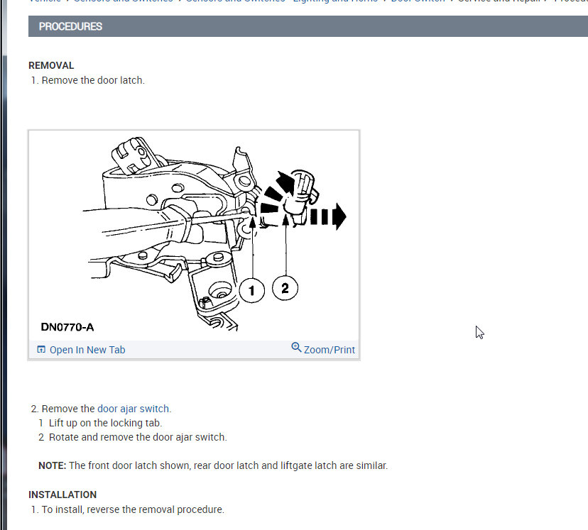

My truck's "door ajar" light is remaining on even though the doors are closed. Before this problem occurred, I was able to remain in the truck after shutting off the ignition, and could raise and lower the windows, and the radio would remain on until the door seal was opened.Now I am experiencing the door ajar constantly, and when setting the truck alarm responds with two beeps, indicating an opened door.
I recently took of all 4 door panels, and "wiggled" all the wires and switches to no avail.
Anyone have any ideas/comments?
