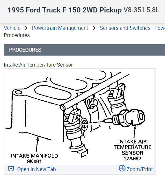

I have a 95 F150. I need to chance the air charge sensor. Does the intake need to be removed to do this? Thanks, David.

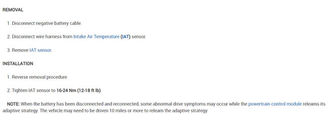

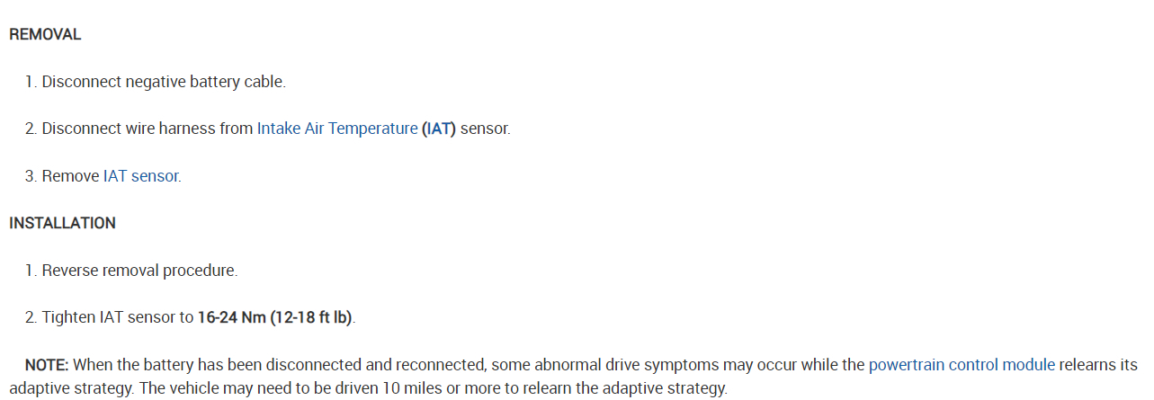

Nope. here is the location of the sensor and the instruction on how to change it out. Check out the images (below). Let us know if you need anything else.
