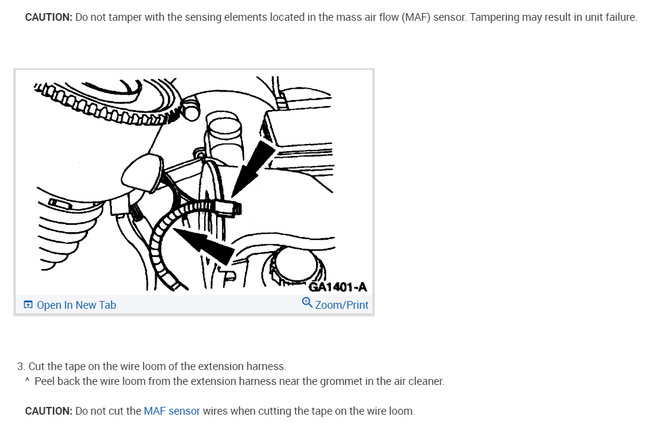

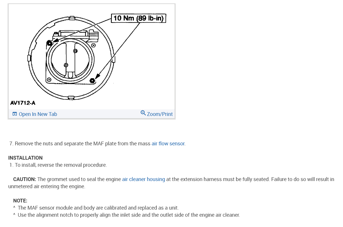

A few culprits for the change in fuel consumption could be; a leak in the exhaust near O2 sensor, a bad O2 sensor, catyltic converter needs replacement, needs general tune-up, ECU or sensor malfunction but 9 times out of ten it will be the MAF sensor
https://www.2carpros.com/articles/how-to-replace-a-mass-air-flow-sensor-maf

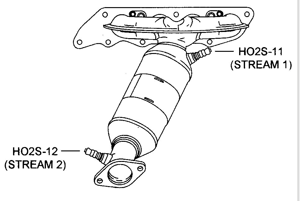

Exhaust got pulled off and now I put mufflers on it but o2 sensors are not working. so I unhooked them . it sounds like it only running on four cylinders and get about six miles to the gallon.
Sep 3, 2020 at 2:20 PM (Merged)
JOETECHPRO
  • 705 POSTS
Hey JD EDWIN,
The original exhaust was damaged so you replaced it?
You will need O2 sensors connected for the engine to run properly, the before catalytic converter O2 sensors are vital to correct engine running.
Are the O2 sensors you disconnected before or after the catalytic converter? If they are before the catalytic converter you will have to reconnect them and ensure they are working first.
The picture attached shows the before catalytic converter (stream 1) and after cat (stream 2).
Do you still have catalytic converters fitted?
Any more information would be great.
Regards, Joe
JD EDWIN
No, I do not have the catalytic converter. the 02 sensors are before the sensors. Is there anyway to make it run right without the catalytic converter on it?

If I can help out. I have seen the MAF sensor go bad causing this issue which will cause the O2 issue as well. I would replace the sensor with a new unit these are normal service items. Here is a guide to help walk you through the steps with instructions in the diagrams below to show you on your car:
Mass Air Flow Sensor - YC2Z12B579BARM $264.51
