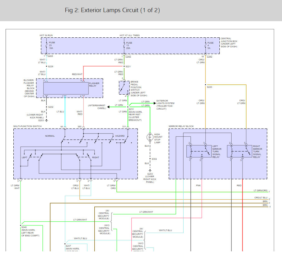

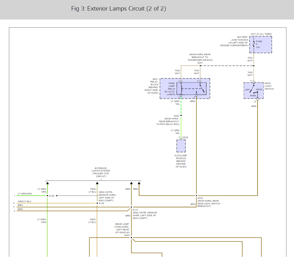

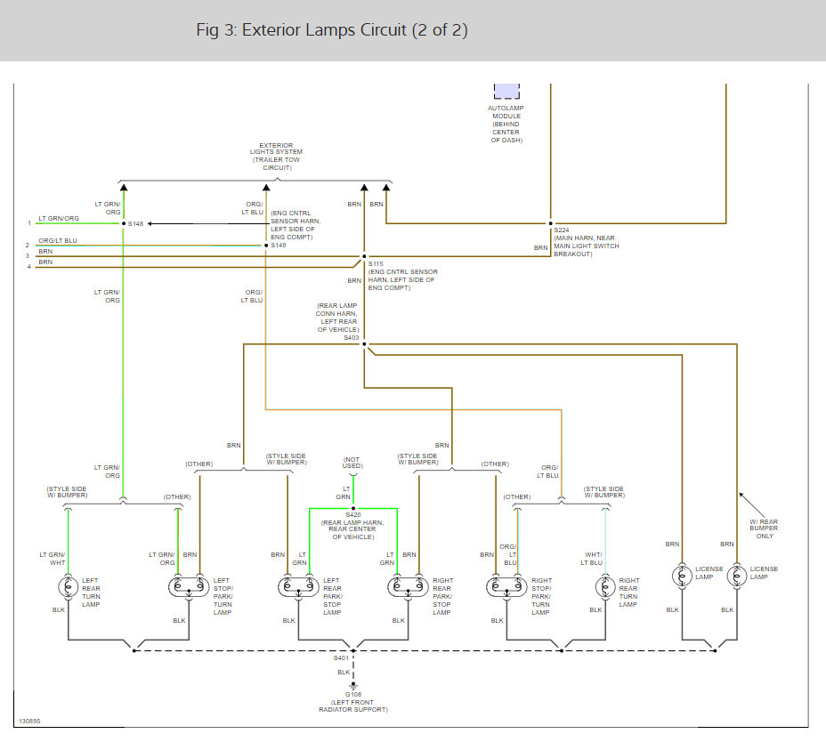

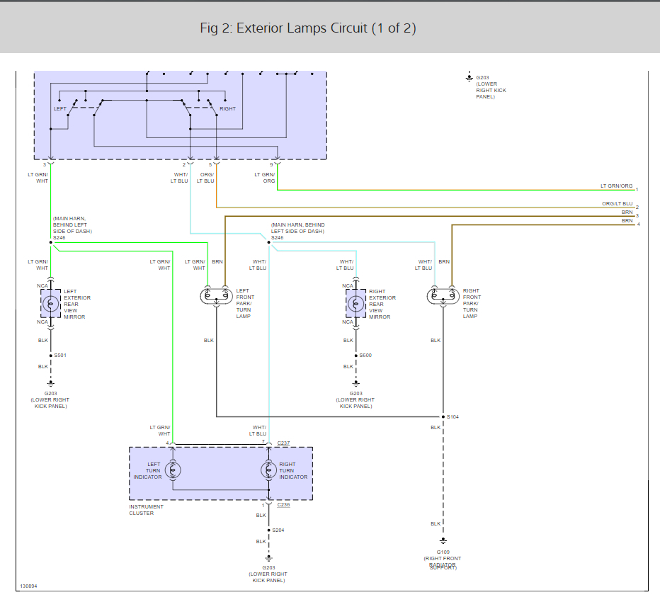

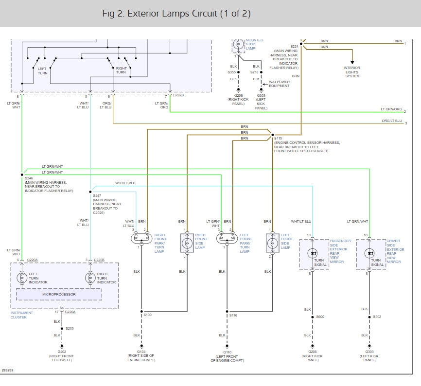

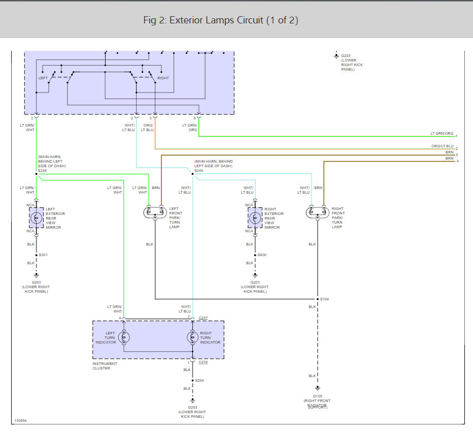

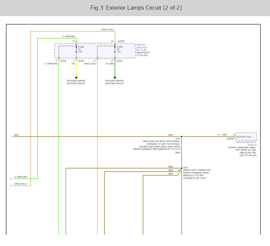

Hi Robert ,

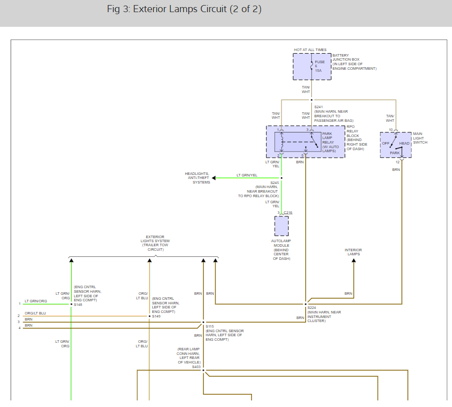

It sounds like it could be the headlight switch but to be sure lets check the fuses and run down this guide to get started.
https://www.2carpros.com/articles/no-tail-lights-exterior-running-lights-tail-lights-out
Here are the running light wiring diagrams so you can see how the system works. Check out the diagrams (Below). Please run this test and get back to us.

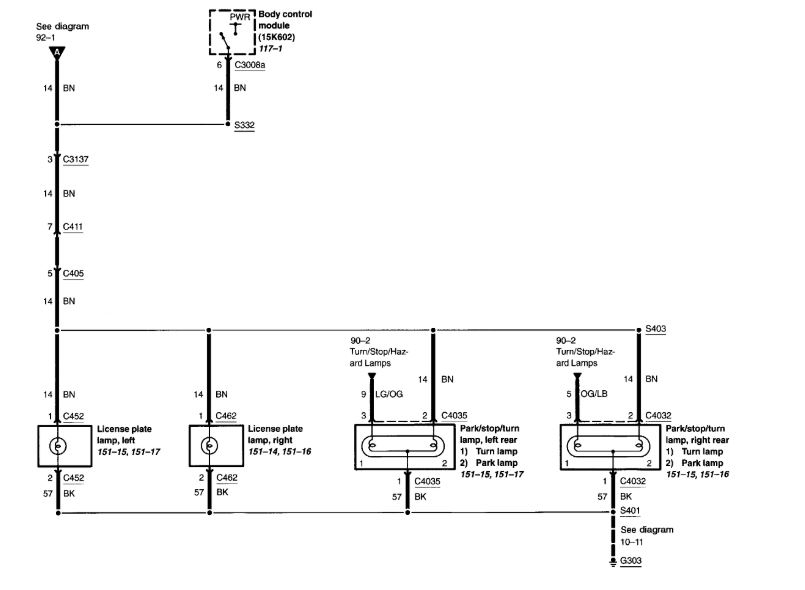

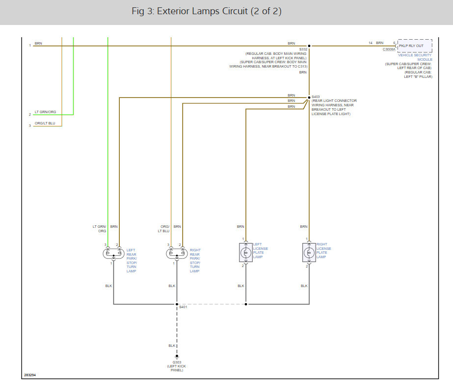

Good morning.
The rear tail lights are controlled by the BCM. It looks for a command from the headlight switch to the BCM. once that is sent it will turn on the rear lights.
You need a scan tool that can read live data from the BCM. You need to verify a signal is being sent to the BCM from the headlight switch and that the BCM is seeing it and sending commands to the rear lights.

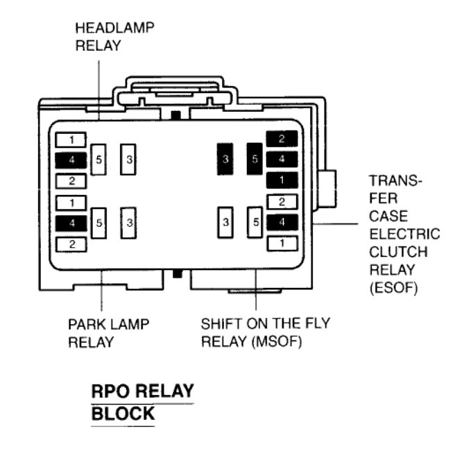

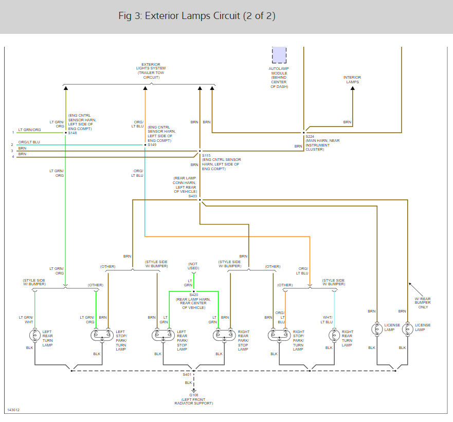

JDL
  • 16,098 POSTS

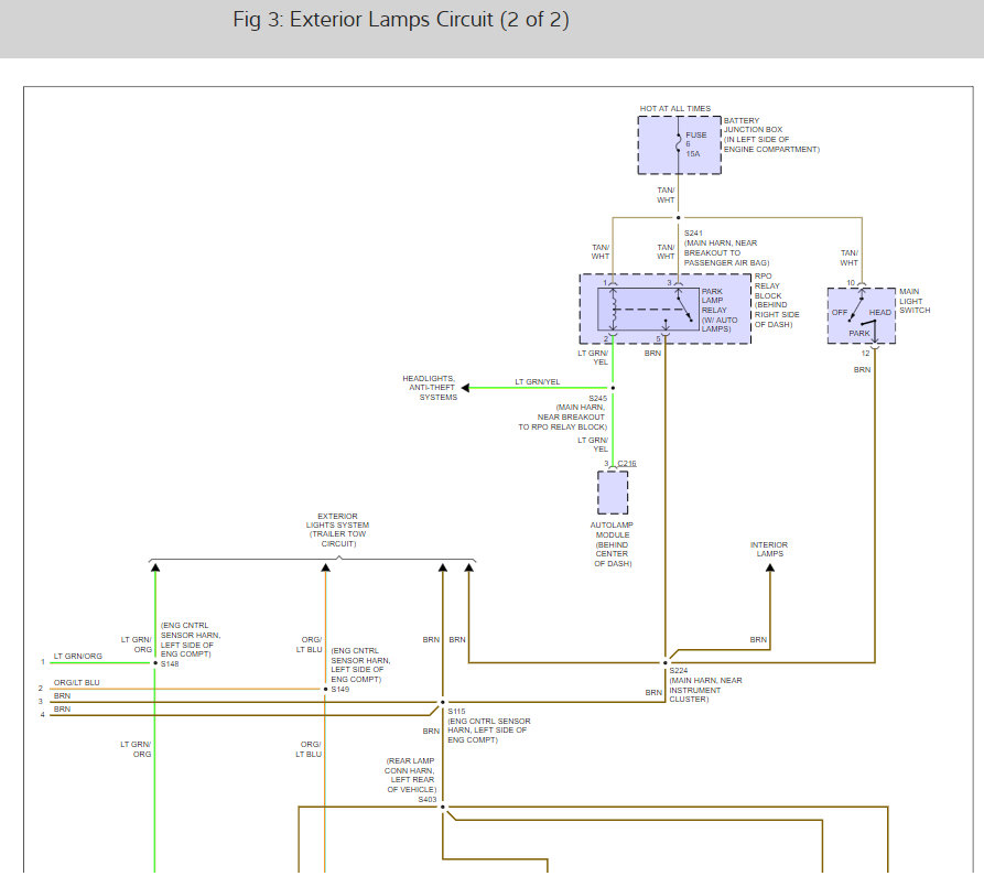

It sounds like the parking light relay is not working but to be sure are two guides and the tail light wiring diagrams to see where you are losing power.
and
Check out the diagrams (Below). Please let us know what you find.

JDL
  • 16,098 POSTS
Do you have voltage at the brown wire, headlamp switch turned on?
Jul 28, 2020 at 12:15 PM (Merged)
DUTCHLADY
  • 4 POSTS
Yes there is voltage at the switch. Switch was taken out and tested.
JDL
  • 16,098 POSTS
I'm talking about at the rear lites, not the switch?
DUTCHLADY
  • 4 POSTS
It was the relay thanks for he guides and helping me I love this stie all for free god bless you guys.

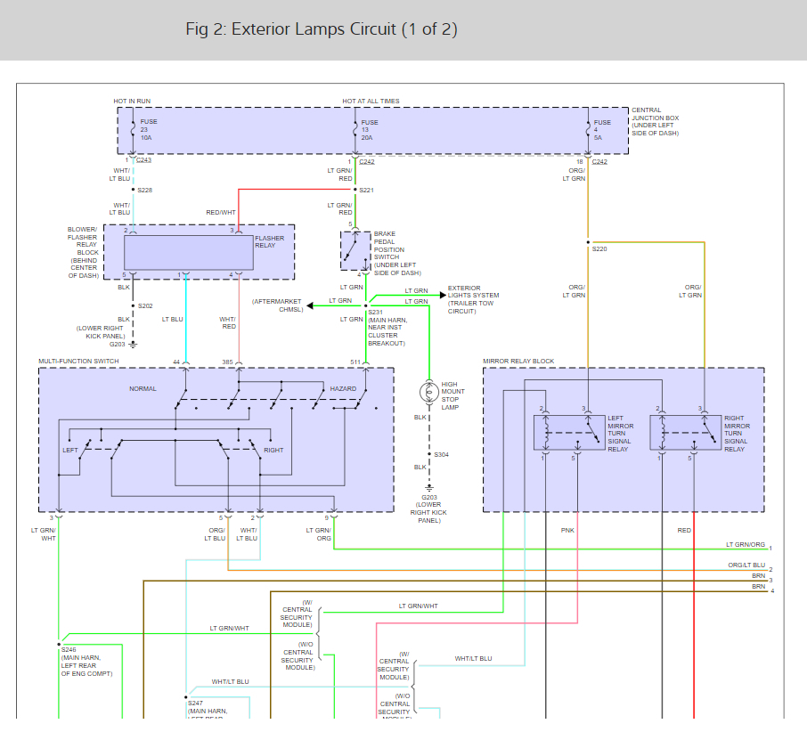

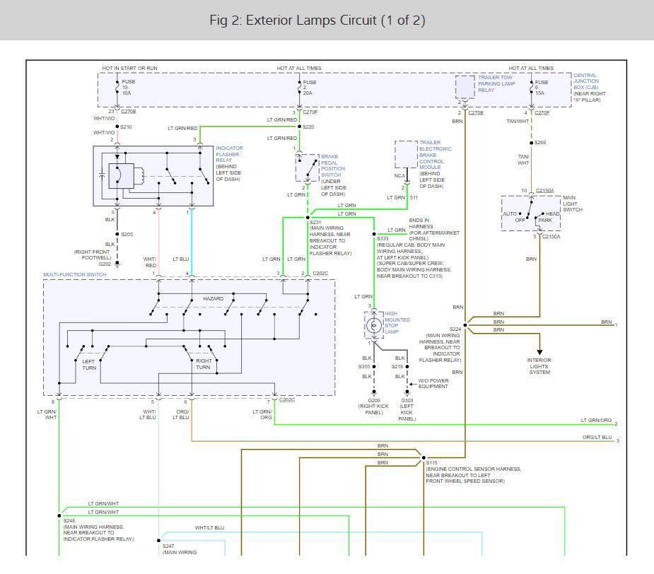

It sounds more like a hazard switch that is out. Here is the wiring diagram and a guide to help you do some testing so you can get the problem fixed.
Here are the blinker light wiring diagrams and you can see there is no PDC in the circuit except for the fuses.
