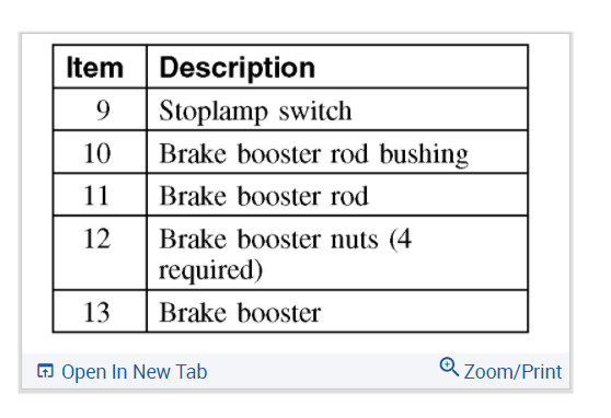

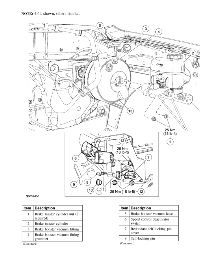

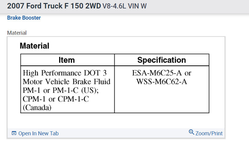

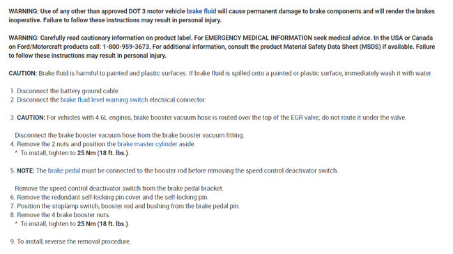

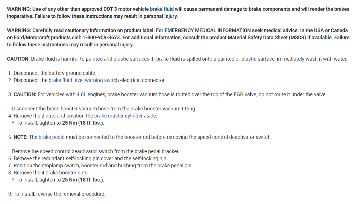

I have a problem replacing the brake booster can you help me please?
Jul 15, 2010 at 2:58 PM
Here are the power brake booster replacement instructions in the diagrams below. Check out the diagrams (below). Please let us know if you need anything else to get the problem fixed.
