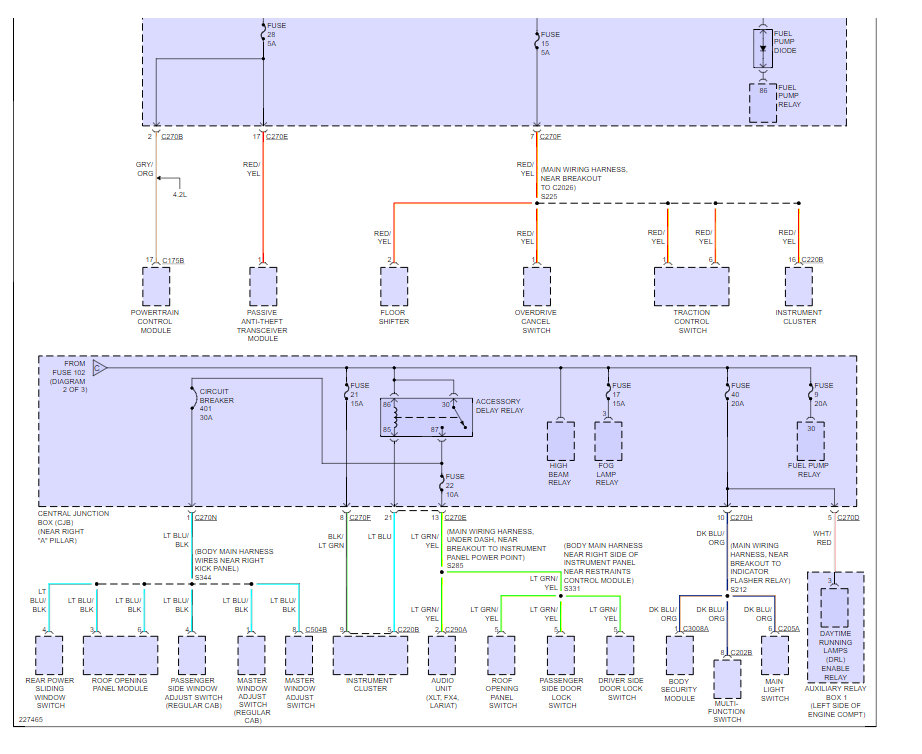

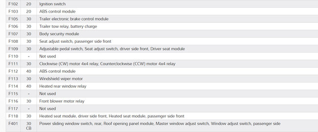

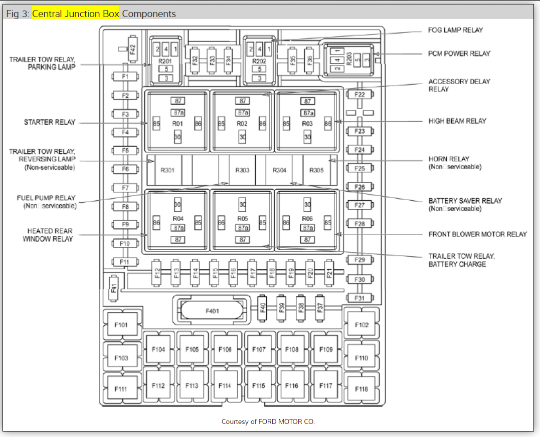

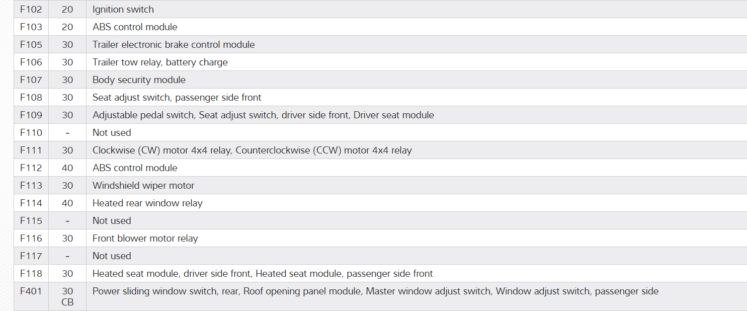

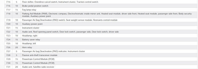

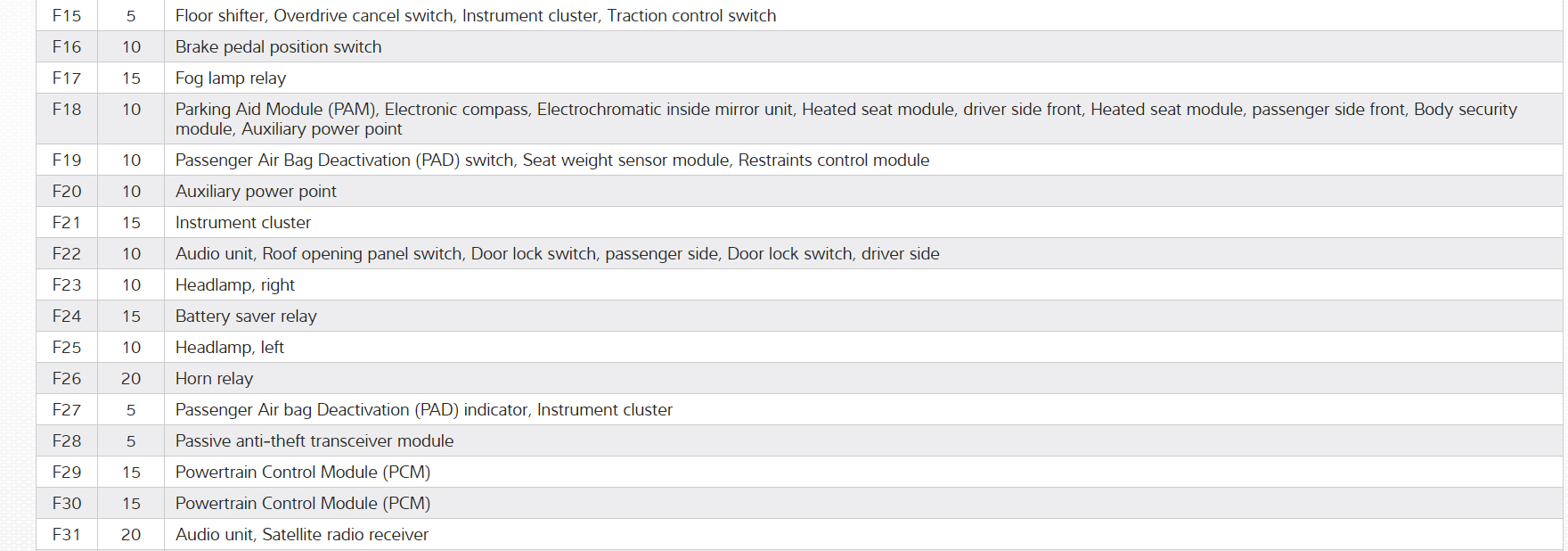

There is an accessory delay relay that powers the items you are talking about I think is going out.

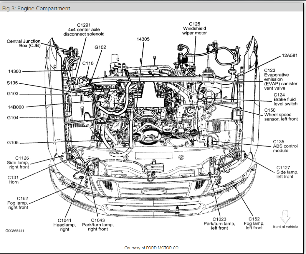

Here is a power wiring diagrams and the guide to test the relay with the relay location.

You guys are the best! that was the problem as soon as I found the relay and removed it I could see where it was super heated. Thanks again you guys are the best!
