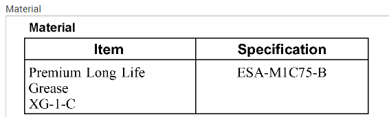

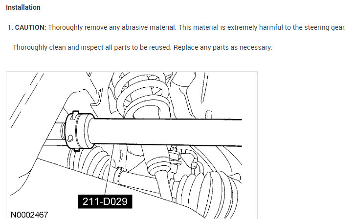

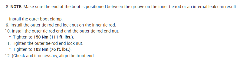

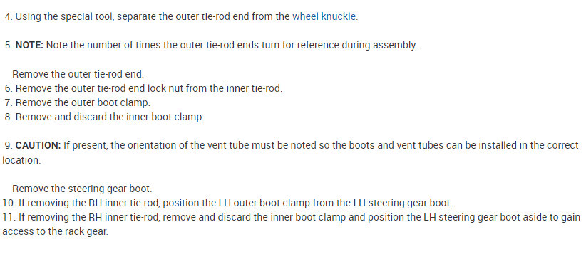

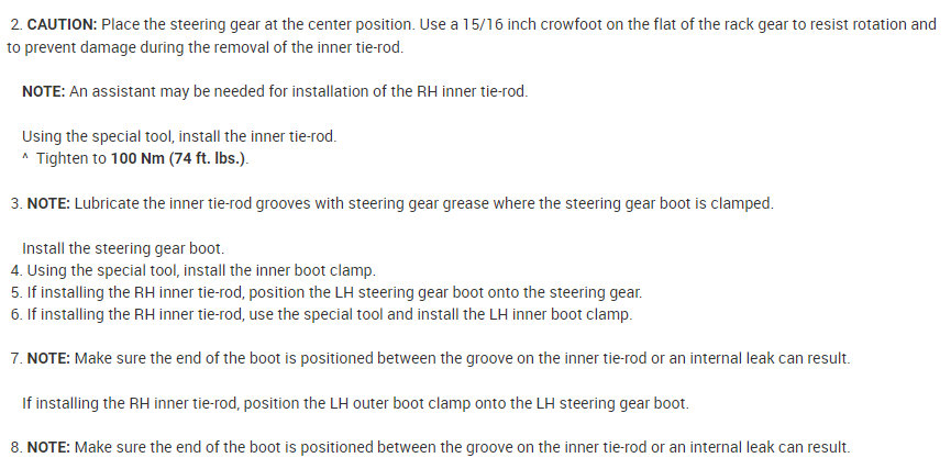

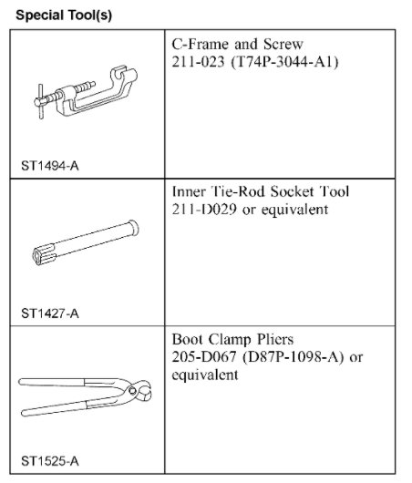

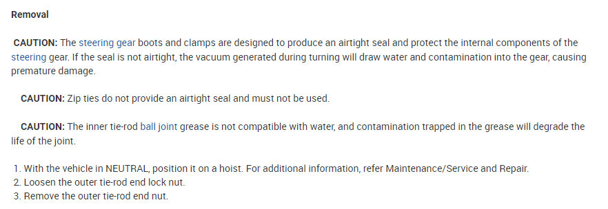

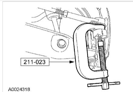

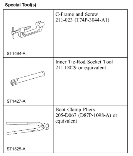

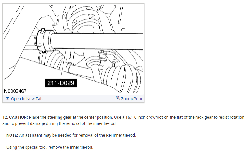

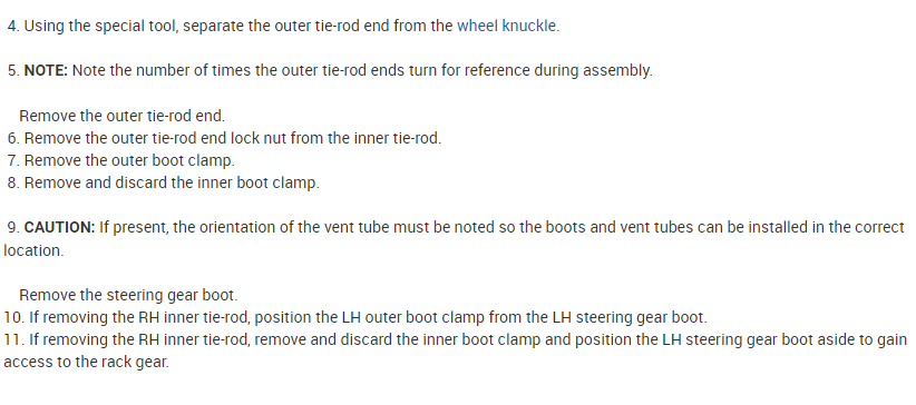

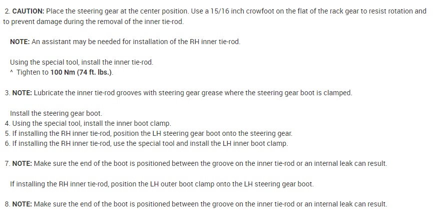

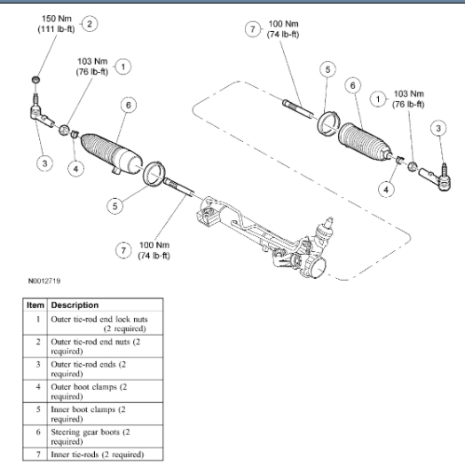

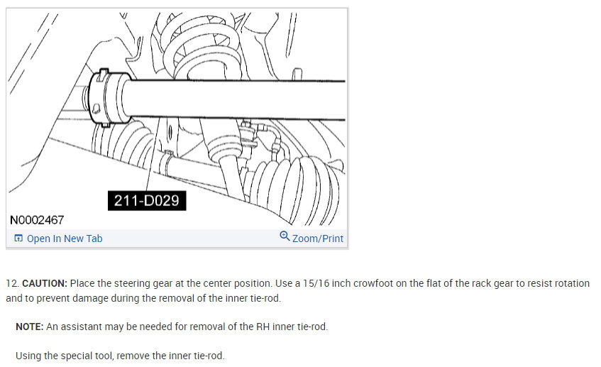

Here is the information you requested. Here is a tutorial showing how to replace tie rod ends:
https://www.2carpros.com/articles/tie-rod-end-replacement
I've attached picture steps below for the replacement of the outer tie rod ends on your Ford F150. After this repair you will need to have a front end end wheel alignment. Hope this helps and thanks for using 2CarPros.
