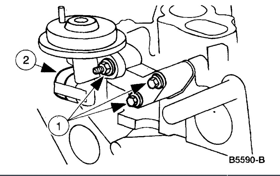

JOSIE2003

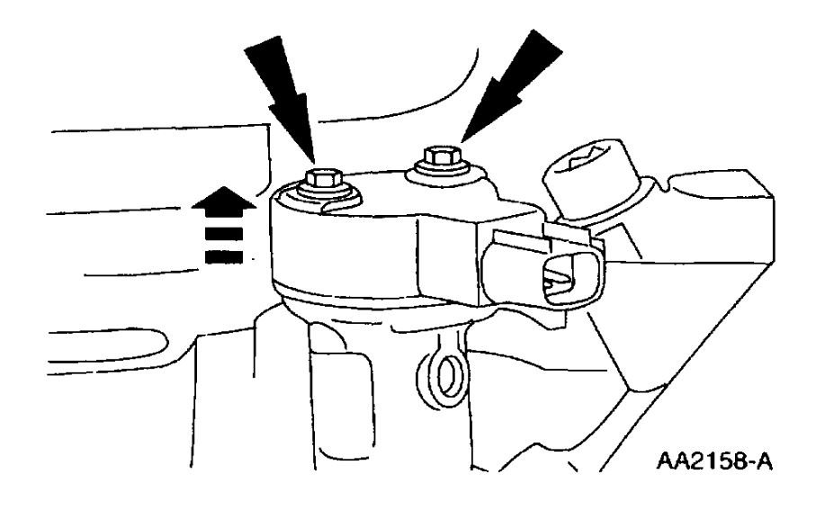

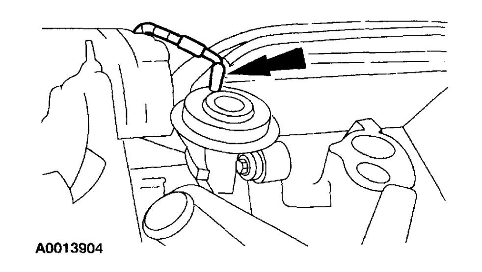

Where is it located exactly on my truck?
Aug 21, 2020 at 5:53 PM (Merged)

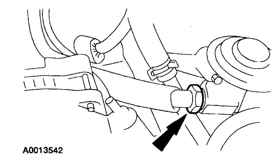

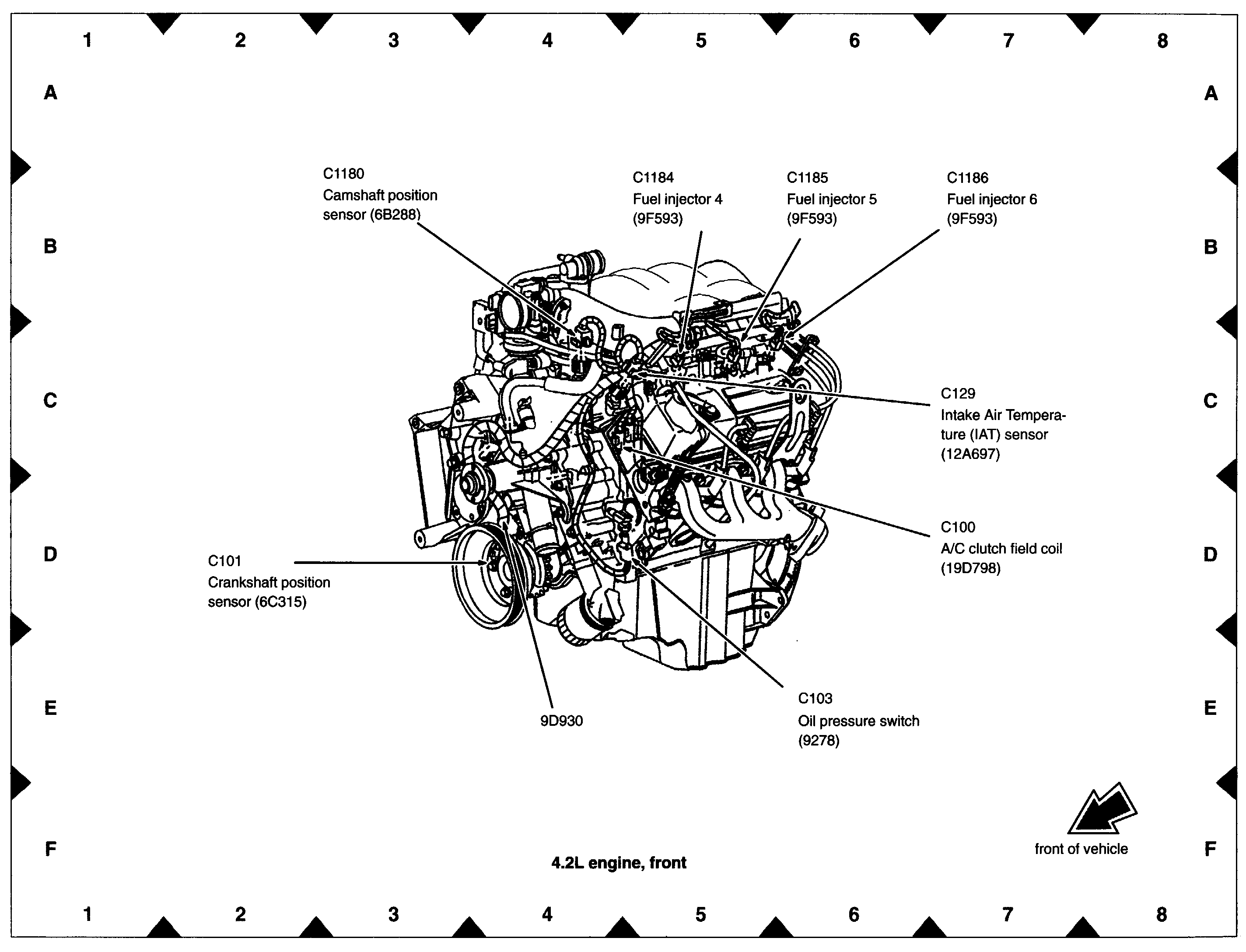

See picture 1 for location.
___________________________________
Here are the directions for replacement:

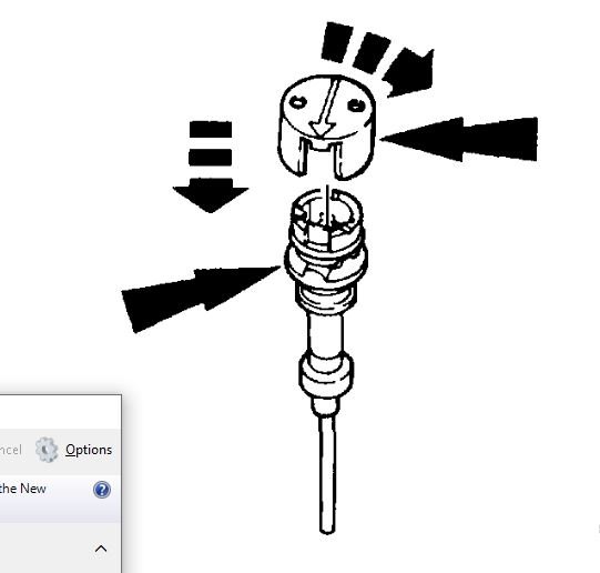

CAMSHAFT POSITION SENSOR
REMOVAL
1. Disconnect the battery ground cable.
2. Partially drain the cooling system.
3. Remove the air cleaner outlet tube.
See picture 2

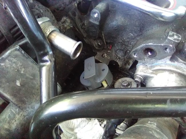

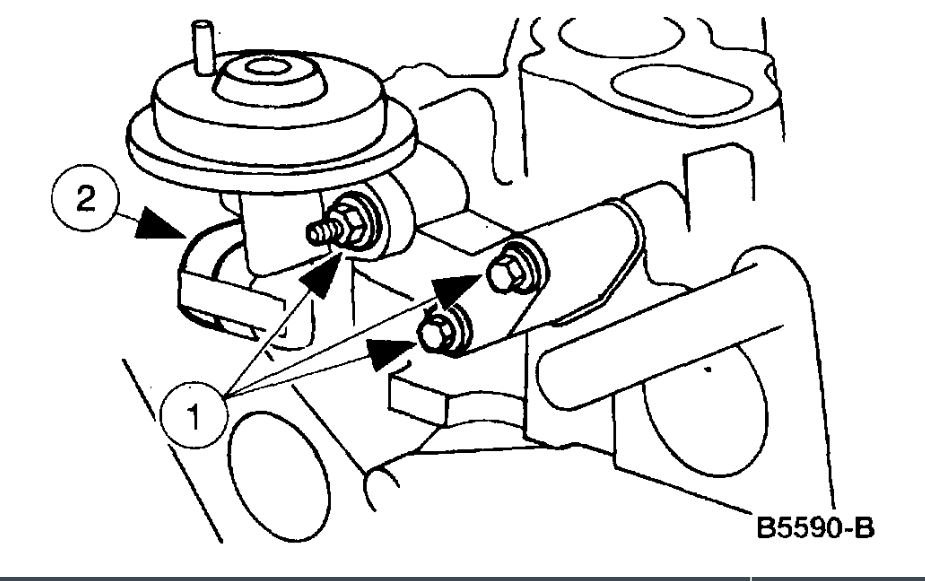

4. Disconnect the engine harness from the water tube, remove the bolt and position the heater water outlet tube aside.

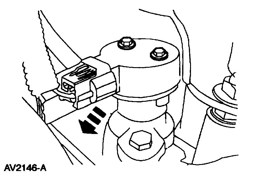

See picture 3

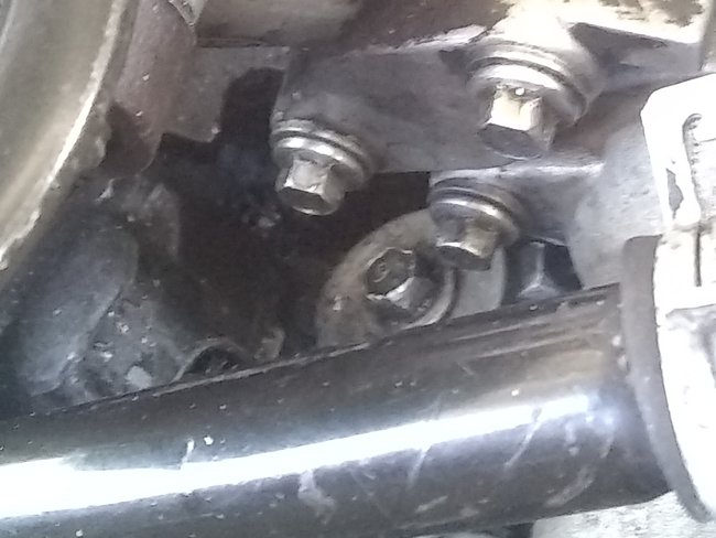

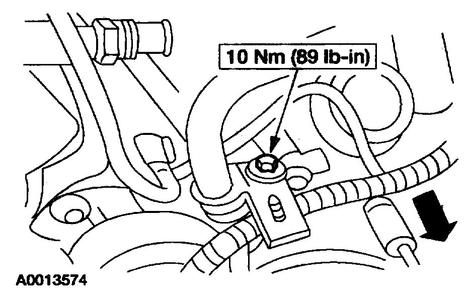

5. Disconnect the Camshaft Position (CMP) sensor electrical connector.
See picture 4
6. Remove the screws and the CMP sensor.

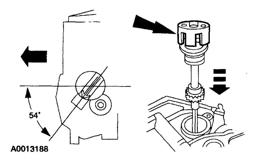

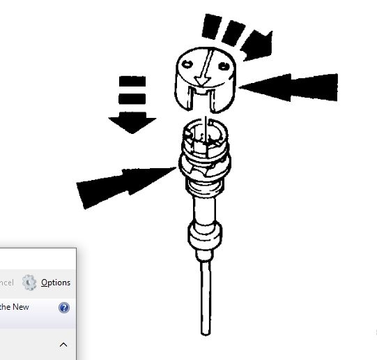

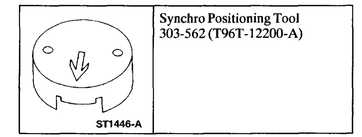

Procedure.
INSTALLATION
CAUTION: The Syncro Positioning Tool must be obtained prior to installation of the new camshaft synchronizer assembly. Failure to follow this procedure will result in the fuel system being out of time with the engine, possibly causing engine damage.
1. Install the Syncro Positioning Tool on the camshaft synchronizer by rotating the tool until it engages the notch in the camshaft synchronizer housing.
CAUTION: A Syncro Positioning Tool must be used during the installation of the new synchronizer assembly. Failure to follow this procedure will result in the fuel system being out of time with the engine, possibly causing engine damage.
2. Install the camshaft synchronizer housing assembly so the arrow on the synchronizer alignment tool is 54 degrees from the centerline of the engine.
NOTE: During installation, the arrow on the synchronizer alignment tool will rotate clockwise as the gears engage.
3. Install the bolt and remove the Syncro Positioning Tool.
NOTE: Do not remove the Syncro Positioning Tool until the bolt is tightened.

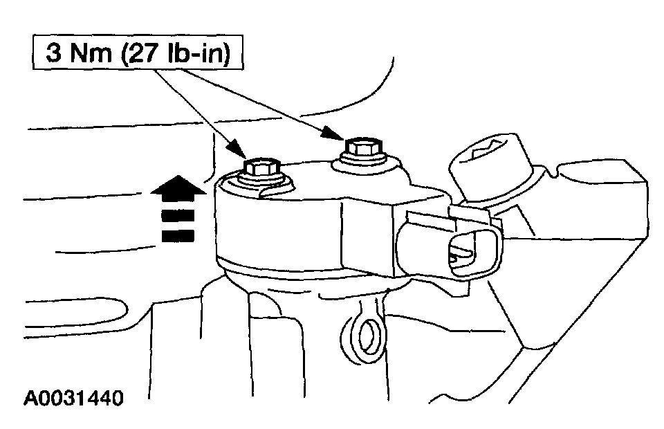

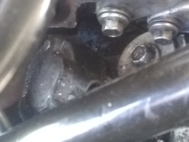

Good evening,
You need a pigtail for the cam sensor. You ask for that at a parts store.
As far as the sensor, it is held by 2 small bolts. I attached a picture for you to view. Is that what you tried to remove?

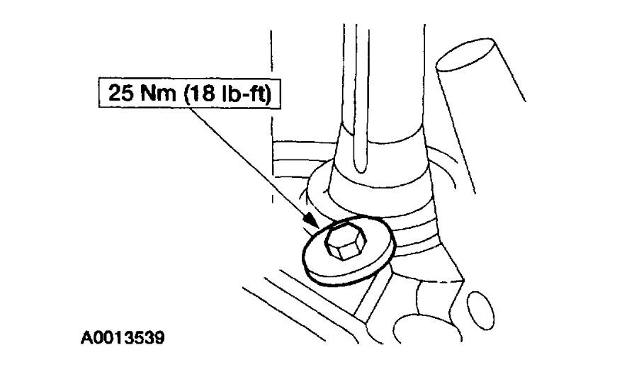

Okay, no, the engine does not have to come apart. You need to remove the EGR valve to get the syncronizer out for reset.
REMOVAL
1. Rotate the crankshaft until the No.1 cylinder is at Top Dead Center (TDC) of the compression stroke.
CAUTION: Do not turn the crankshaft or camshaft during the removal and installation procedure or the fuel system timing will be out of time with the engine and possibly cause engine damage.
2. Remove the camshaft position sensor. For additional information, refer to Camshaft Position (CMP) Sensor.
3. Disconnect the Exhaust Gas Recirculation (EGR) valve vacuum hose.
4. Remove the EGR valve tube upper fitting.
5. Remove the EGR valve and adapter.
1 Remove the nut and the bolts.
2 Remove the EGR valve and adapter assembly.
6. Remove the bolt.

I got the Tool, rented it from AutoZone ($25.00). Getting ready to go do it now. But have another concern . The original problem that I was attacking was replacing my Fuel Injectors . okay now the one that I bought from Amazon. State that they are for my vehicle 2000 Ford F150 4.2 v6 2wd. However they are much fatter then the ones that I removed, the old ones seated down in the holes, these ones do not. The bottom o-ring on the injectors can be seen as they do sit on the top of the holes in the intake manifold and the fuel rail does seat down properly on top of them but the rail is the only thing keeping them down. If rail was to be lifted off the injectors would just fall cause they are not going down inside the lower intake manifold. If that makes sense.? I put the key in on position and got no leaks anywhere but worried that maybe reason for no leaks may be due to no to having enough fuel pressure built up . As prior to doing all this work I was not getting proper fuel pressure readings at all. What do you think I should do? The injectors should

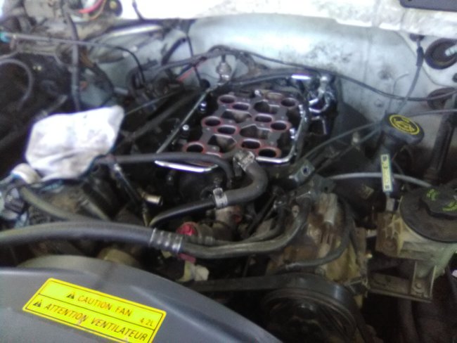

Okay this is where I am at. I pulled the Fuel rail back off to check the seating of the Injectors and the rail itself did push them down a bit, the bottom tips of each one are in the holes. Now on the Synchronizer I rented the tools there were 1black, 1 yellow, 1 gray and I think 1blue,. Anyways I used the Gray. This is all I did though please tell me if I need to do more or if it is Good. Okay I removed the camshaft positioning sensor and tried each color tool, not any of them went on it so I put the sensor back on and then I "loosened " the large bolt and Washer and just turn the whole Synchro and housing slightly until I got one of the tools to fit down on it properly (which was the Gray one. I then tightened up the big bolt and put the sensor back on it. . I never attempted at all to lift the Synchronizer out. So is that okay now? Do I need to do anything more to it? Am I now TDC?
