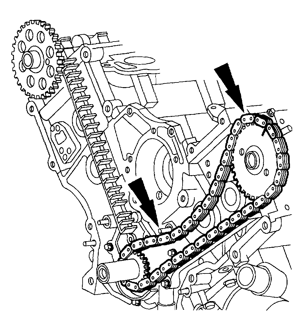

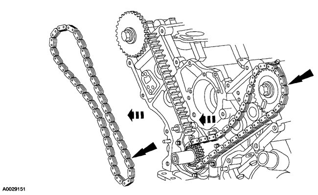

Before removing the oil pump, the timing chains need to be removed. I will start with them and then follow up with the pump. The attached pictures correlate with the directions.
_____________________________________________________________
2003 Ford Truck F 150 2WD Pickup V8-5.4L Prop SOHC VIN Z
Timing Drive Components
Vehicle Engine, Cooling and Exhaust Engine Timing Components Timing Chain Service and Repair Removal and Replacement Timing Drive Components
TIMING DRIVE COMPONENTS
Timing Drive Components-Windsor Engine (5.4L)

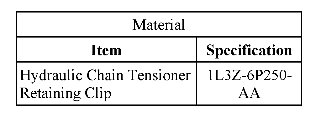

Special Tool(s)
Material
pic 1
Removal
CAUTION: Since the engine is not free-wheeling, the timing procedures must be followed exactly or piston and valve damage can occur.
1. Remove the engine front cover.

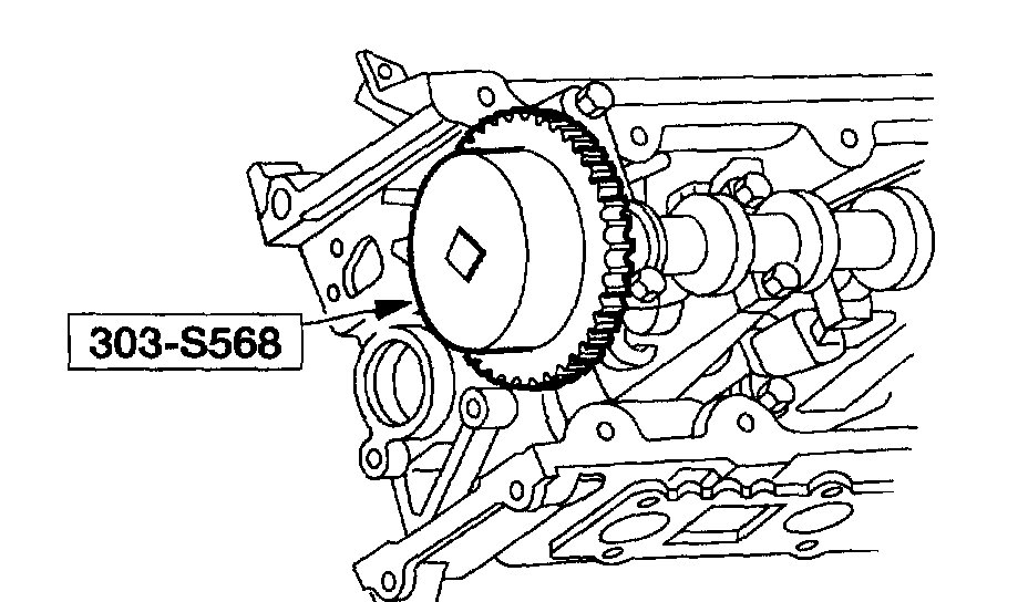

pic 2

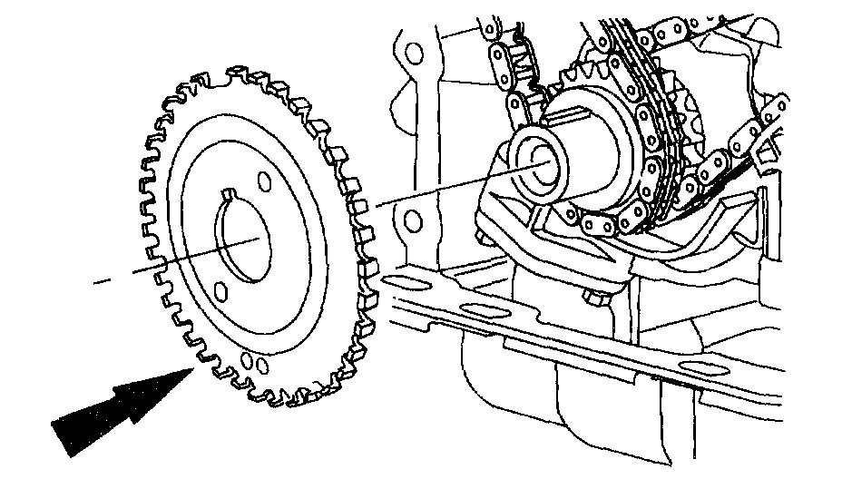

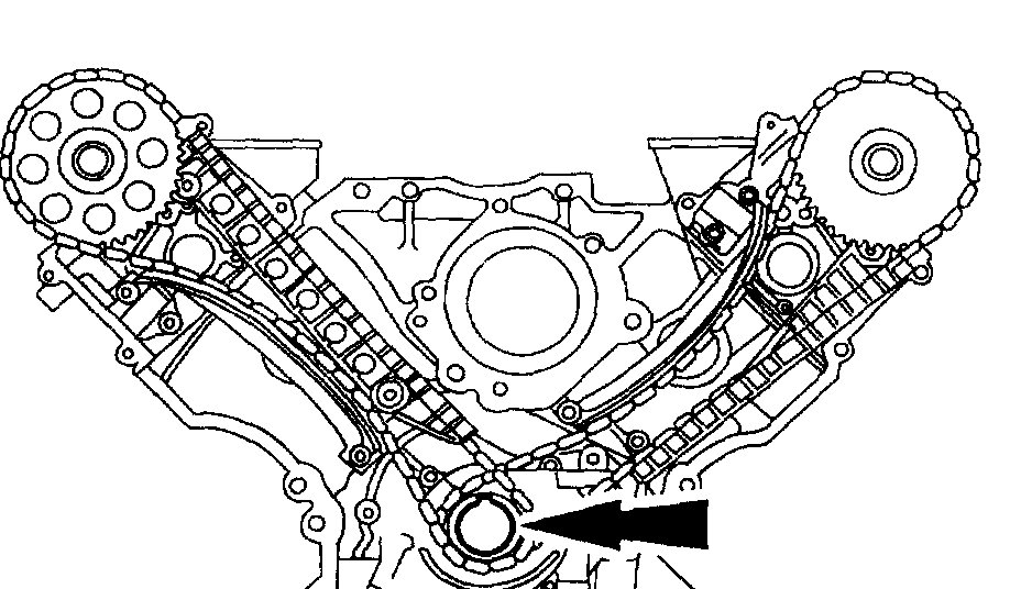

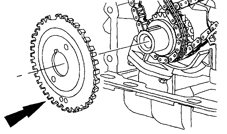

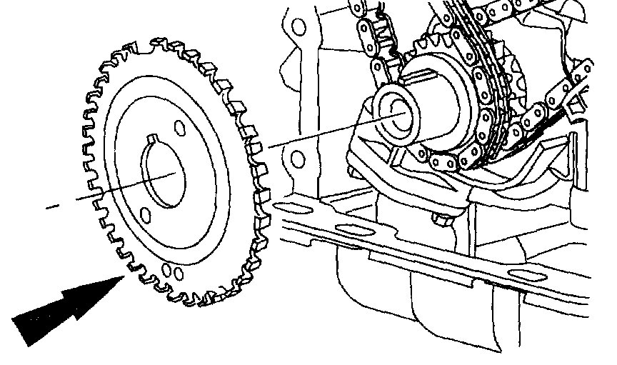

2. Remove the crankshaft sensor ring from the crankshaft.

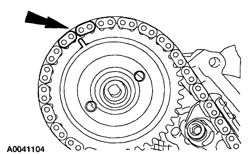

pic 3
3. CAUTION: Unless otherwise instructed, at no time when the timing chains are removed and the cylinder heads are installed is the crankshaft or camshaft to be rotated, Severe piston and valve damage will occur.

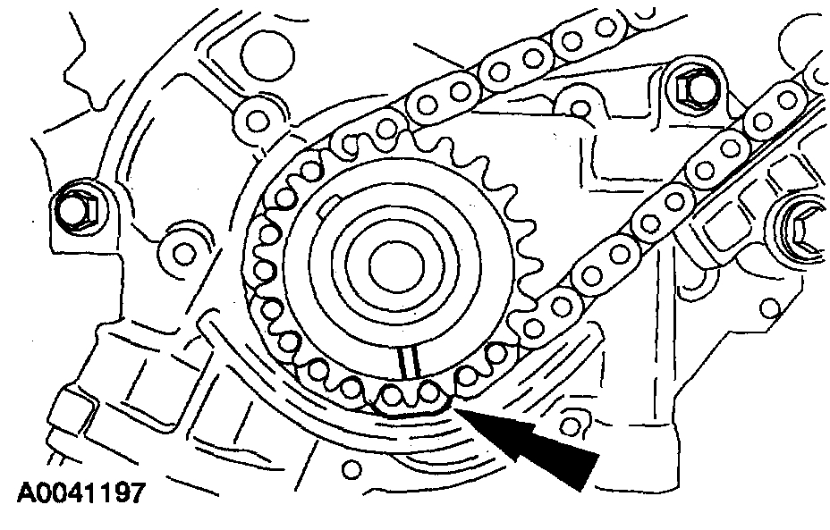

Position the crankshaft with the keyway at the 12 o'clock position.

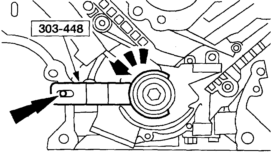

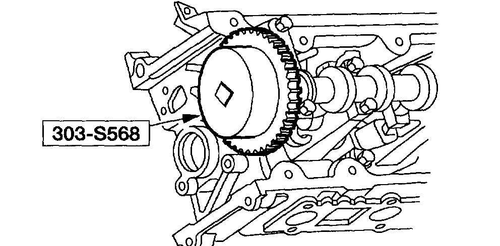

pic 4

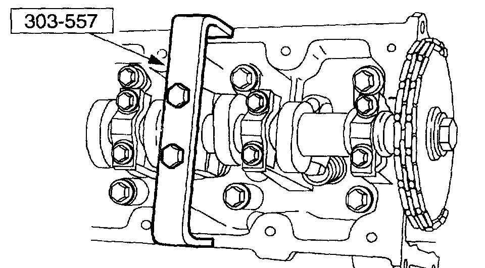

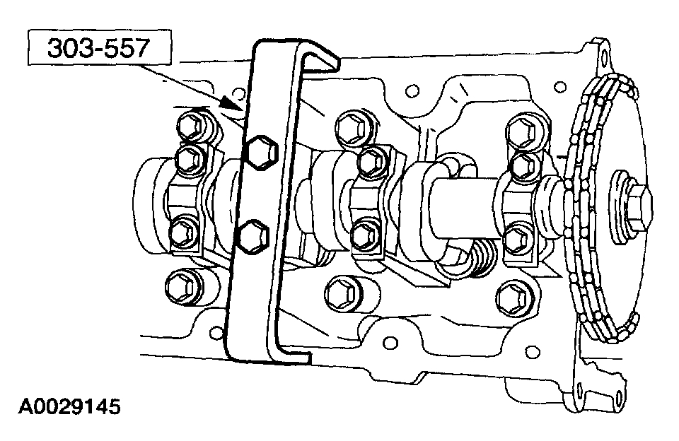

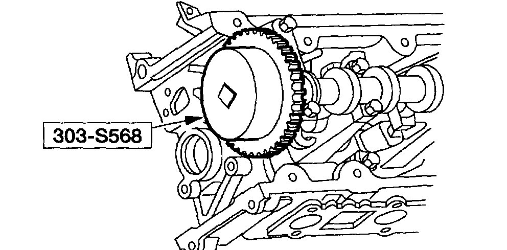

4. Install and fully tighten the special tools on both camshafts.

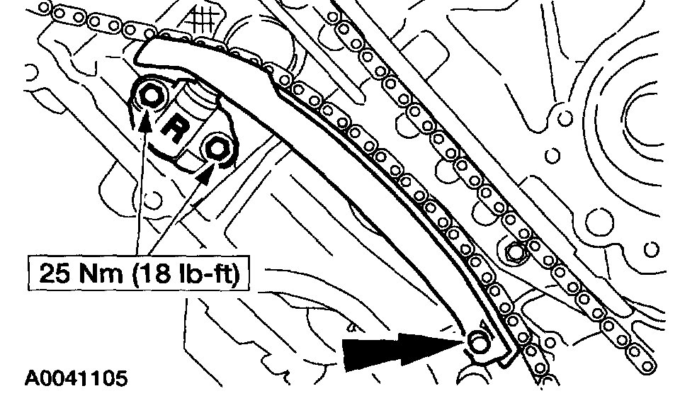

pic 5

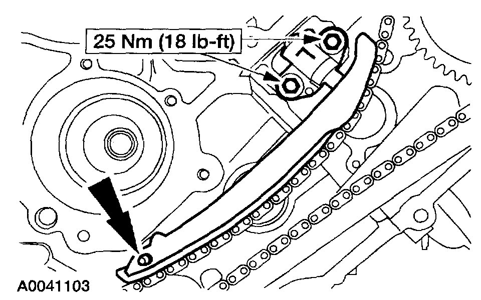

5. Remove the timing chain tensioning system from both timing chains.
1 Remove the bolts.
2 Remove the timing chain tensioners.
3 Remove the timing chain tensioner arms.

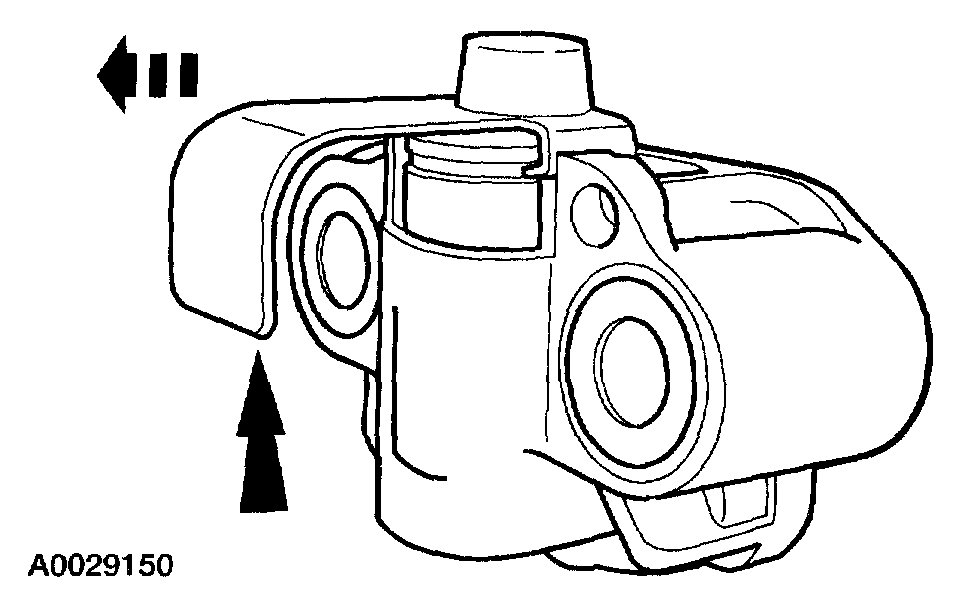

pic 6

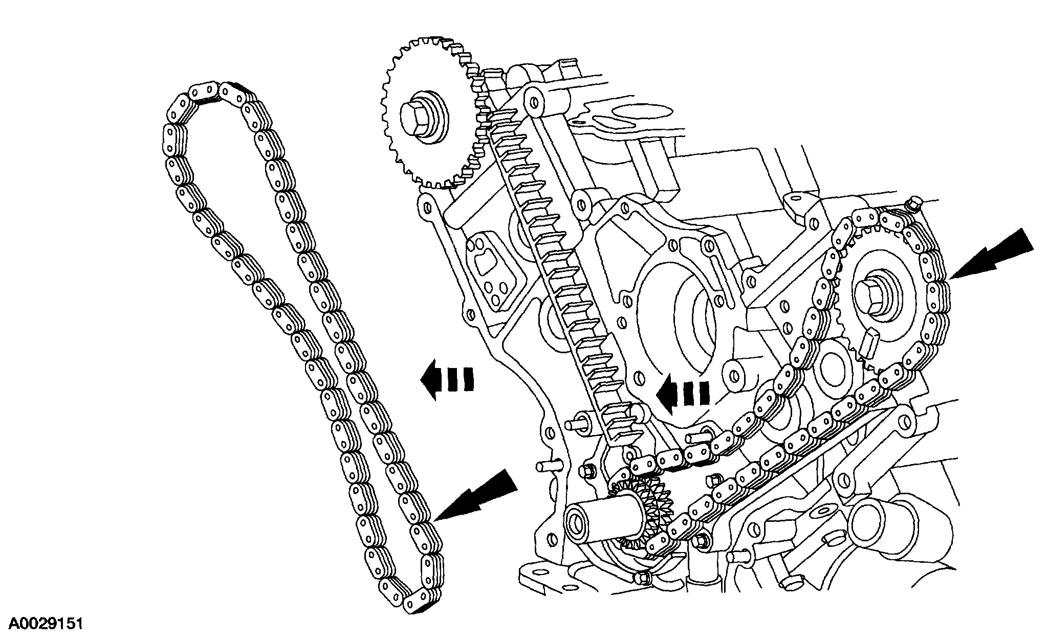

6. CAUTION: Unless otherwise instructed, at no time when the timing chains are removed and the cylinders heads are installed is the crankshaft or camshaft to be rotated. Severe piston and valve damage will occur.
Remove the RH and LH timing chains and the crankshaft sprocket.
- Remove the RH timing chain from the camshaft sprocket.
- Remove the RH timing chain from the crankshaft sprocket.
- Remove the LH timing chain from the camshaft sprocket.
- Remove the LH timing chain and crankshaft sprocket.

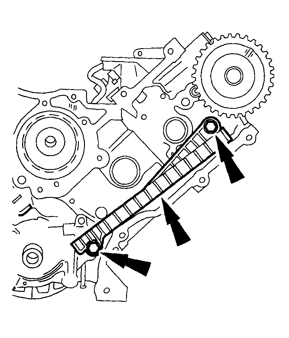

pic 7

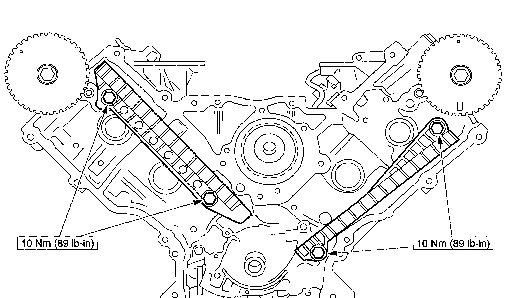

7. Remove both timing chain guides.
- Remove the bolts.
- Remove both timing chain guides.
Installation

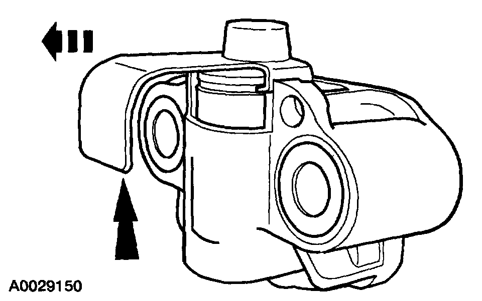

pic 8
1. CAUTION: Timing chain procedures must be followed exactly or damage to valves and pistons will result.

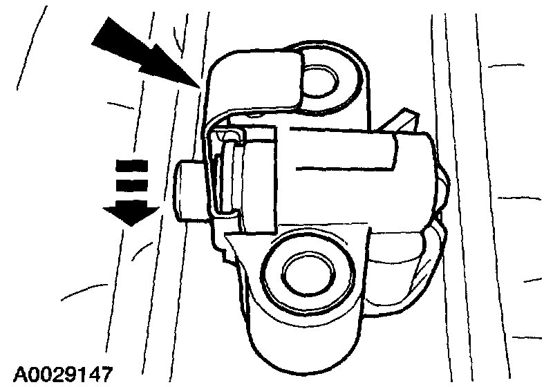

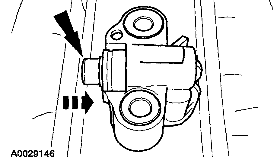

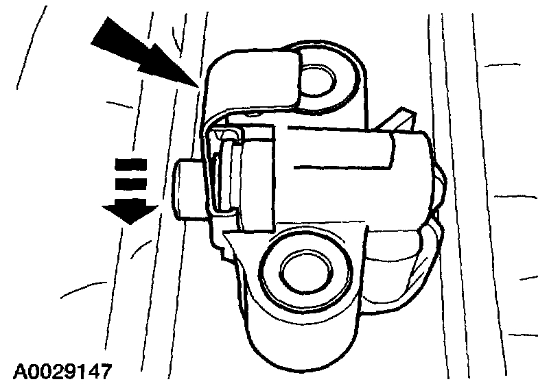

Compress the tensioner plunger, using a vise.
pic 9
2. Install a retaining clip on the tensioner to hold the plunger in during installation.
3. Remove the tensioner from the vise.
pic 10

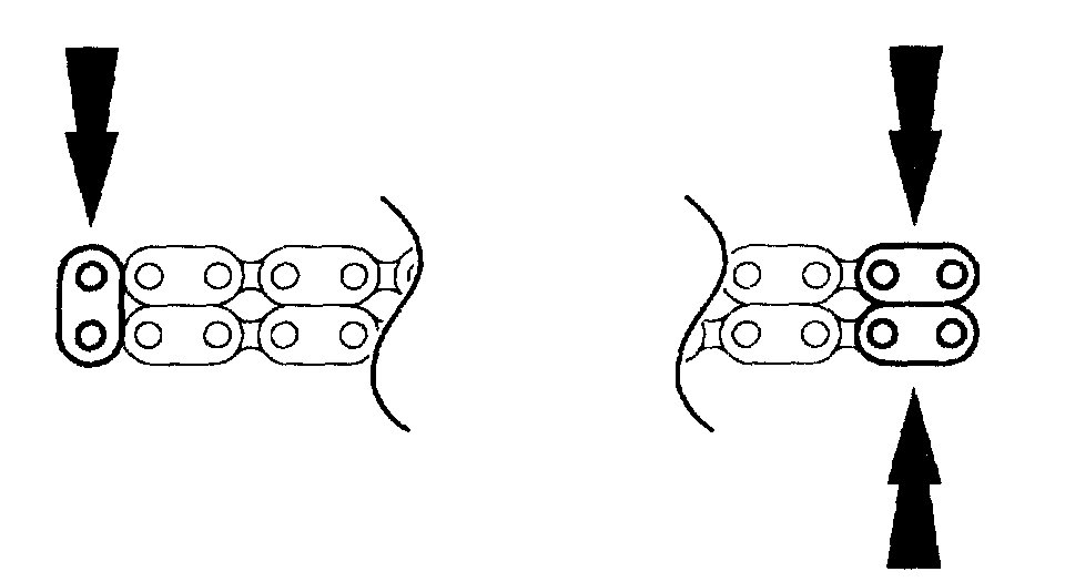

4. If the copper links are not visible mark two links on one end and one link on the other end, and use as timing marks.
pic 11

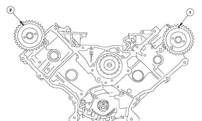

1 Rotate the LH camshaft with the Camshaft Alignment Set until the timing mark is approximately at 12 o'clock.
2 Rotate the RH camshaft with the Camshaft Alignment Set until the timing mark is approximately at 11 o'clock.
- Tighten the Camshaft Position Aligner tools to maintain camshaft pre-positioning.

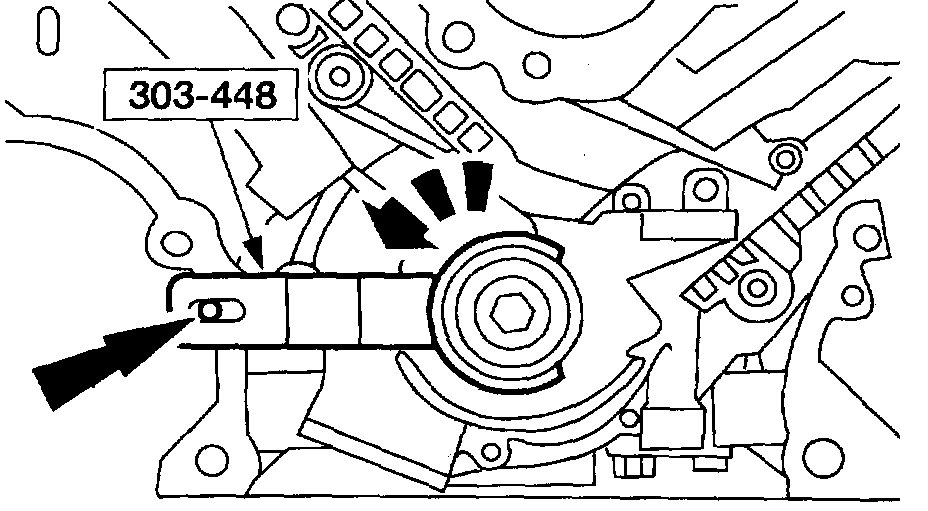

CAUTION: Rotate the crankshaft counterclockwise only. Do not rotate past position shown or severe piston and valve damage can occur.
NOTE: The number one cylinder is at Top Dead Center (TDC) when the stud on the engine block fits into the slot in the handle of the special tool.
Position the crankshaft so the number one cylinder is at TDC with the special tool.

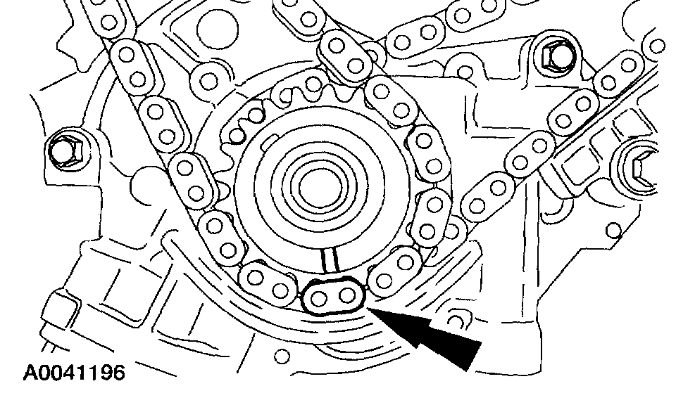

pic 16

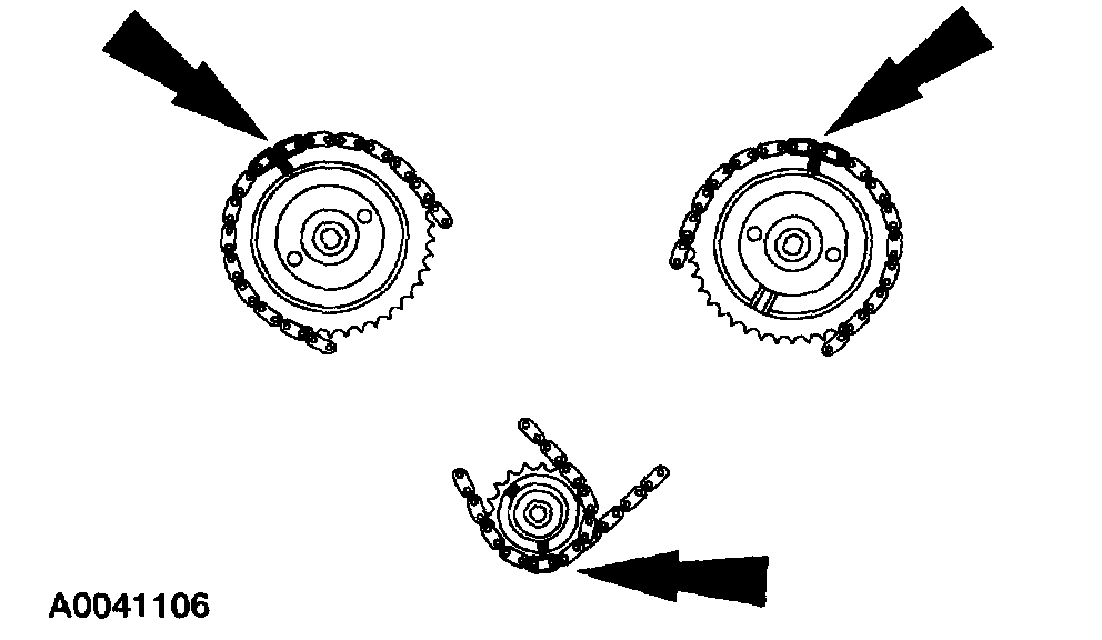

11. Position the lower end of the LH (inner) timing chain on the crankshaft sprocket, aligning the timing mark on the outer flange of the crankshaft sprocket with the single copper (marked) link on the chain.
pic 17
12. NOTE: Make sure the upper half of the timing chain is below the tensioner arm dowel.
NOTE: If necessary, use the Camshaft Alignment Set to adjust the camshaft sprocket slightly to obtain timing mark alignment.

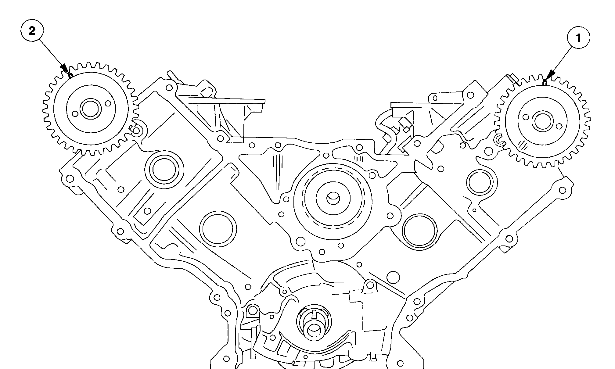

Position the timing chain on the camshaft sprocket with the camshaft sprocket timing mark positioned between the two copper (marked) chain links.

20. As a post-check, verify correct alignment of all timing marks.

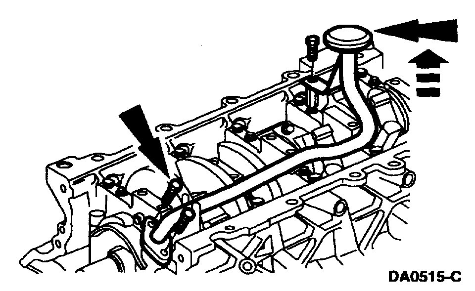

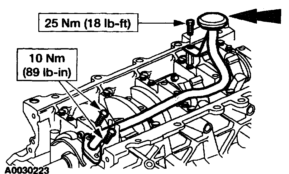

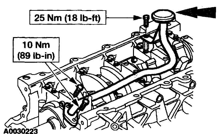

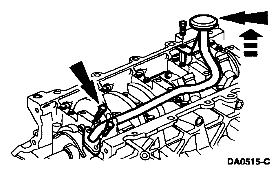

3. If necessary, remove the three bolts and the oil pump screen and pickup tube.

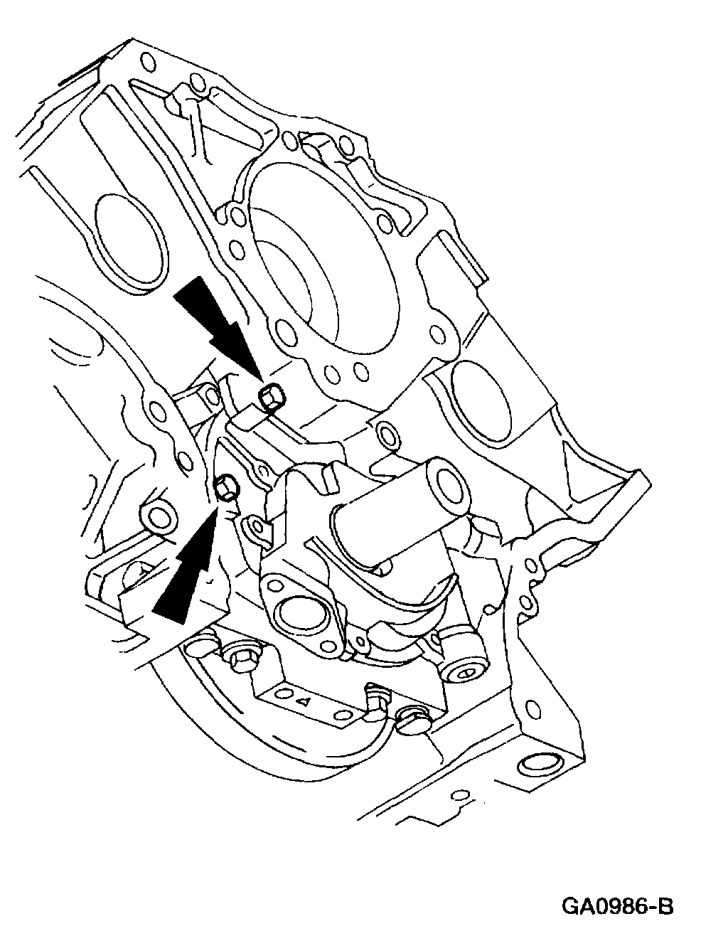

4. Remove the oil pump.
- Remove the three bolts.
- Remove the oil pump.

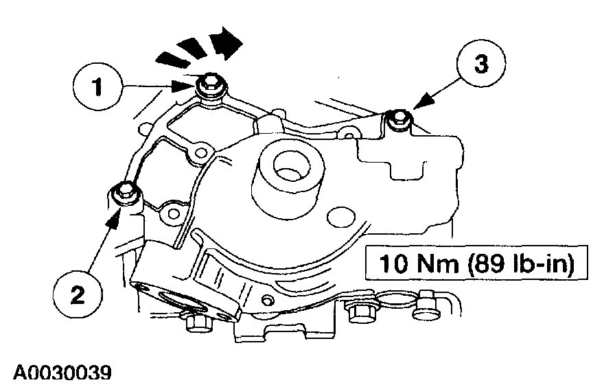

2. Install the oil pump and loosely install the bolts.
- Position the oil pump.
- Loosely install the bolts.
- Tighten the bolts in the sequence shown.
