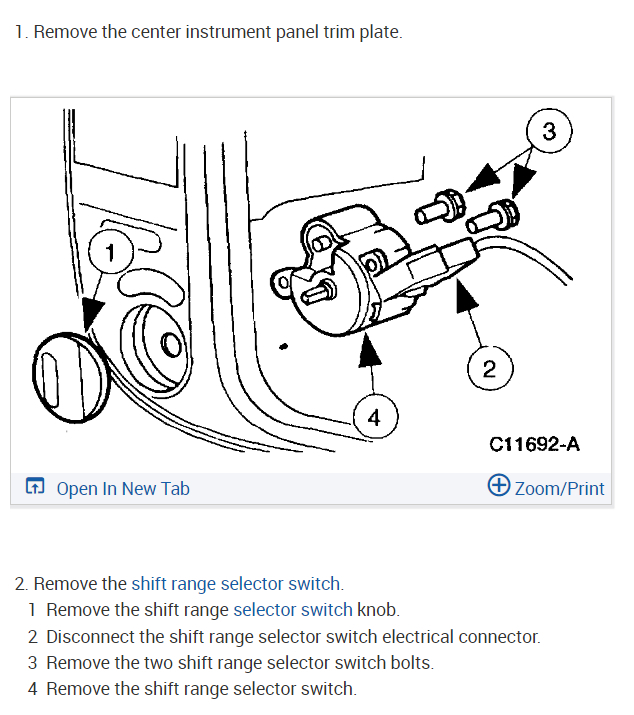

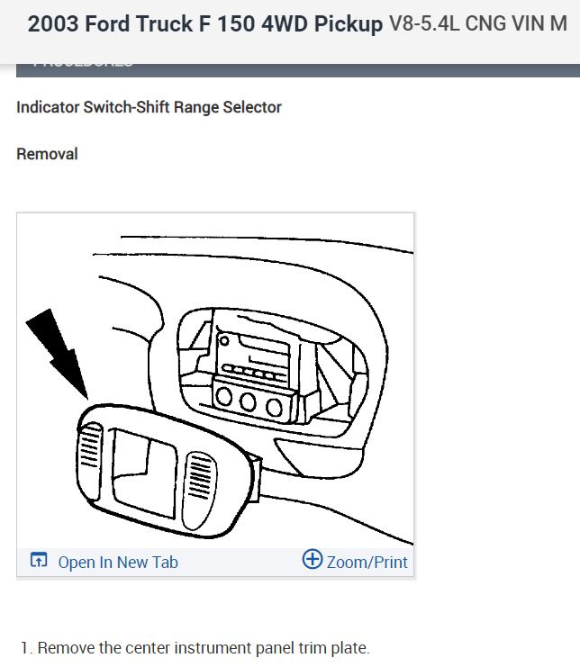

Yep, yep, here is how to change the switch out to help fix the problem. Check out the images (below). Please let us know what happens.
