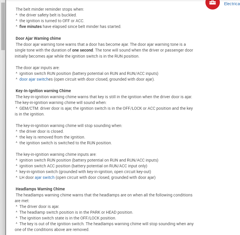

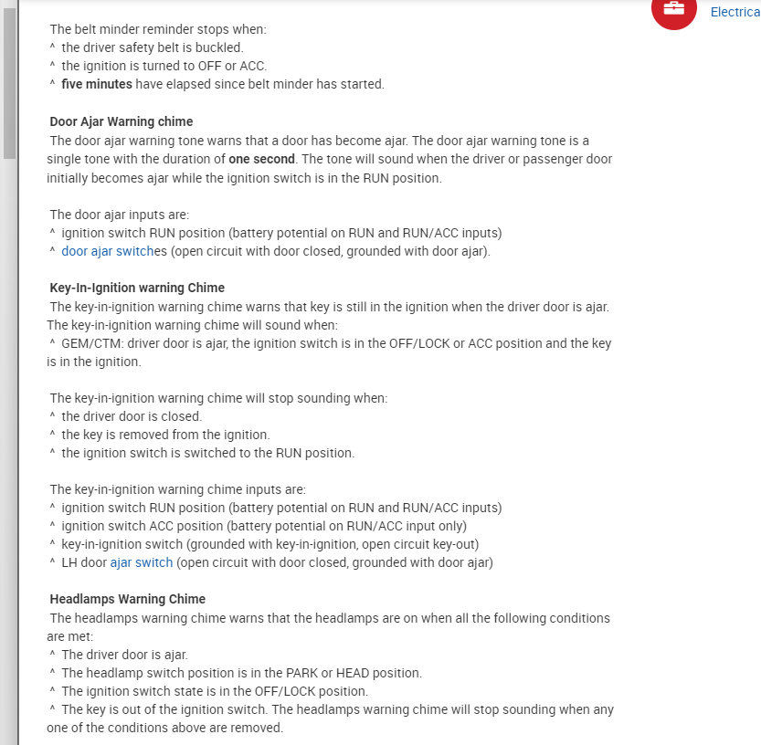

after driving for about 10 minutes a beeping noise occurs under the dash by the steering wheel on the left side. seat belt is buckled; all head and tail lights work properly, no indication on panel as to what the problem is. all fluids are fine. beeps 6 times intermittently. why?
Sep 5, 2008 at 1:32 PM

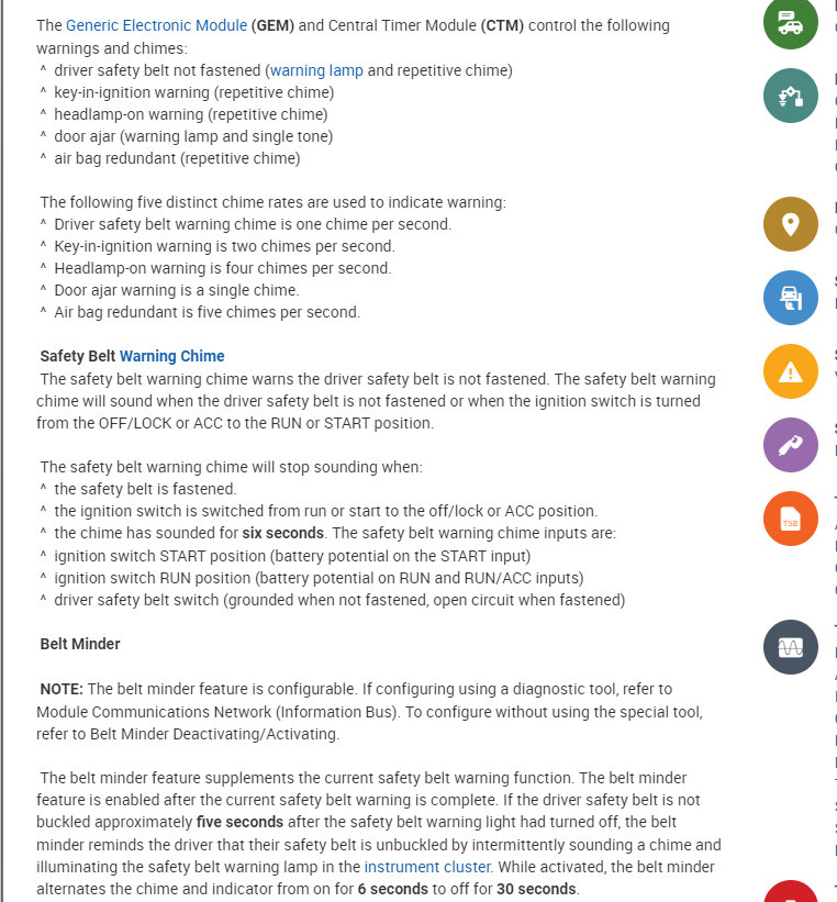

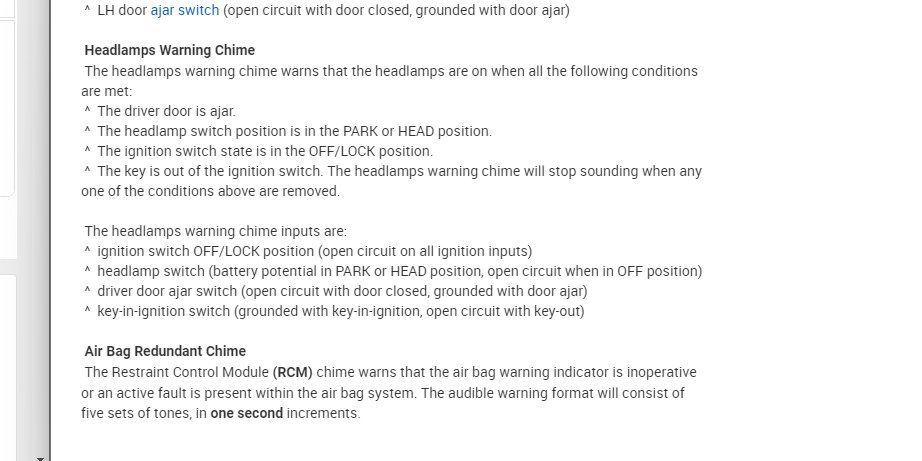

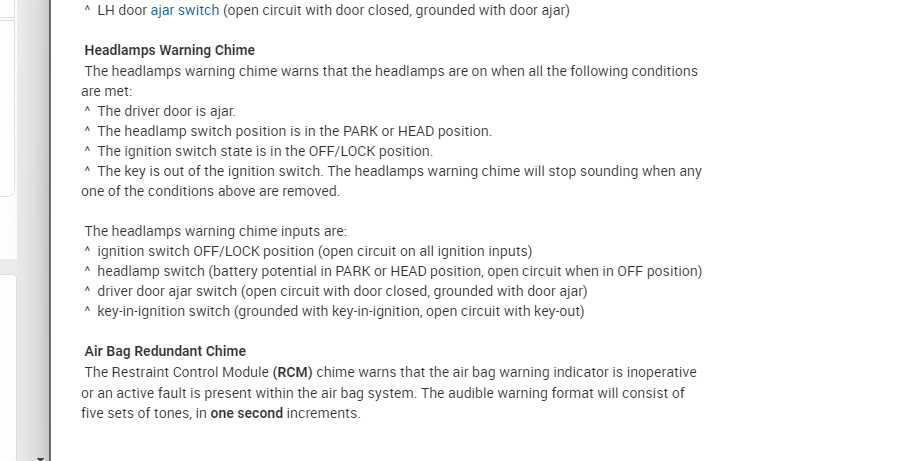

If you can get a recording of this noise, that will help confirm what this noise is.
Basically, we need to hear the tone and increments of the chime in order to figure out what the possible issue is.

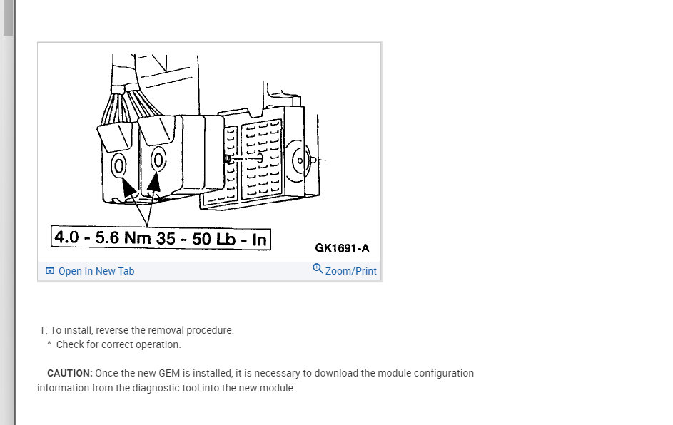

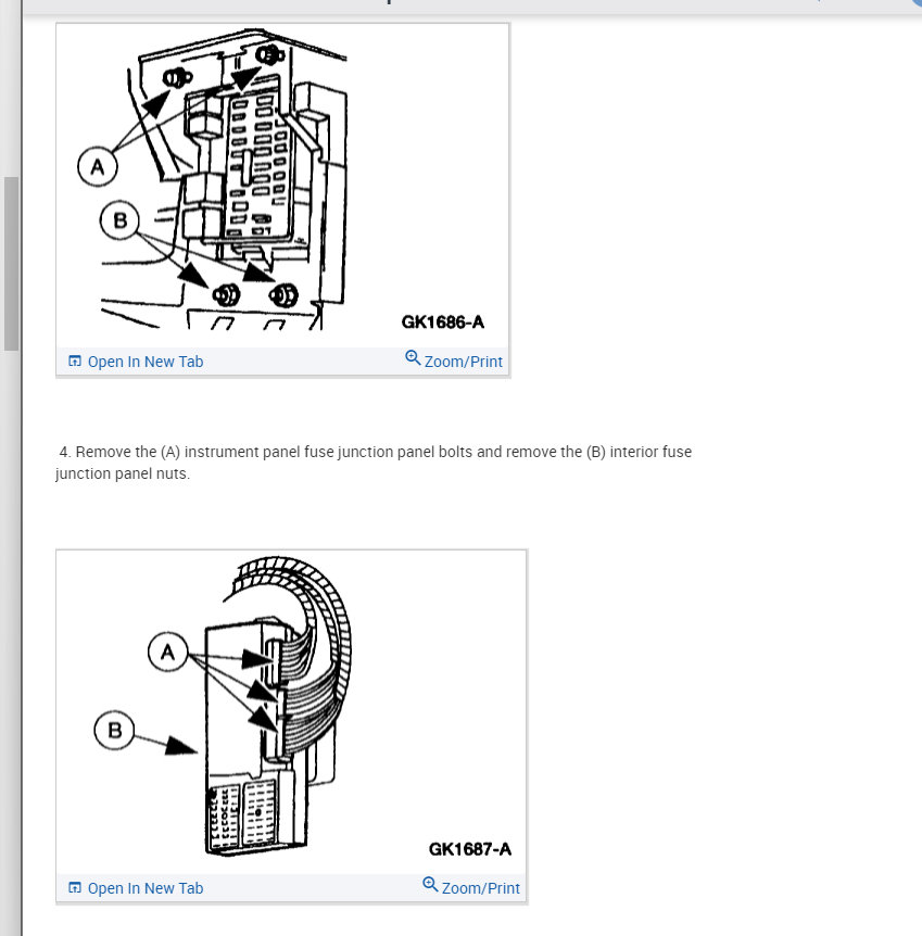

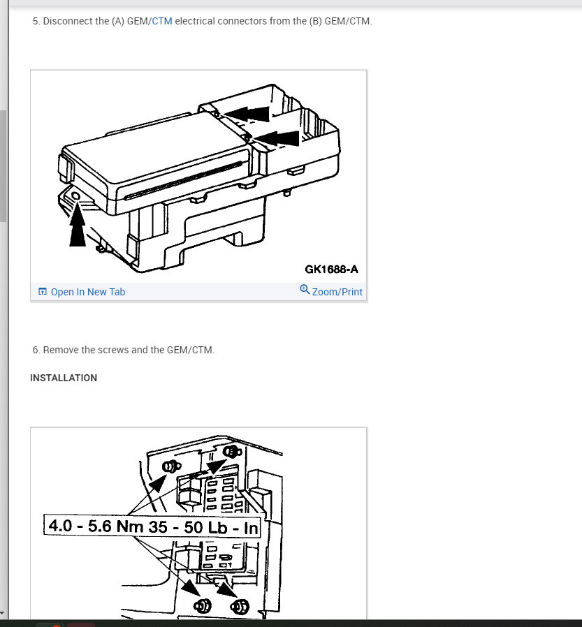

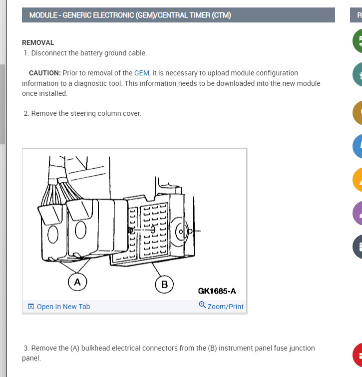

However, if we have no warning lights to go along with the noise then more than likely the GEM has failed.
I am attaching the info below on how to replace the GEM as well as I suspect this is going to be the issue.
So please run through the info attached and let me know what you find.
