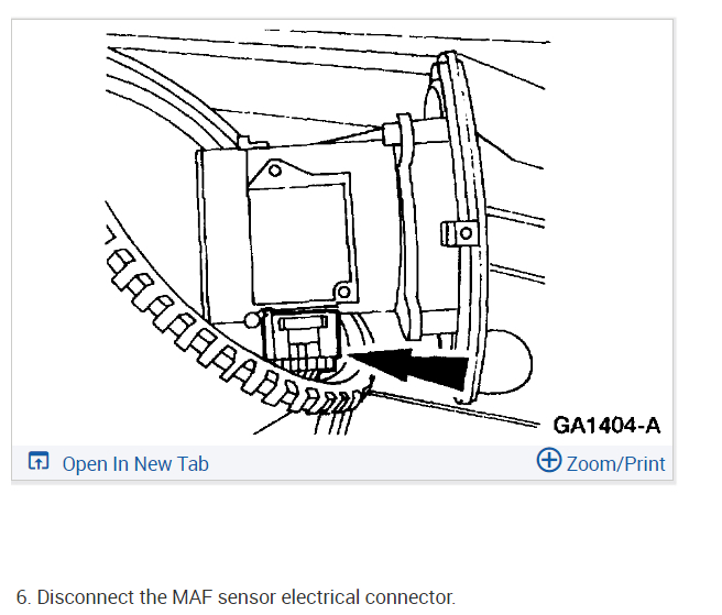

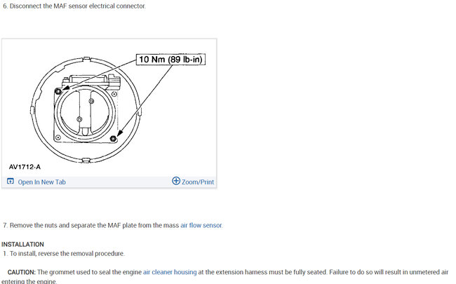

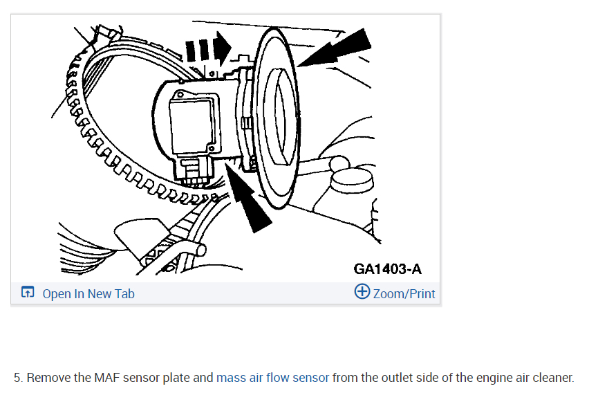

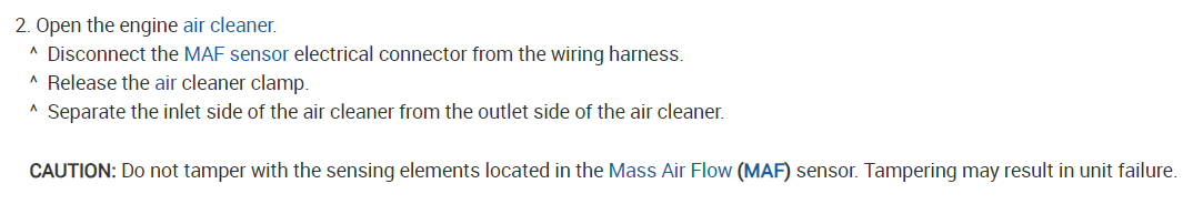

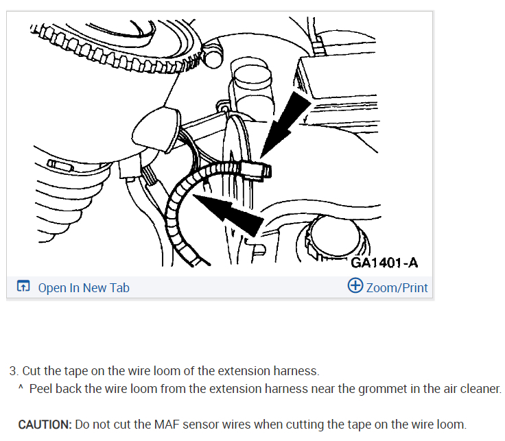

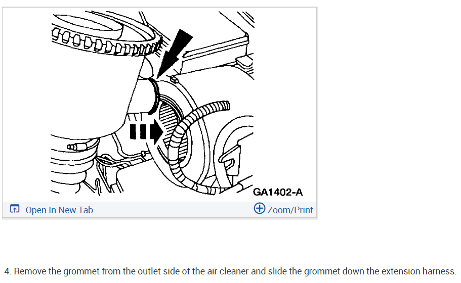

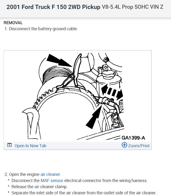

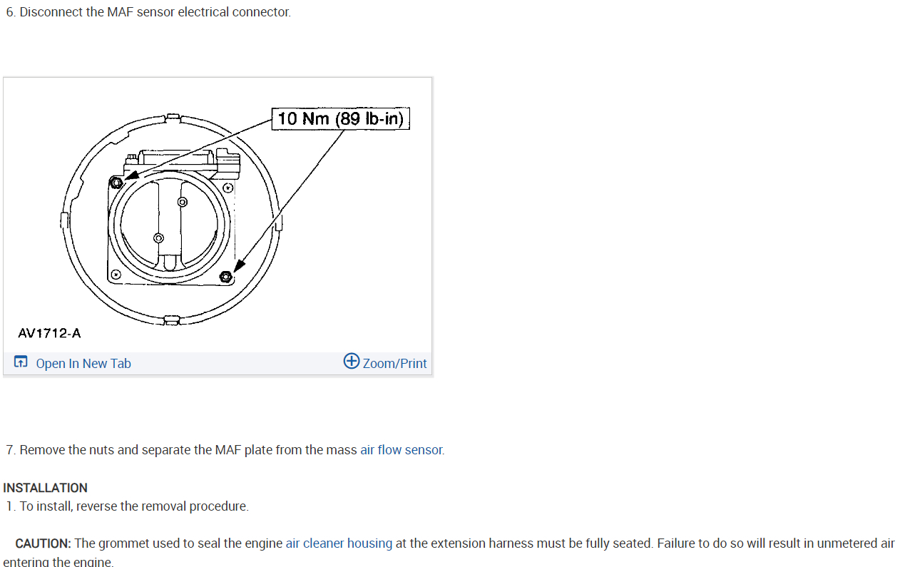

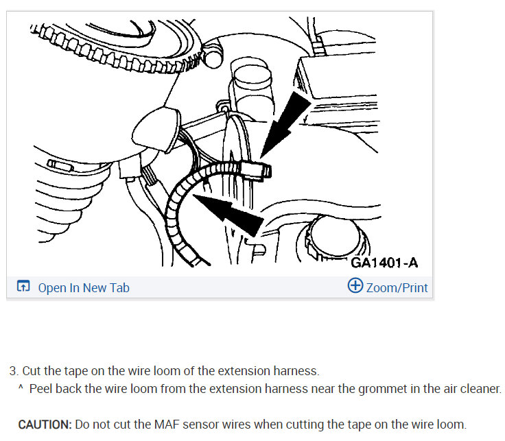

Clean or Replace the Mass Air Flow (MAF) Sensor: The K&N filter and intake system you mentioned can sometimes cause the MAF sensor to become dirty or contaminated. A dirty MAF sensor can affect the air/fuel mixture readings and trigger lean codes. Remove the MAF sensor and clean it using a MAF sensor cleaner. Be sure to follow the manufacturer's instructions. If cleaning doesn't resolve the issue, consider replacing the MAF sensor.

This guide
https://www.2carpros.com/articles/repair-lean-mixture-codes-p0171-or-p0174-on-some-manufacturers can help as well
Please go over these guides and get back to us.
