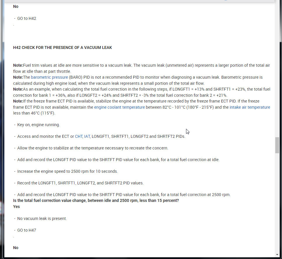

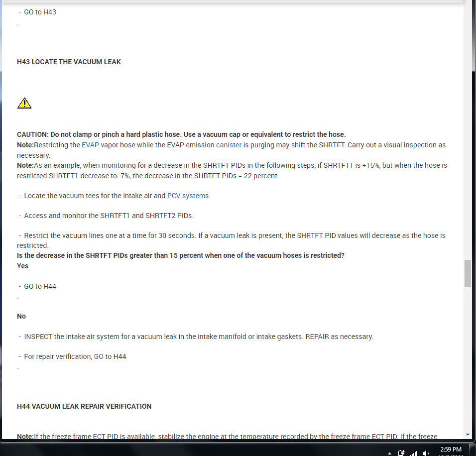

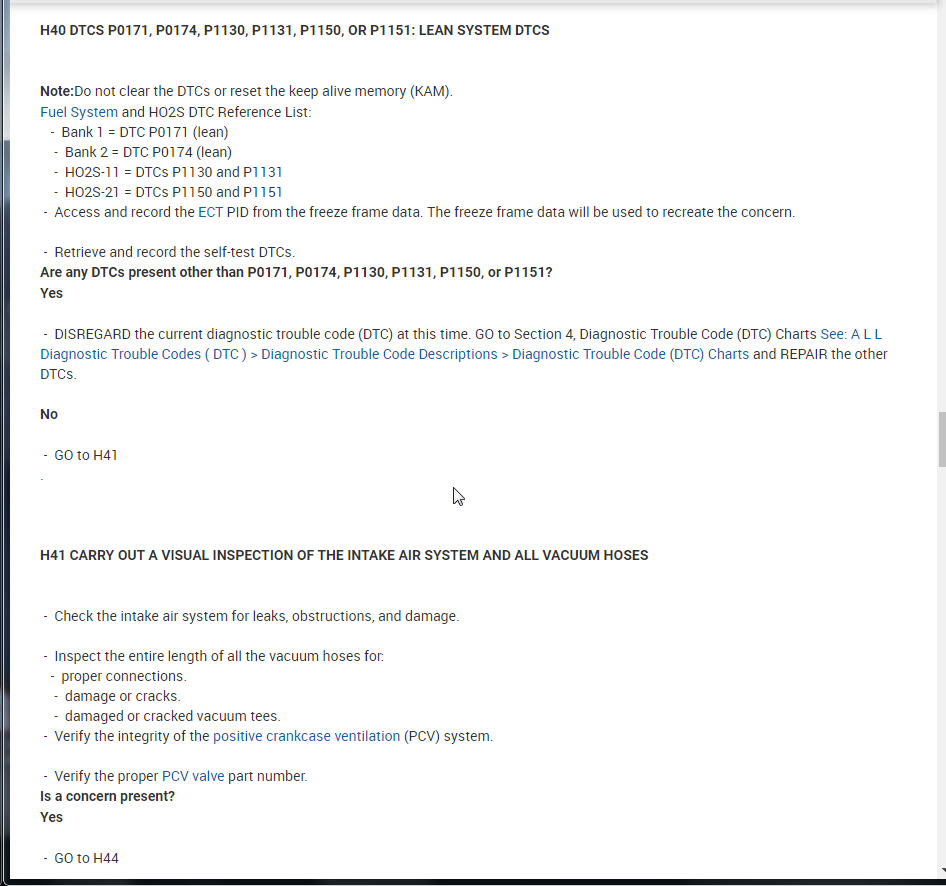

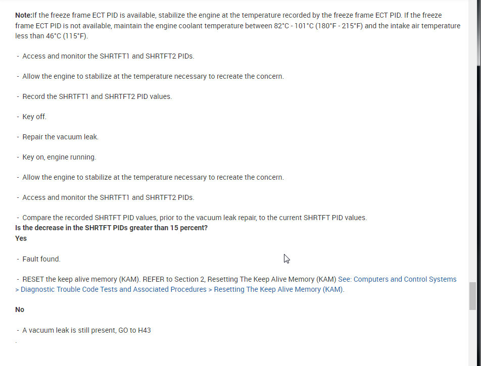

I am attaching all the info that you need for this. I would suggest starting with looking for a vacuum leak but I attached the testing that we need to do.
