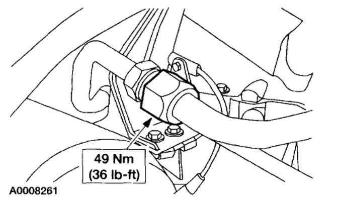

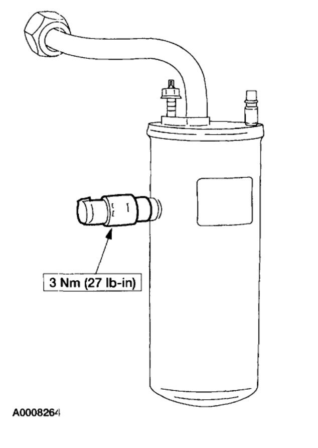

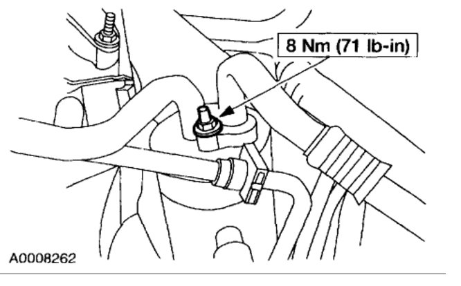

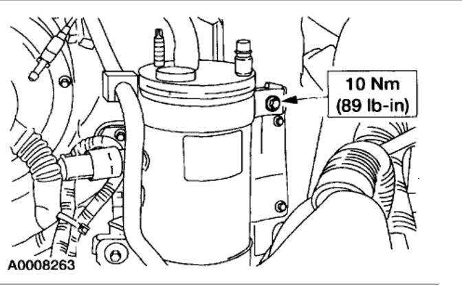

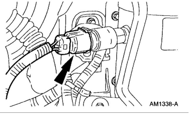

You will need to remove the Freon in the truck first here is a guide that will help you with that.
Here are some diagrams to show you how to remove the accumulator. It can take some persuading and sometime some wd40 and letting it sit.
