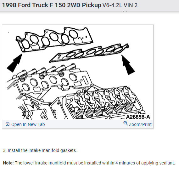

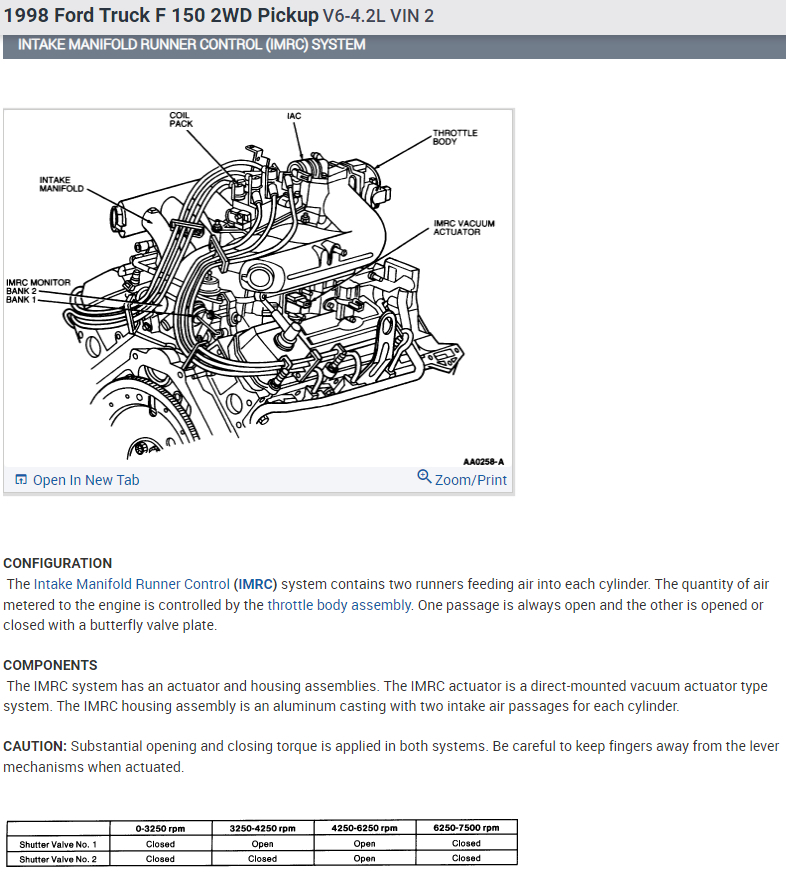

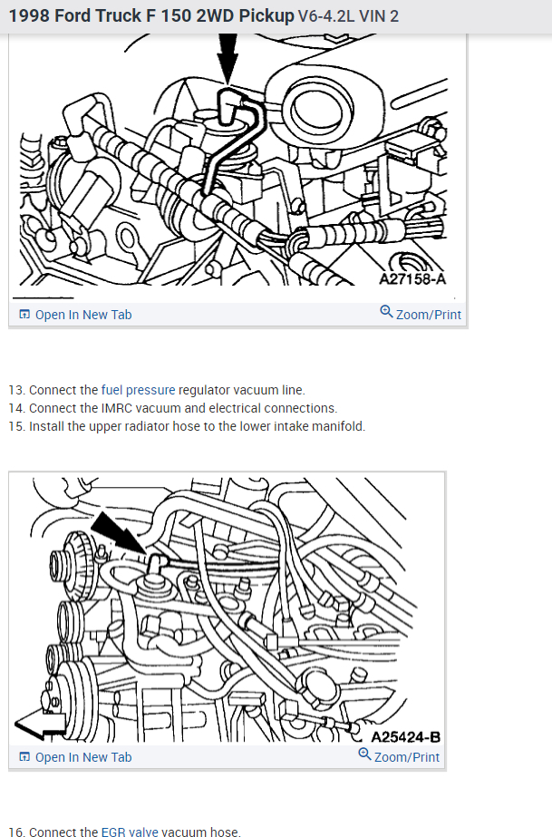

a mechanic friend scanned the trouble codes on my truck. the scanner said the runner control on bank #1 was stuck. the truck runs rough and the check engine light is on. Do I have to pull the manifold to repair this
or is there some thing I can do with it together?
Thanks
