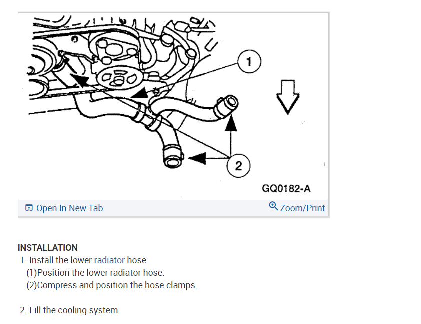

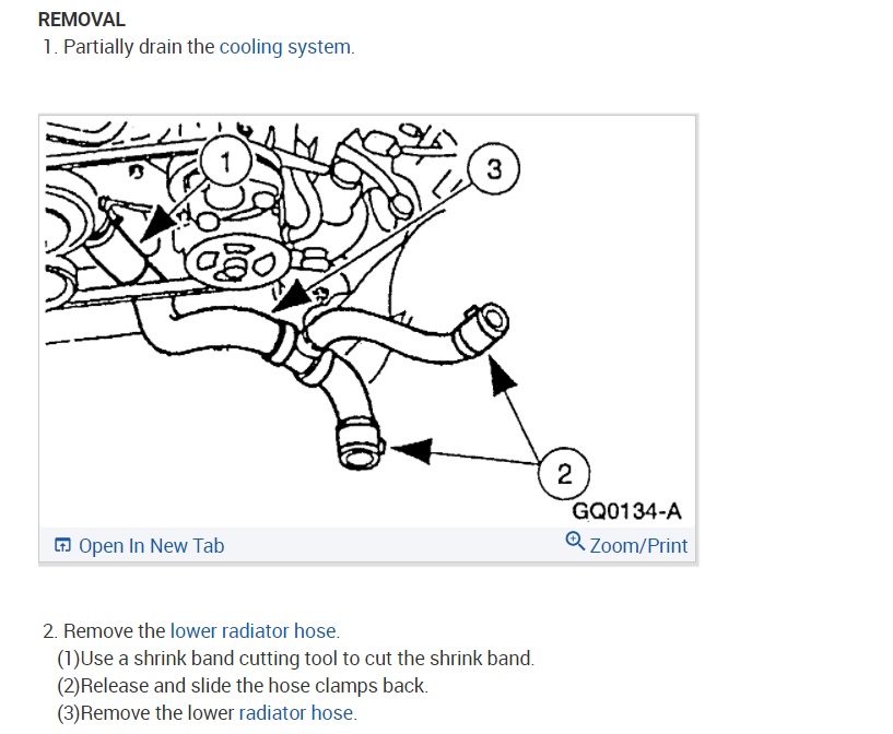

I attached the procedure for you for the hose replacement.
https://www.2carpros.com/articles/replace-radiator-hoses
https://www.2carpros.com/articles/coolant-flush-and-refill-all-cars
