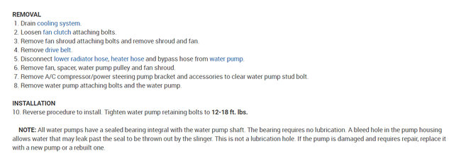

how do i remove the cooling fan so i can change the water pump? and any water pump directions you could provide will be greatly appreciated.

Hello, you will need a special tool for removing the fan....

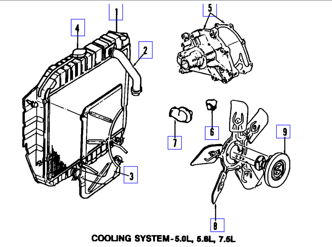

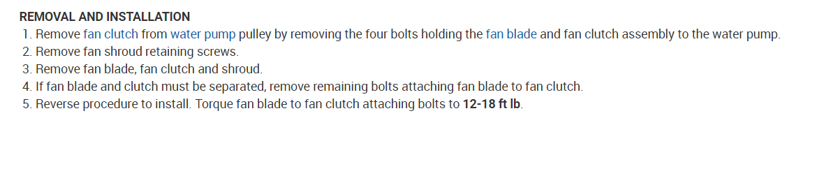

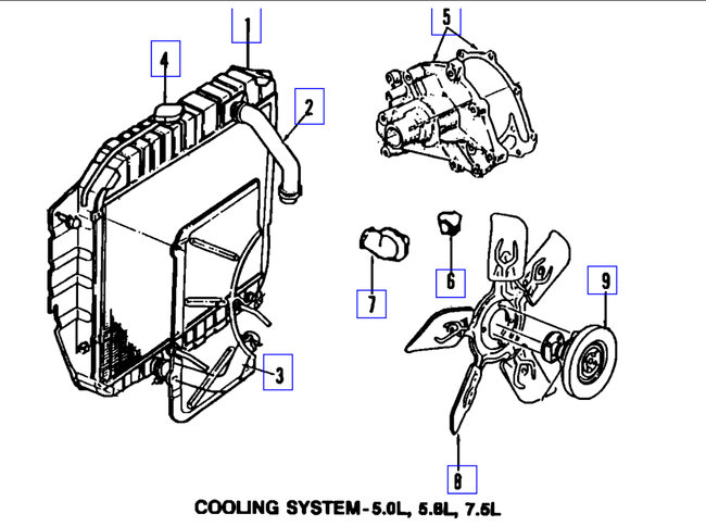

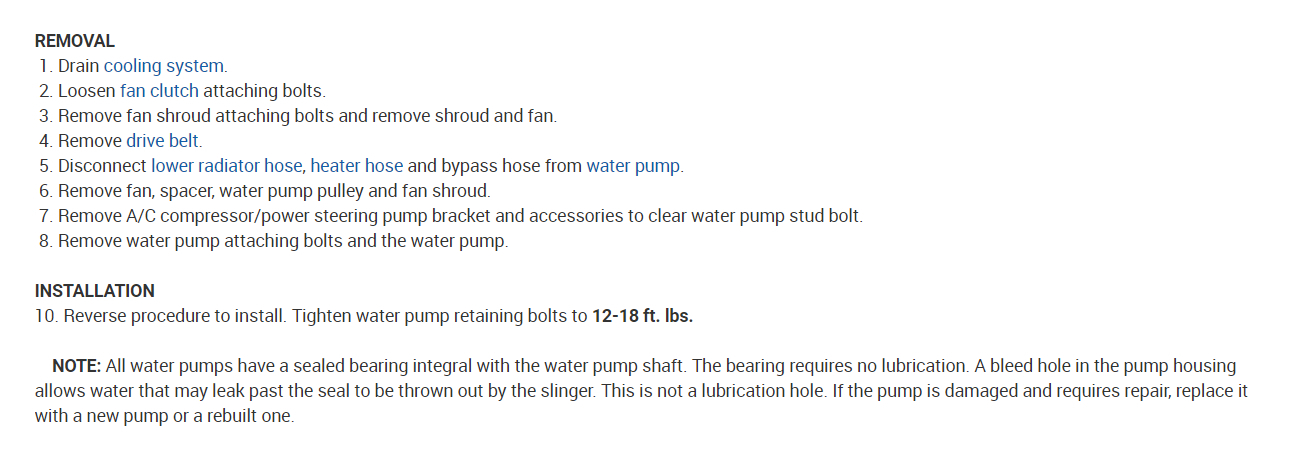

Good evening
I attached the procedure for removing the fan blade as well as the water pump replacement.
https://www.2carpros.com/articles/coolant-flush-and-refill-all-cars
https://www.2carpros.com/articles/water-pump-replacement
https://www.2carpros.com/articles/fan-clutch-removal
Let us know if you have any other questions.
