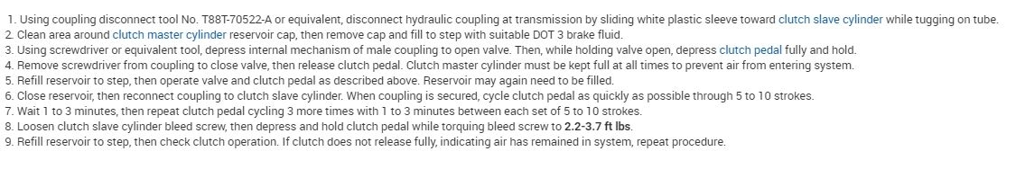

Looks like your truck doesn't have a bleed valve on the slave cylinder..
I have had a few that were stubborn, but you will feel the pedal start to get a little resistance as is forces the air out
Check out the diagram below, it has the bleed procedure for your truck.
