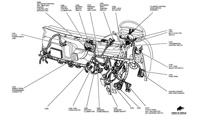

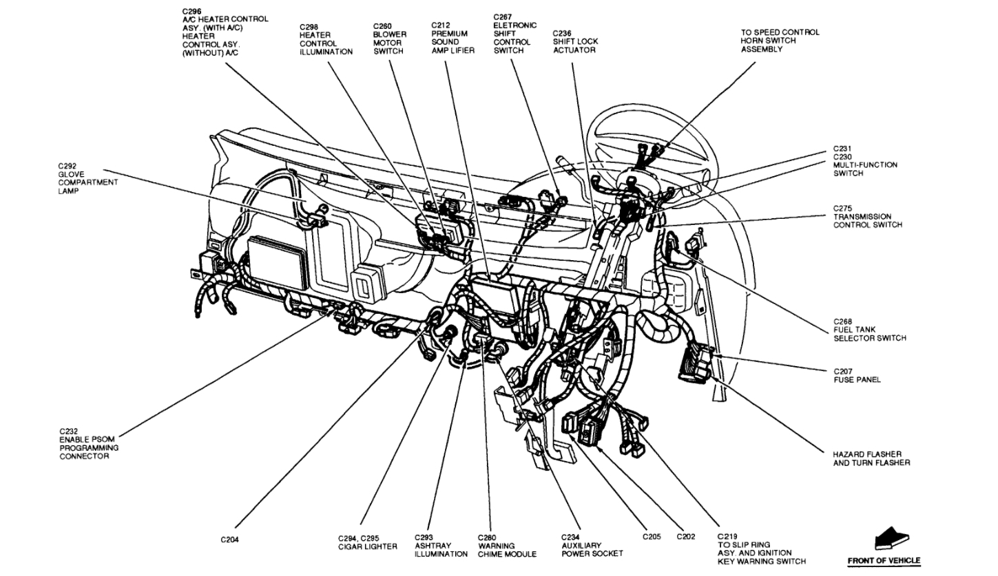

Where is the turn signal flasher located?
Feb 3, 2009 at 9:31 AM
BLUELIGHTNIN6
  • 16,542 POSTS
Both the turn signal flasher and the hazard warning flasher are mounted on the fuse panel. The turn signal flasher is mounted on the front of the fuse panel, and the hazard warning flasher is mounted on the rear of the fuse panel. Check out the diagrams (Below). Please let us know if you need anything else to get the problem fixed.
