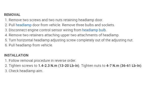

The headlight assembly can be replaced easily using simple hand tools.
To remove the headlight assembly, remove two screws and two nuts retaining the headlamp door.
Remove the bulbs and sockets.
Remove two retainers attaching upper two attachments of the headlight.
Turn horizontal headlight adjusting screw completely out of the adjusting nut.
Pull the headlight assembly from the vehicle.
