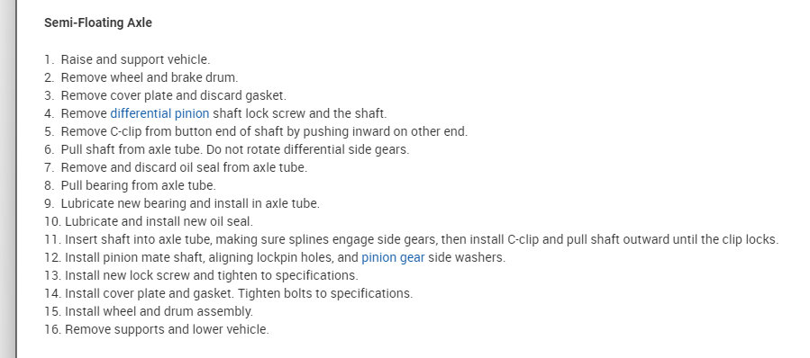

Please run through this and then see the info attached and let me know what questions you have. Thanks
