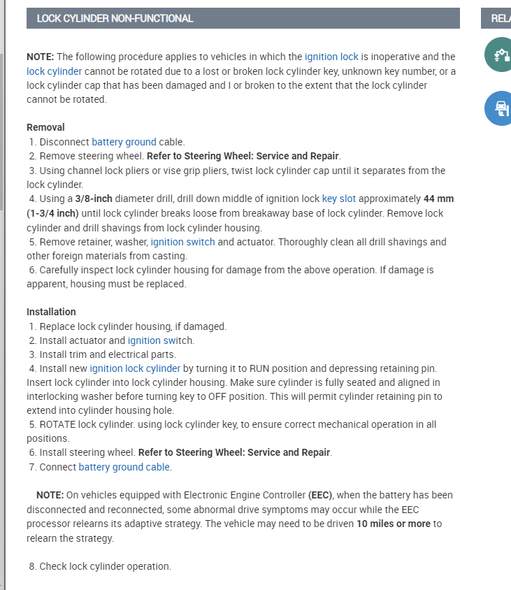

I Would Like To Know How To Replace My Steering Wheel And Also Remove The Engine Switch Where The Key Goes.

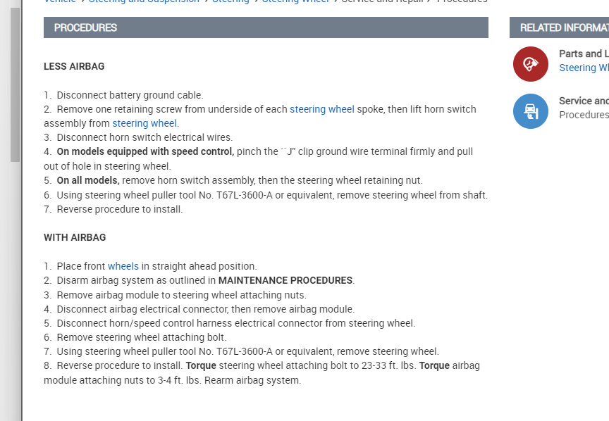

Sure. I will attach a guide on how to remove the steering wheel.
This will help with the steps on how to do this as the manual on this vehicle is not detailed at all.
https://www.2carpros.com/articles/steering-wheel-removal
As for replacing the ignition cylinder, I am attaching that process from the manual.
Please run through this and the steering wheel guide and process from the manual I attached below as well.
Let me know what other questions you have.
