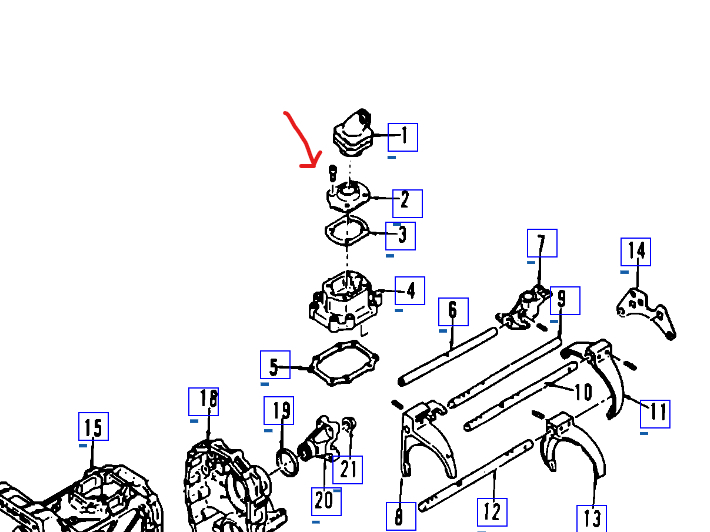

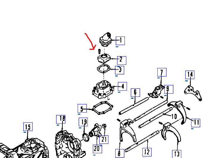

There are two different kinds, first you may need to push down and twist the collar counterclockwise to remove and clockwise to install like you say, here is how to install the shifter on the other possible transmission. Check out the images (below). Let us know if you need anything else.
