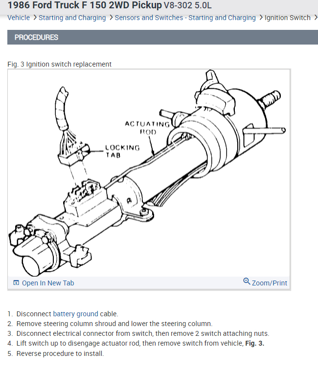

Key will not turn in the ignition switch (tried every which way, but to no avail). Switch was replaced at a shop a month ago and no problem until now. Presume I need to replace switch (rather not tow to a shop), but do not know the steps. Please help if you can.
Thanks.
Jul 31, 2008 at 9:17 PM
SQM
  • 6,383 POSTS

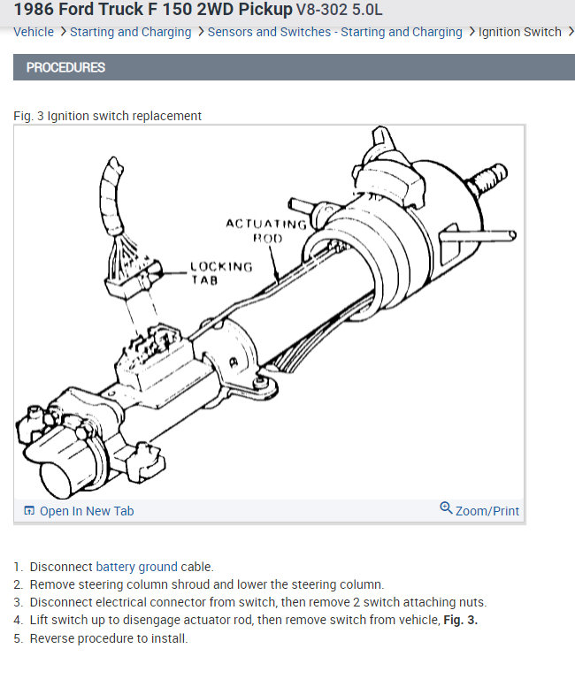

The part you put your key in called the lock cylinder. In order to replace the lock cylinder you will have to remove the steering wheel.
Here is a helpful guide of how to remove steering wheel:
https://www.2carpros.com/articles/steering-wheel-removal
Look below for the ignition switch replacement procedure.
