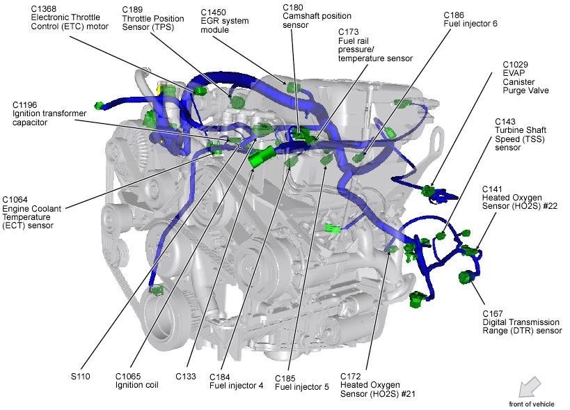

can you show me in picture which vacuum hose you mean?
can you show me in picture where is the MAP sensor in my vehicle?

what is the EGR module? can you explain to me with pictures? thank you
Jan 24, 2017 at 5:05 PM
CARADIODOC
  • 34,306 POSTS
Third from left on top.
Upon further searching, it appears this engine does not use a MAP sensor. That would explain why there is so much confusion concerning this fault code.
