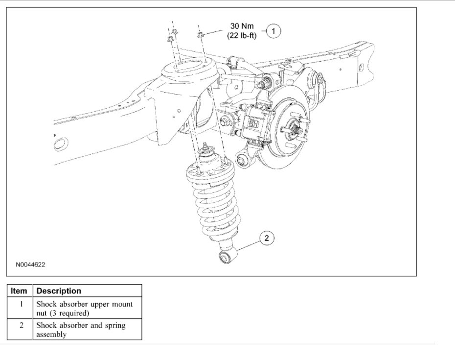

If I have the rear struts replaced, do I need to have the vehicle aligned afterward? One repair service has quoted me an additional $250 for 2 camber kits and an alignment while 2 others say I don't need an alignment. If an alignment MIGHT need to be done, what is the likelihood of this?
