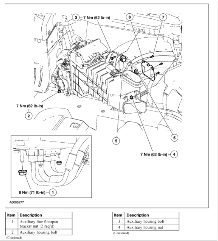

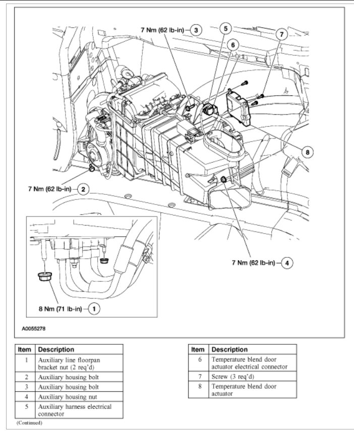

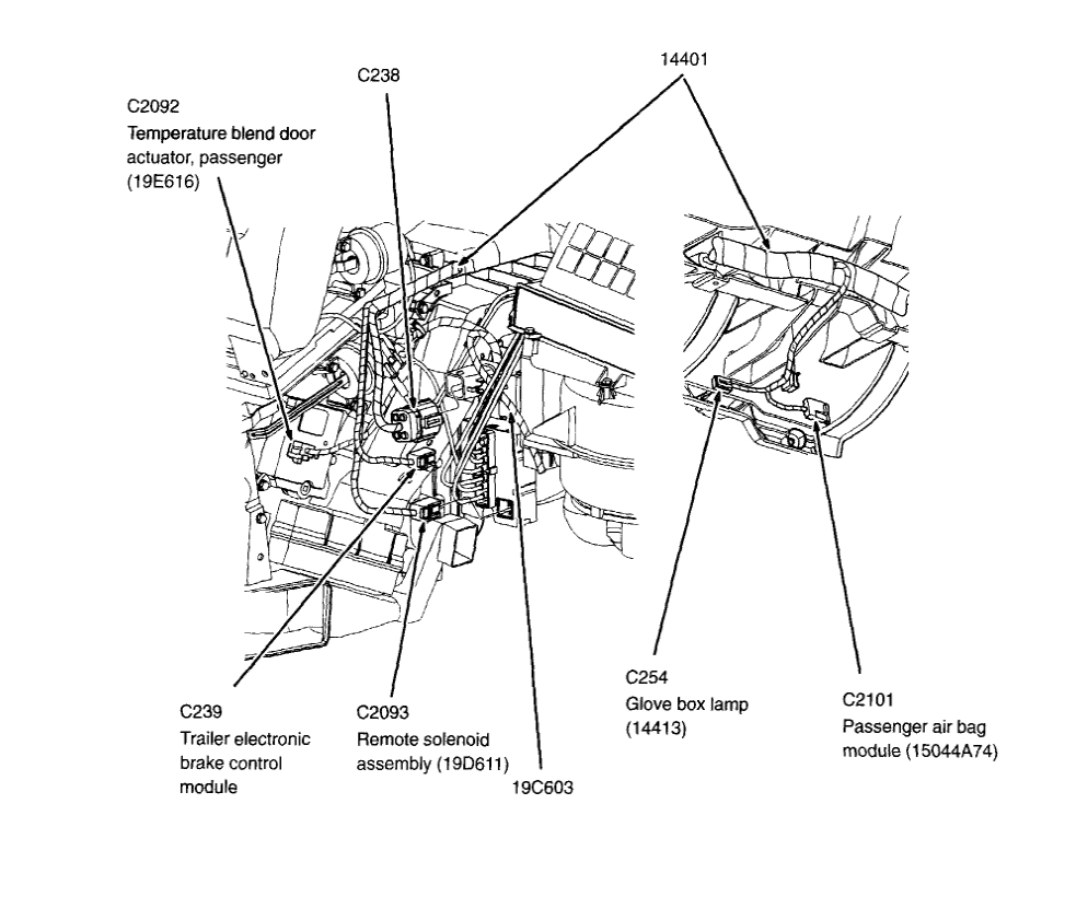

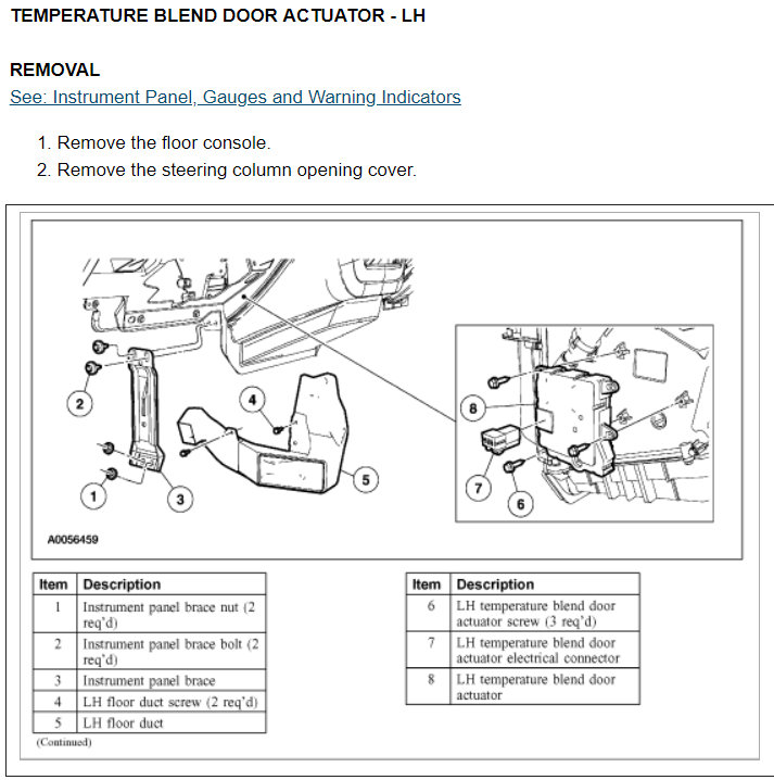

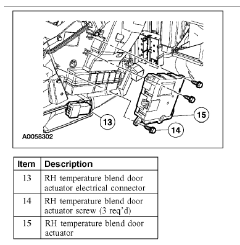

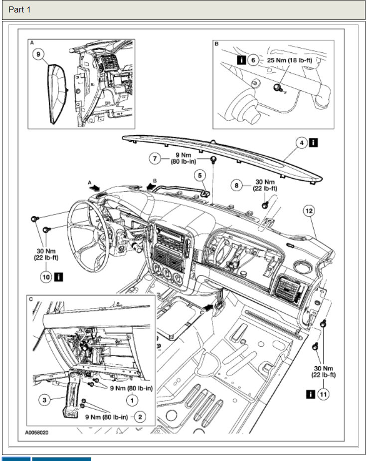

[quote:0505d58418="spoiledbratkg"]Heater problem
2004 Ford Explorer 6 cyl Four Wheel Drive Automatic 78000 miles
My heater is out in my explorer, the AC works fine and so does the blower. I hear a loud knocking noise anytime I move the dial to heater. I was told by a mechanic that the blendoor was broken. If I remove the radio, could I fix this part and reach it?[/quote:0505d58418]
