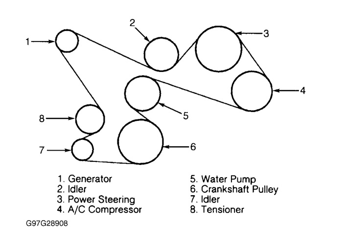

BMRFIXIT
  • 19,053 POSTS
Did you recheck the belt route ?
https://www.2carpros.com/forum/automotive_pictures/99387_Graphic_29.jpg
https://www.2carpros.com/forum/automotive_pictures/99387_Graphic1_12.jpg
Mar 27, 2020 at 12:10 PM (Merged)
TGRIFFITH
Thanks so much for posting the diagram!
The bearings went bad in my idler pulley, which resulted in it falling off, and the belt coming off.
Bought the new idler pulley for $15, and put the belt back on according to your diagram, and everythings back in order.
Thanks again!

ZEBRA13
I don't know how many belts are on this vehicle.My daughter is stuck uo at college at a gas stationwaiting for AAA .I would like a diagram of the belt system .Is it only neopreme?Thankyou for your help.George
OBXAUTOMEDIC
  • 3,711 POSTS
The is only one Belt (Surpentine Belt) and there should be a belt routing diagram in the engine compartment. It is usaully on the fan shroud.
But here it is....
https://www.2carpros.com/diagrams
