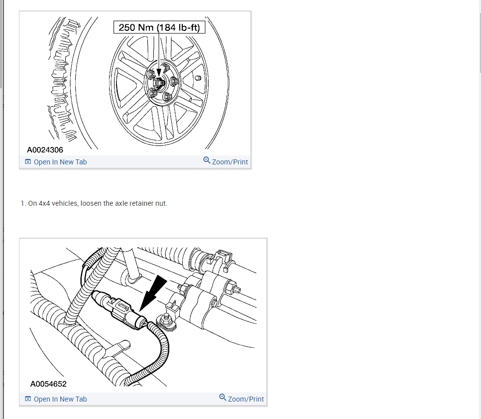

This is most likely a wheel bearing. I am attaching the info on this but here is a guide that will help with this issue:
https://www.2carpros.com/articles/car-howling-noise
https://www.2carpros.com/articles/whirring-sound

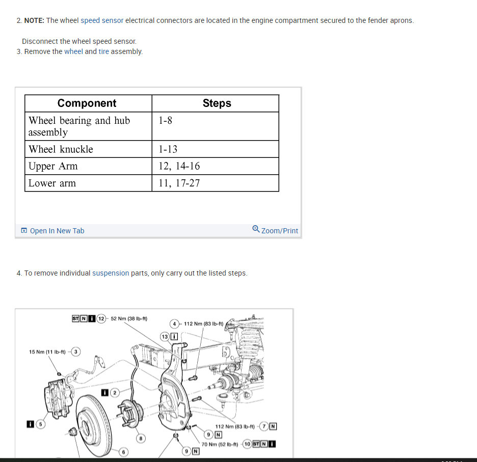

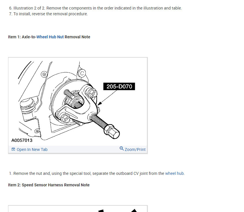

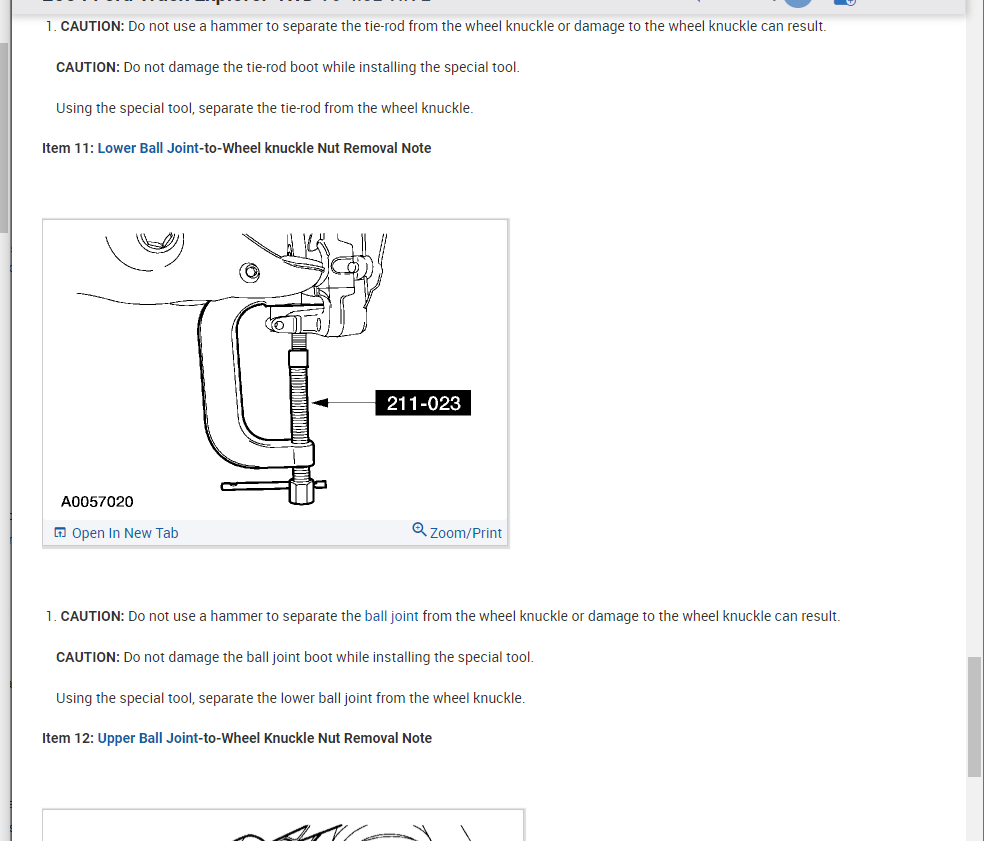

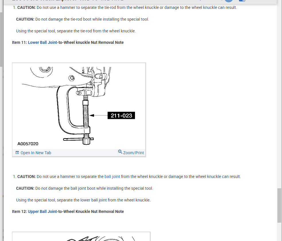

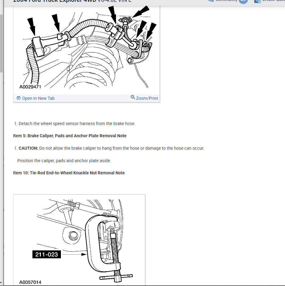

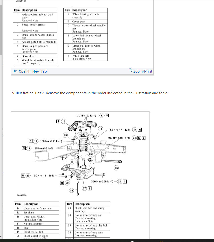

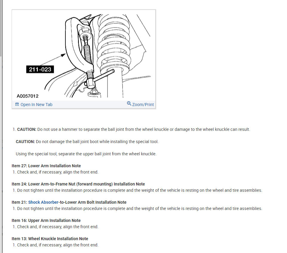

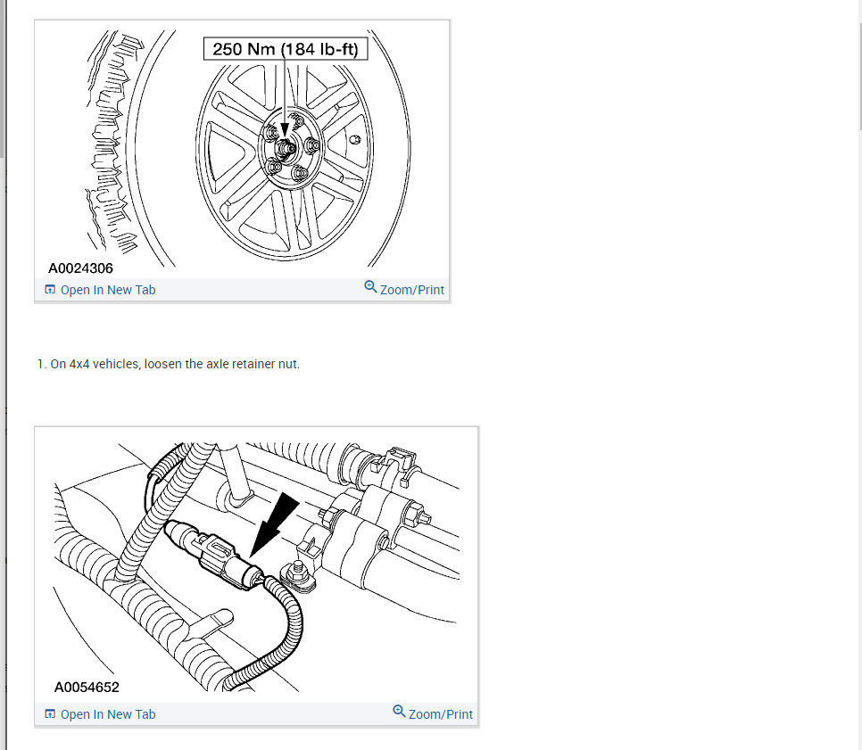

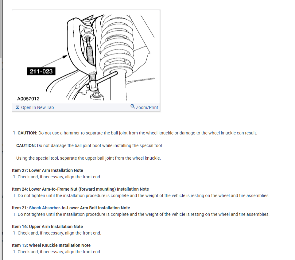

I suspect you are going to have to replace the bearings so here is the info from the manual on how to replace these bearings:
https://www.2carpros.com/articles/bearing-hub-replacement
Please run through this info and let us know if you have questions on this. Thanks
